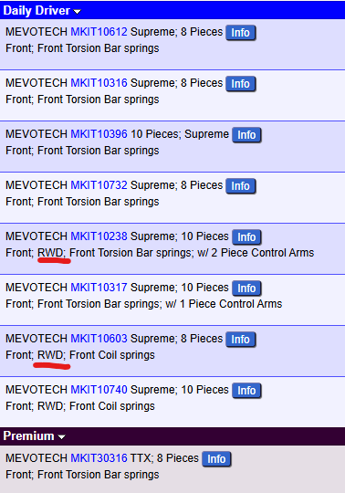

My next step in updates is the suspension. The ball joints are really bad and need to go, but I'm motivated to just replace everything while I'm down there. Here are the parts I am currently looking at:
Here are my questions for this project so far:
1. All the front end kits on RockAuto that include a complete lower control arm are listed as RWD. The ones with no RWD tag just have the lower ball joint only. Is there any reason for this? Can I just replace the entire lower control arm assembly entirely, or is something different about the 4x4 model? Do 4x4 lower control arms need to be purchases separately for these kits?

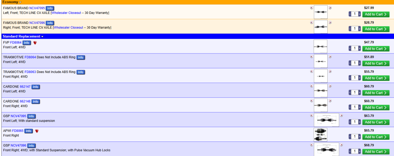

2. I also want to replace my CV Axles+Joints entirely. RockAuto sells a few different brands of what looks like the entire assembly. Does anyone have experience with any of these brands? Is there a consensus on what is good and what to avoid? Again, I plan to use this for some moderate offroading so I would like to invest in something of decent quality.

Thanks, I appreciate your response. The CV axles aren't making any noise so they're probably okay for now. Is there anything I can do to extend their life/clean/service them? Is rebooting them a good idea?

I have no experience with mevotech, but allegedly their TTX parts are a step above their supreme line. I've heard that the style boots that the TTX have hold up better than the traditional accordion boots like on the supreme, andtorn boots is a major killer of these parts, by letting water in and washing grease out.
Bilsteins are good.
I'd worry less about getting a kit, and more about selecting what seem to be the best quality parts. Whether that mean in kit from all from one manufacturer, or individual parts from several.
Your questions:
1) The difference between RWD kits and 4wd kits is largely due to the difference in suspension styles. Due to the torsion bar passing through the lower control arm on a 4wd, there is a fair bit more work to change those arms. Most people opt to just replace the joint instead of the entire arm, so the kits only include the joint. If you want to replace the entire arm to get new bushings, order individual components instead off the kit and get complete arms.
2) Don't replace CV axles. My 99 made it to around 210k on stock CVs and they were still fine. I replaced them because I was converting to live axle (01+ style) to go with the V8 AWD swap. Because the 98-00 had part time front axle (hubs that disengaged) the cv shafts did not turn unless the truck was in 4wd. They have a lot less miles of wear and tear than the rest of the truck or suspension components. Leave the originals there until they become a problem.
