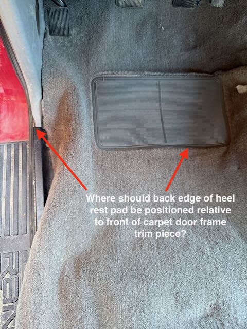

Hi everyone. I have a 1998 Ranger XLT 4.0 5 speed manual SuperCab. A previous owner removed the carpet for some reason and I bought new carpet from Stock Interiors.
Since I don't have the original carpet to use as a template and the carpet is larger than actually needed - and noted by Stock Interiors, it's unclear where I should position the carpet and I could really use your help.
It makes sense to start at the front and then work it towards the back and I think using the heel rest pad position as a common reference point also makes sense.
Relative to the driver's door frame, where does the back edge of the heel rest line up on your Ranger (see picture)? Maybe the plastic trim piece that secures the carpet along the door opening is a better reference point?
Also, how are the front and rear ends of the carpet secured? I was thinking some double stick tape, but is there something better?
If you have replaced the carpet in your Ranger, any helpful tips?
Thanks for any help you can provide

Is the carpet molded?
typically, will use the center hump for alignment, but it's always a bit of a "just roll with it" kind of deal.
for the heel pad, place your seat in the truck, and get in.
it will become pretty obvious where you'll want to place it under your feet.
Note: lay the carpet out in direct sunlight for a few hours.
when it heats up, it will get soft, and is much easier to lay down.
then when it cools, it will retain the new shape, with no wrinkles, or bubbles.
Also, make sure to remove the door sills and kick panels.
will be easier to trim the carpet, so it tucks up nicely underneath them.

Thanks @PoodlePuncher. I was hoping someone might have a picture of the driver’s footwell area, but I haven’t found one yet that shows the relationship of the heel pad to the door frame, but I’ll keep looking for one.
I don’t want to cut the carpet without knowing I have it in the correct position because I can’t un-cut it. Without a template, it’s pretty tough to figure it out.

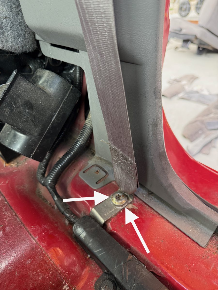

Hi again everyone. I've made some progress on getting new carpet installed on my 1998 Ford Ranger XLT Supercab 2 door, but I could use your help if you own a 1998+ Ford Ranger Supercab 2 door model.
There is a bolt anchoring the bottom of the driver and passenger side seat belt to the floor. However, not having the original carpet as a template, It's not clear to me if I should remove the bolt and lay the carpet down and then put the bolt back in through the carpet.
Please check out the attached photo for reference and I would greatly appreciate it if you could please post a photo of your seatbelt anchor.
