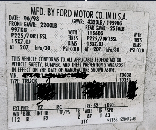

1998 2.5 2WD XLT STD Cab 130k miles
Have driven this lil'capo since 69k miles. Pulled the axle plug out and found still very clean oil. Question is should I still change it considering the miles & age?
In the past while cursory browsing had seen something about an updated Ford bulletin that called for 75W140 synthetic on some older Ford autos. Can somebody confirm that that is good on the this truck?
Found a $9.89 deal at Tractor Supply here.
