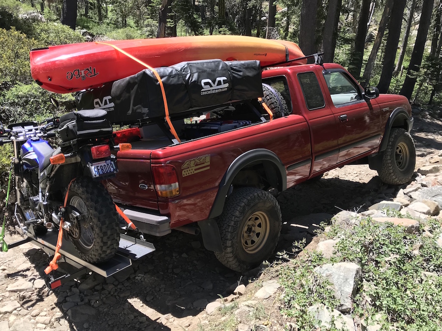

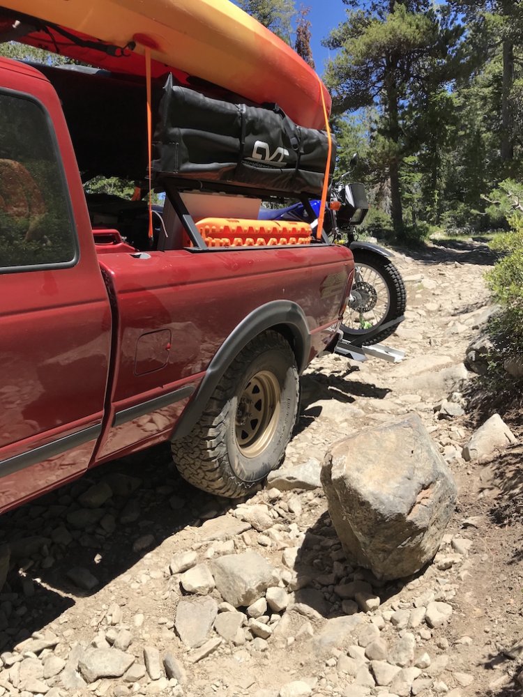

I finally got the truck out on some trails and a camping trip, took everything with me, kayak and the motorcycle! Everything did well, except i had to use 4x4 low to get up the steep hills, i really need to get gears! But for now ill just get by with low. We did 4 days/3 nights covered probably about 350-400 miles total, that is with 95% pavement but some really good trails up to a fire lookout at 8600 ft and we drove to the VERY TOP. I do have what i belive to be a driver side front axle ujoint that clicks when turning or a weight shift from front to rear and rear to front, so i have to look into that, but i dont think its detrimental right now since its brand new. Another thing ive noticed is my front hubs get really hot, pretty quickly, is this normal? I think its brake heat being transferred, I tested it after a long freway run with hardly any braking and they were only warm, but if i use the brakes much they get screaming hot.
Also I made a 90 degree hitch reciever for my motorcycle carrier so if i get into a situation where i cant or dont want the bike hanging way off the back i can put the carrier up flat against the tail gate and not have any departure angle issues or the bike bouncing out of the carrier, this proved very useful on the tough day i just parked the bike and took off in the truck and didnt have to leave the carrier behind. you can see in some pictures below but i did wheel in to camp with the bike on the back and i think it did fantastic, it only got a little scetchy in one spot so i decided for the way out to let me wife drive the truck while i rode the bike.

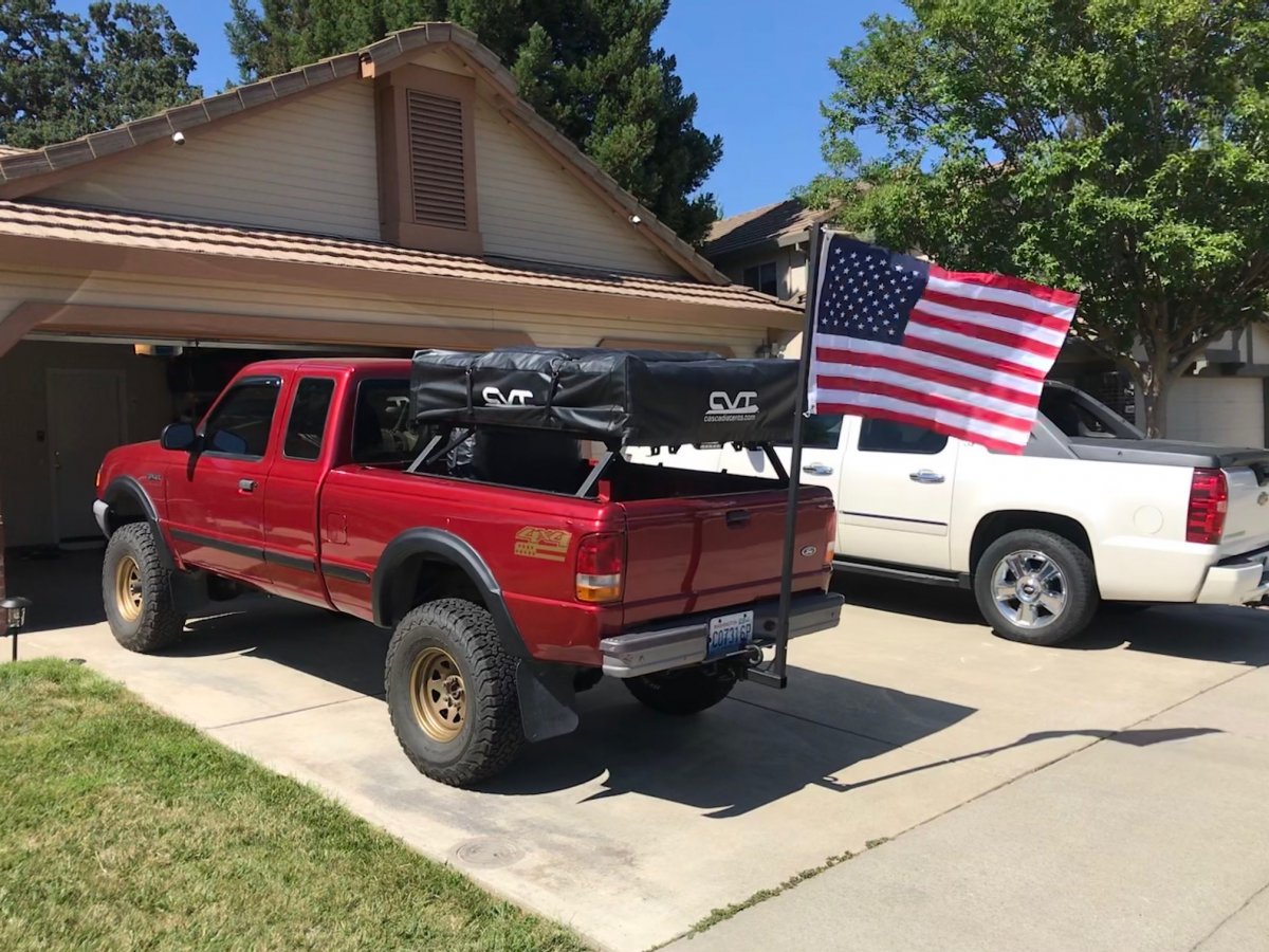

I forgot i made this hitch flag pole right before the 4th! It turned out great and was good welding practice before i buy the new ruffstuff DIY rock slider kit, and give it a go, ill feel much more comfortable wheeling harder with out the risk of permanently jamming a door closed, at $300 it seems like a great bargain, plus i live 30 mins away so i can skip the shipping cost.
