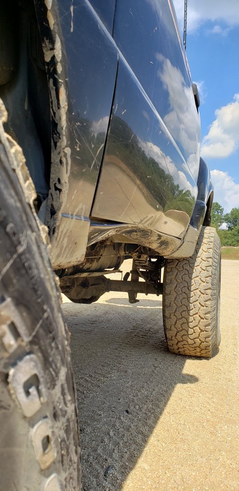

1997 ranger trail truck build! UPDATED She got rolled and I bought it back for $231
ill feel much more comfortable wheeling harder with out the risk of permanently jamming a door closed,
What you talking bout, Willis?
Been there, done that. It got the bottom of my door too.

does that door open at all? Or do you just NASCAR It through the window?
The door opened and closed fine. I got lucky. I have pulled most of that bend out of it.
Rocks are tricky. They randomly jump up out of the dirt and attack your truck right at the exact time that you cringe and think "oh no. This is gonna hurt."

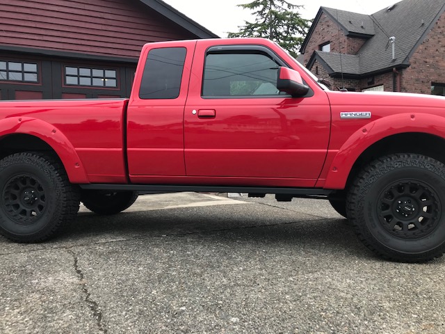

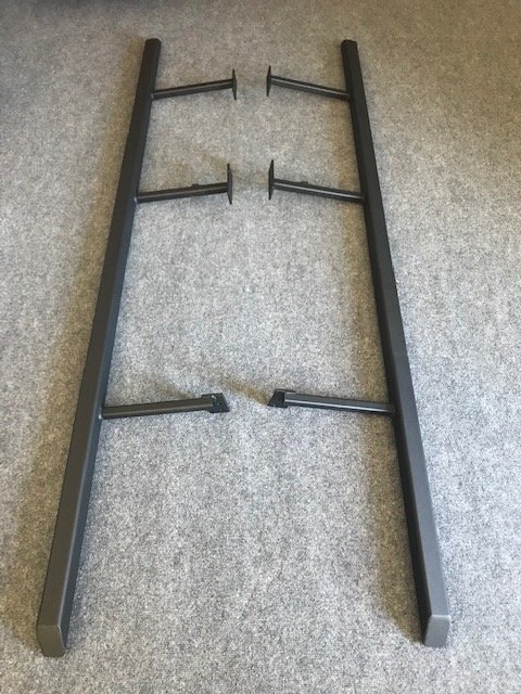

Those Ruff Stuff sliders look good, and that's a great price. . . Went a different route for mine from "Rocky Road Outfitters", but twice the price (plus shipping!).

ERICBPHOTO- im sure ill learn much more about those jumping rocks soon lol. i cannot belive that door still works, it looks like it was a HARD hit!
