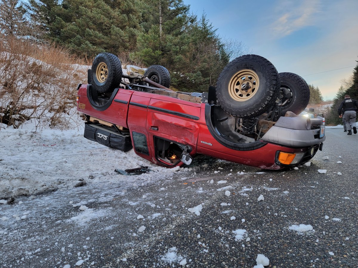

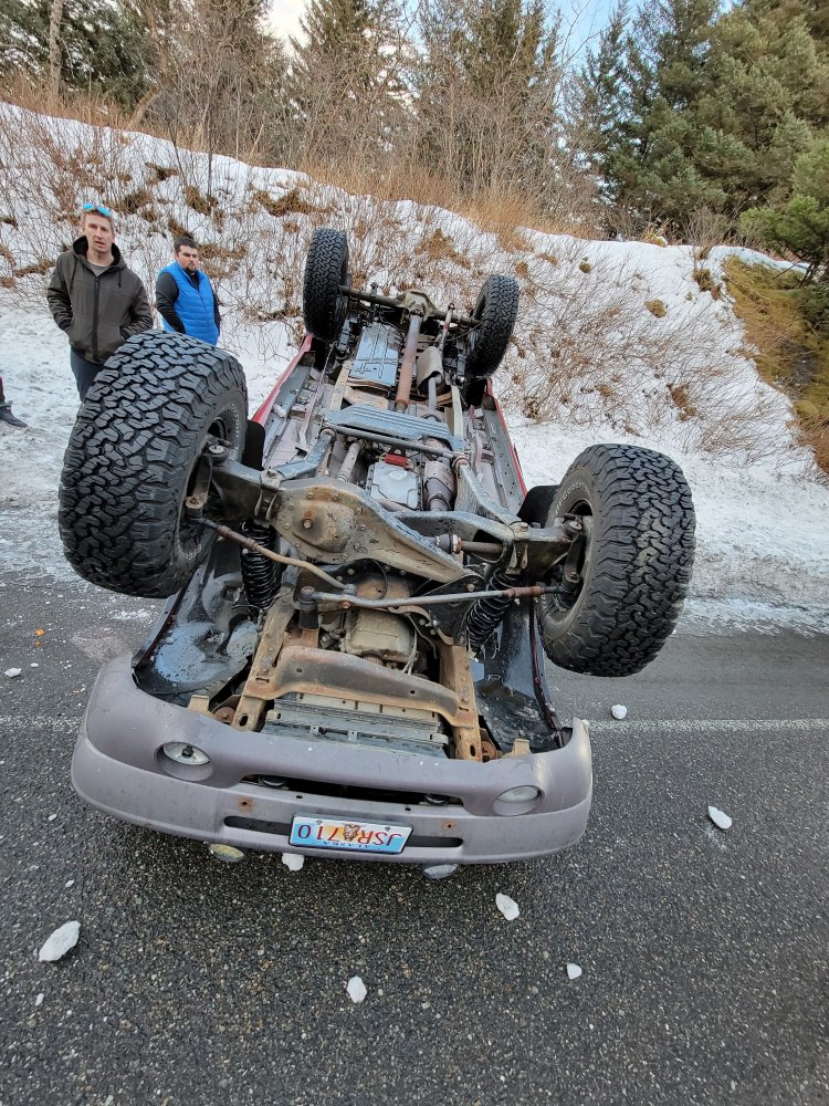

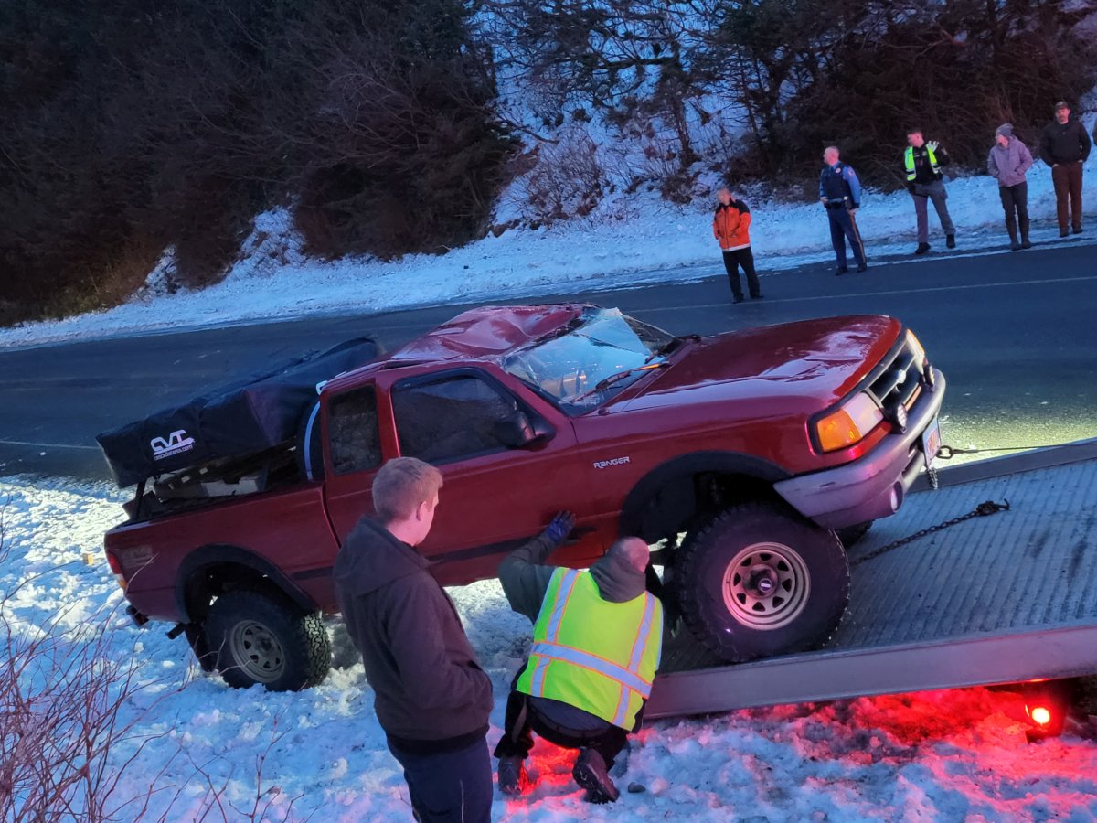

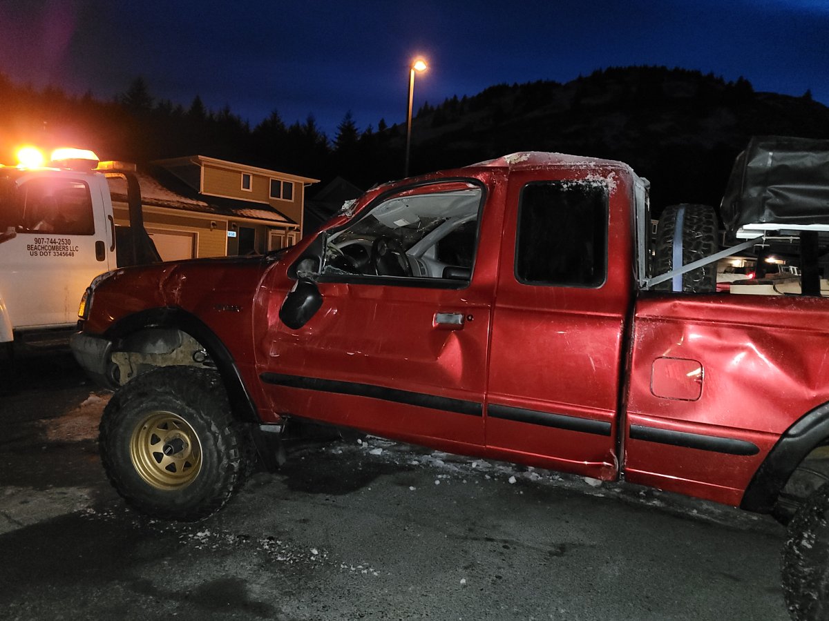

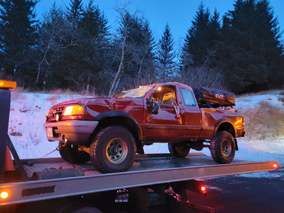

Well its with a heavy heart I have to say that I rolled my ranger up here in Alaska, I came around a corner on some black ice, got spun backwards and then had a fairly slow roll over and ended up on the roof. I'm broken hearted after all the work I put into it, insurance classified it as a "total loss" but like most of us on here would, I BOUGHT IT BACK!!! Insurance said it was only worth $ 231 in scrap so it was a no brainer. It was upside down for about 45 mins, my buddies and I tried to roll it back with their winches but the ice made it impossible, even the tow truck guys struggled for awhile. After being upside down for 45 mins the engine got hydro locked with oil after I tried to start it, so I pulled the plugs and pumped the oil out and it fired right up, albeit, smoking like a banshee!
The bad news is it needs a whole new cab and I'm in Kodiak, a small town on an island south of the mainland so options are very limited, the junk yard had no good donors and I'm still searching out on some options but the couple I did find are very rusty. so for now I'm not sure what I'm going to do. But the truck is still mine and now since its mainly a toy and not a daily driver I can mess with it even more. With the insurance money I have to get my wife's spare vehicle shipped up here which will run about 2k and then most of the rest is going to go back to the ranger. After I get it drivable again ( with a new cab) i'm thinking about attempting to regear it myself to 4.88's add a rear locker (probably E locker) in addition the the front Aussie locker I already have in it and then going to some 35" mud tires for around here, also adding a front winch bumper, slider and maybe an EXO cage if I can find a good rust free cab. Nothing is in stone yet though, just a ton of brain storming.
So if it were you guys, building an off road toy that is still technically street legal, with the long term goal of taking it back to the lower 48 west coast what would you guys do if you had lets say $ 4,000 to put into your truck? I'm not going to SAS it, if I ever do a full build it will be on an SUV so I can wheel with kids someday. oh also I have access to a nice tubing bender and welders to that will make building things a bit easier.here are some pictures on the carnage, wish I had a cooler story for it.

First off... glad everyone is OK.
Secondly... for $231 you just had to buy it back.
I'd probably kick the windshield out... hammer me out some head room and go see what it will take. Absolutely no fear of body damage.

Glad you're ok. Looks like the tents ok too.
Uncle Gump, thank you for the concern, luckily it was me and a buddy and not my wife, and it was a slow rollover. I will try to straighten the cab up as best I can, I'm really not touching it too much until insurance pays me, but ill see what the hammer and maybe a jack and some wood blocks can yield me for fixing the roof. I've put out a wanted add for a parts truck but well see what happens its not too big of a town but there are a few rangers here.
If it was me? I'd cut the top of the cab off and replace it with a donor. Those rust buckets up there....what do the tops look like?
I like the way you think, this seems like an absolute possibility, I actually floated the idea to some buddies here about that since I can find doors and a decent roof fairly easy plus my little 110 welder will work about perfect for that. The hard part will be getting it good enough to make a new windshield fit. I saw on your thread that you actually did the same thing to an older ranger, so if that's what I have to do I may hit you up for some tips and lessons learned. almost every truck here is freaking rusted to bits. plus a roof swap will make the whole matching VIN thing a non issue, even though I doubt anyone here would even check, but if I go back to the lower 48 it could possibly come up.

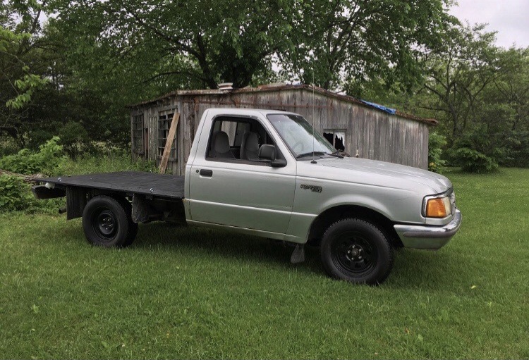

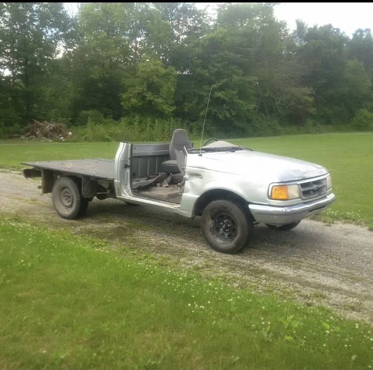

Get out your sawzall, make a “ranger roadster”. I rolled this ‘97 reg cab 3.0 auto 2wd longbed. Drove it this way a few times. No 1st in transmission but would do awesome burnouts- with 3.45’s even!
