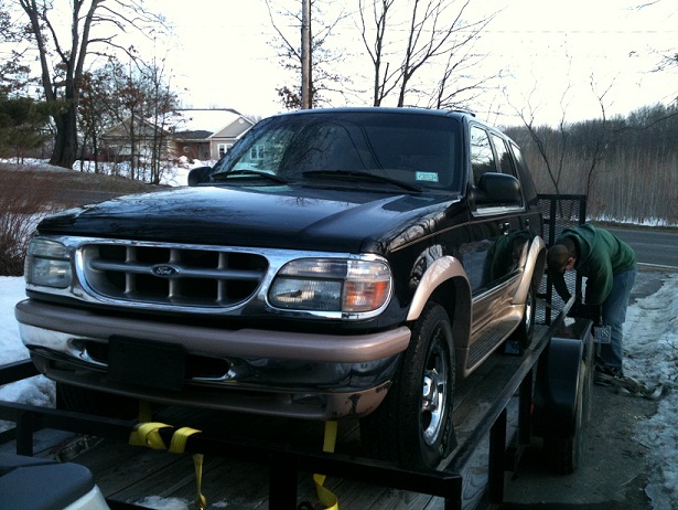

Okay guys, so i just bought this truck for 700 bucks in hopes of fixing it up and making a profit on it or maybe just keeping it for myself (its alot nicer then my 1994ranger haha). I was hoping to get some advice on the known problems before i dig into it too much. Its got a slow coolant leak coming from somewhere near the firewall thats dripping down onto the transmission. Any ideas? heater core maybe? Hopefully not a head or cracked block. The other issue is the speedomter and odometer both dont work, the guy i bought it from said the truck has about 124,000 on it but the odometer stopped at around 99,000. Im pretty sure these are electronic and have the speed sensor on the transmission but would that effect the odometer as well? The guy I bought it from also said the transmission was rebuilt at 60,000 miles. possible culprit of speedo problem? Any advice on either of these two problems would be greatly appreciated. Other then that the truck is awesome, runs and drives fine and is in really good shape cosmetically. Hopefully I can fix it!
