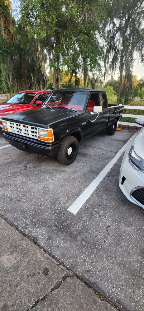

As the title says I'm swapping parts from a '96 Explorer w a 5.0 into my '91 Ranger 3.0 . Both automatic.
What power mods can I do to the 5.0?
I'm looking for a range of options low budget to mid budget. I've seen a lot about the exhaust and headers being a big factor, are there any headers that will work for this swap as well as add power or am I stuck with what I can get due to fitment?
What about a cam kit and tune?
I'd like to know what I can do/what would be worth doing while I have everything out and before it gets put into the Ranger.
I'm also going to take the 8.8 out of the Explorer for the Ranger. I can see myself going bug budget later on but for now just looking to see what's possible and what's realistically worth it.
Thank you

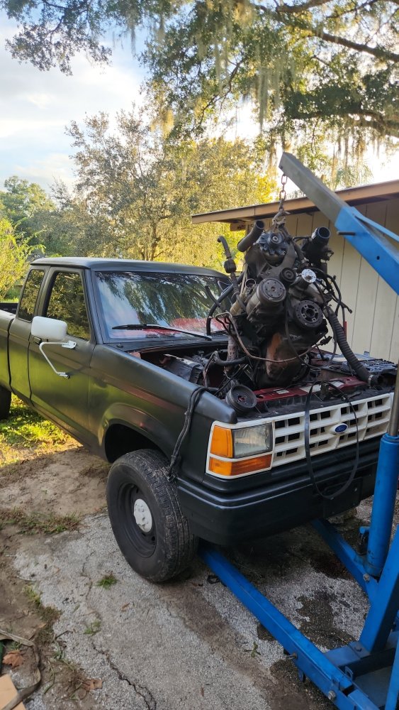

Update:
Engine And Trans pulled from the ranger. Going to clean the engine bay today.
I'm looking for advice on the swap using the donor explorer, I want to spend as little money as possible having the full donor truck at my disposal. I'm okay with buying motor mounts. I'm not looking to build anything crazy just yet just reliable. Specific questions listed and any advice appreciated.

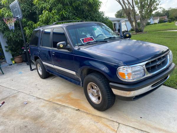

Can I use the a/c system from the exploder? A lot of the ac lines were cut in removing the engine from the ranger. And the core now has holes 🤷
I've seen that this year exploder has the headers that will fit, is this true? (1996)
We didn't remove the core support bc pain in the ass to do the front clip, am I able to put the 5.0 back in bolted up or do I have to disconnect it from the trans and do that separately?
Is the oil filter relocation kit a must or can I use a short filter can? Any disadvantages to either?
Will the fuel pump from the ranger work or do I need an aftermarket? Fuel pump on the exploder is shot
I need to take the computer from the exploder, correct? Advice on this topic as well as getting the stock ranger cluster and gages to work.
Sorry for the long read but if you're still here then thank you I appreciate any help that can be given
