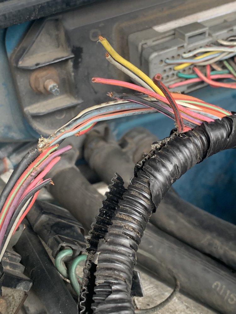

Replaced the two O2 sensors referenced. I still have all of the same codes after a week of driving. Checking wiring today. Any other advice is welcome.
If you can find a wiring diagram for your '95, I'd grab a volt meter and see if you're getting power on the appropriate wire for heating the upstream O2 sensors.
So I found the cause of all but one of my codes. Check out this pic of the harness. Apparently whoever swapped the engine back in 2001 did not disconnect this harness before yanking out the engine. There was no obvious damage to the wrapped wire loom so they just used it. After repairing this, The Speedo works, and all the o2 codes are gone!!!
