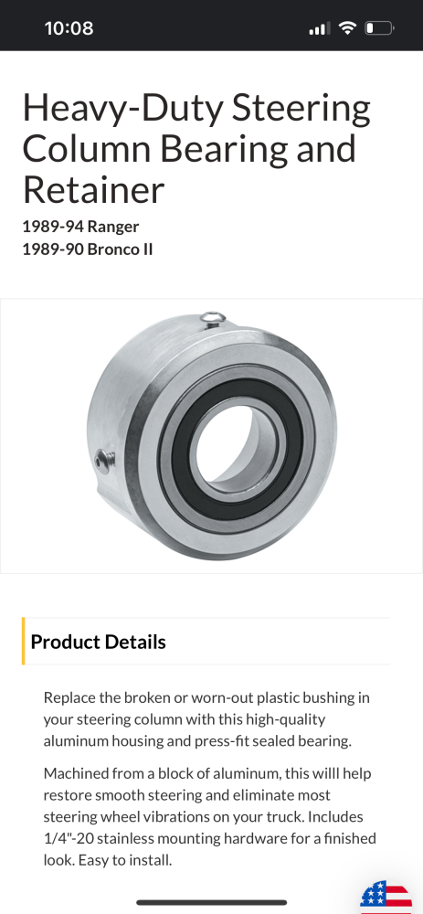

Now I have no play in the steering, but I still have a terrible chirping/squeaking sound coming from behind the wheel when I turn the wheel. I think it’s actually coming from the bearing/bushing that the steering column rides on. I found replacement/upgrade, but I’m trying to figure out how hard it is? How common it is? Or if there’s something else likely causing this.

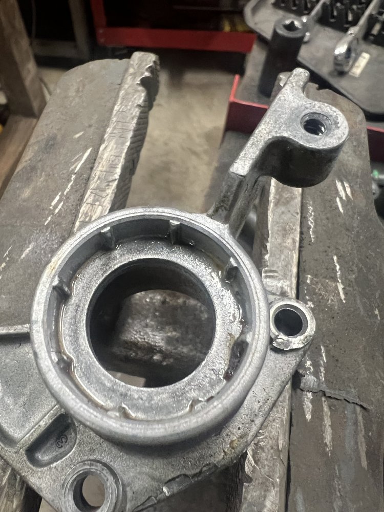

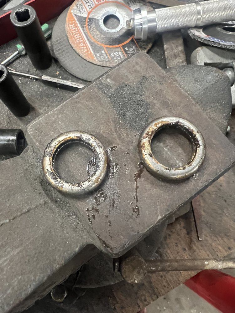

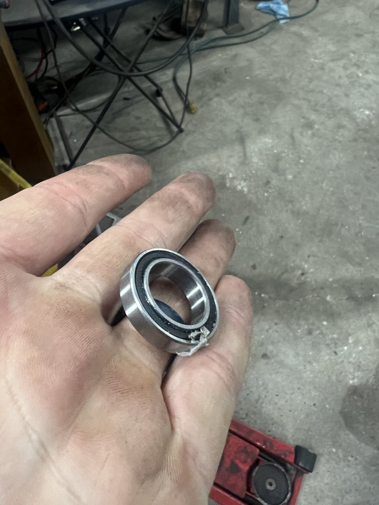

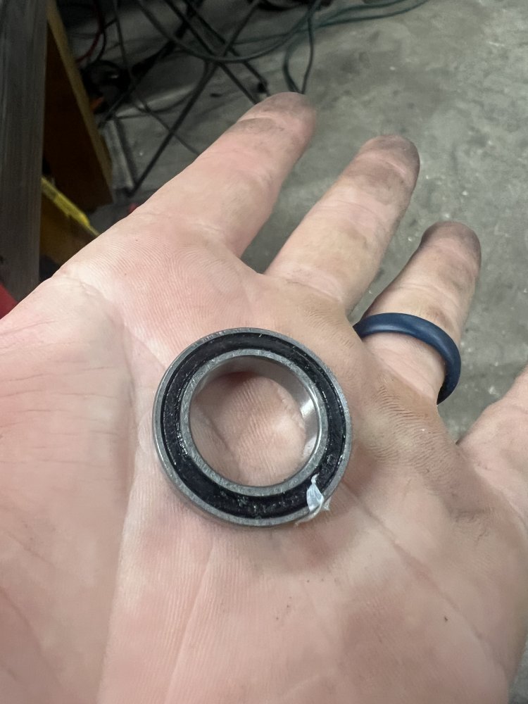

Finally got time to dig into this again. My new bearing from LMC truck arrived, I pulled the column apart and realized I was going to have to really work at getting these bearings out, as smacking them from the back side wasn’t working. Finally one popped out and hit the ground and I realized there’s two bearings not just one. Got them both out and clearly they have seen better days, probably is LMC truck only showed one and I only ordered one. No biggy the new one is considerably better built and the way this design works I’m sure one is sufficient for a short time.
So I through it back together with just one and it seems better, but not totally fixed. Maybe the single bearing is straining by itself, or maybe the stupid horn thing needs to be moved a tad for better alignment. Guess I’ll have to dig into it more when the new one comes home fully much faster than the first one.
