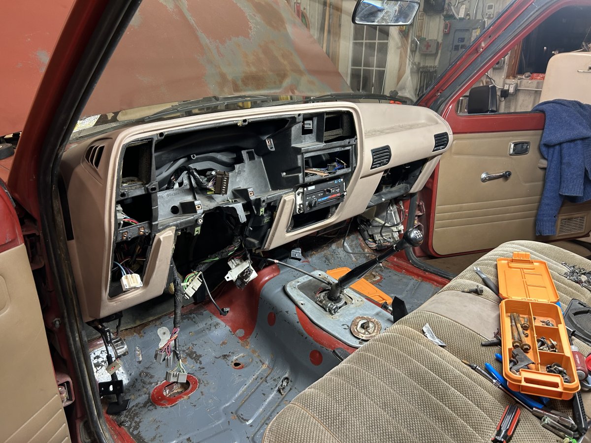

I'm hoping for a little guidance... My rig is a 1986 and I see plenty of articles on the 4.0 swap, I already have that in and have run fuel lines, new exhaust, etc. Now I'm working on wiring... I found the webpage on the dash swap (I thought that would be easier and look cleaner that splicing wires, etc). So, I went back to my donor and pulled the dash, and everything that goes with it. Today, I prepped the dash for going in and thought that I'd throw the steering in to make sure that fit... Nope. It's about ~5" too long, and runs into the firewall side of the brake booster. I'm not sure what I did wrong. I thought about trimming the end of the steering column but wont work since the 'crimped' end of the column that goes into the steering shaft is only 'crimped' about 3".
The webpage of the guy that did the dash swap said nothing about steering column issues, so why my interference. If I can shorten the steering shaft, then the brake booster is still in the way...
Anyone done this swap? Or know someone who has?
(I'm new to forums)

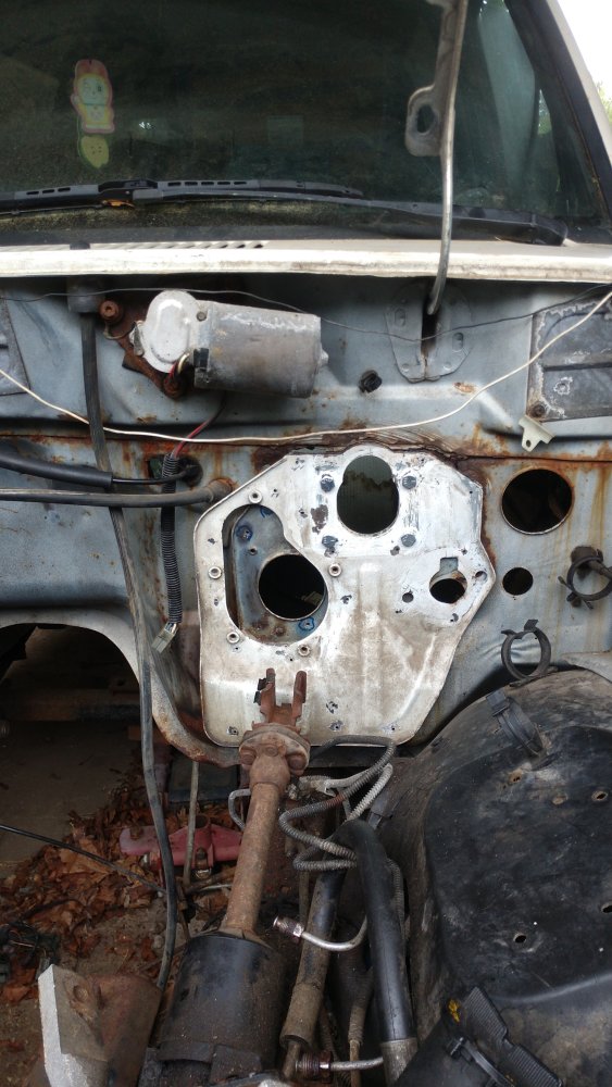

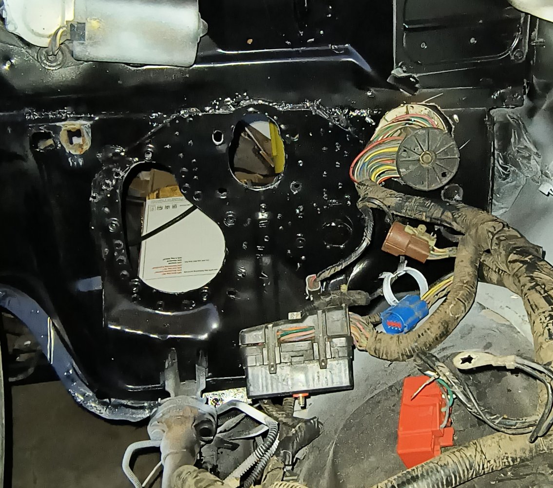

This pic is an early mock-up of the location for the Explorer's engine bay side column reinforcing plate. It was determined by where the column and it's firewall attaching bracket needed to be because of the locations of the gas pedal bracket and transmission tunnel.
In the pic the BII engine bay column reenforcement plate can be seen underneath. This isn't exactly where the final placement needed to be but it set me down the best path.
I wound up needing to use the BII gas pedal vs the Explorer's. The Explorer has a different top angle, it would have interfered with the Explorer column.

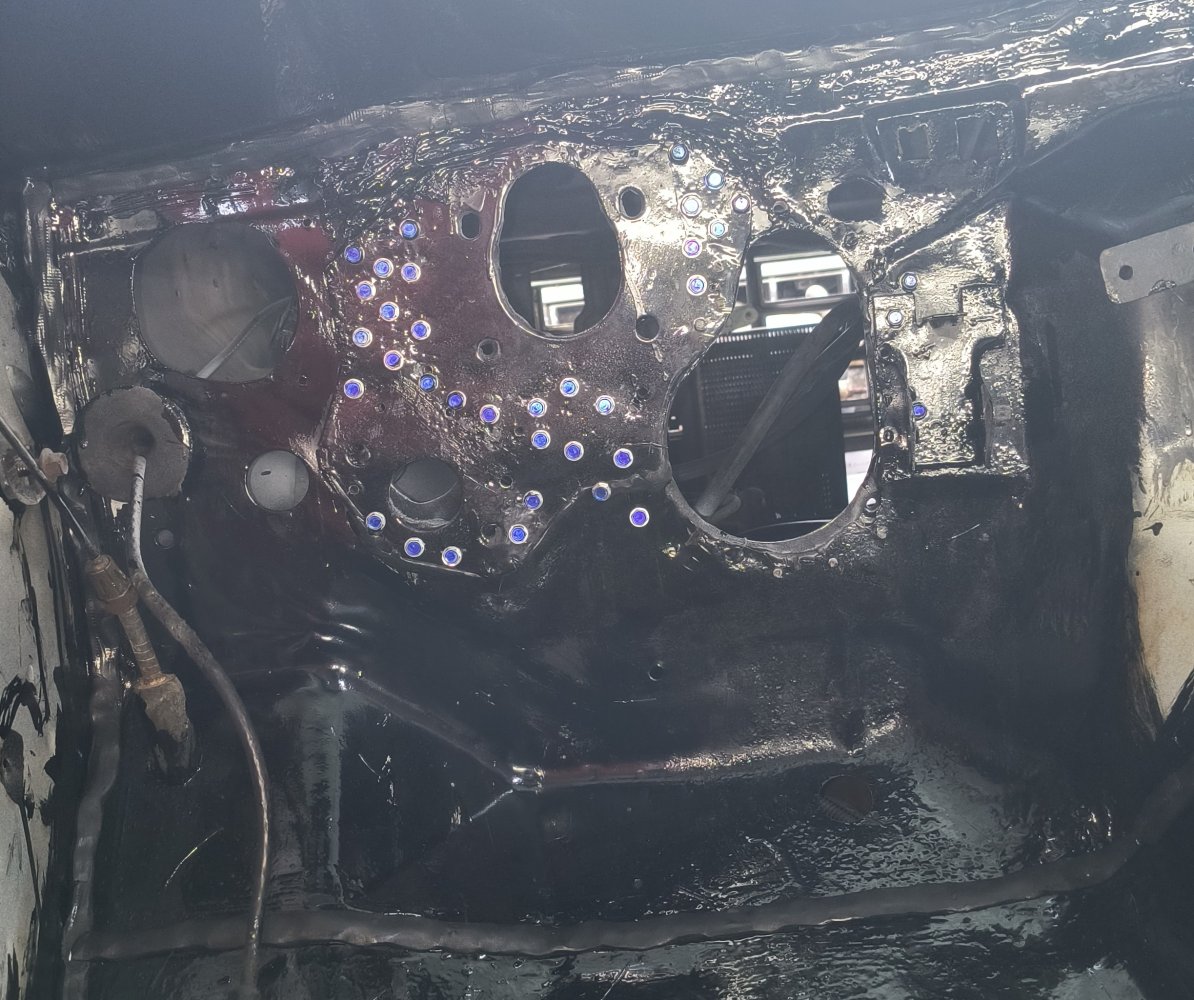

The Explorer's big driver's side wire bundle firewall hole is also a little different, as suggested by others, I chose to adapter a section of the Explorer's cab side firewall into the BII to make this more plug and play.

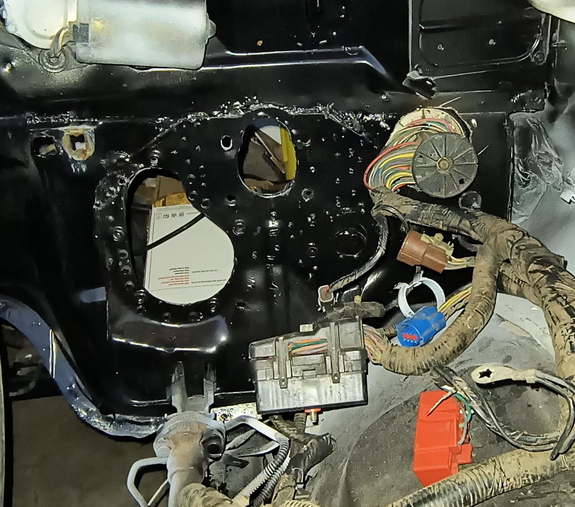

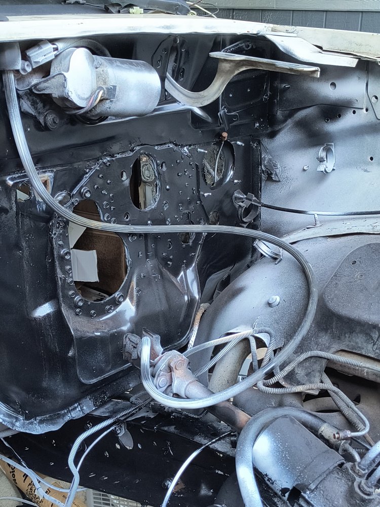

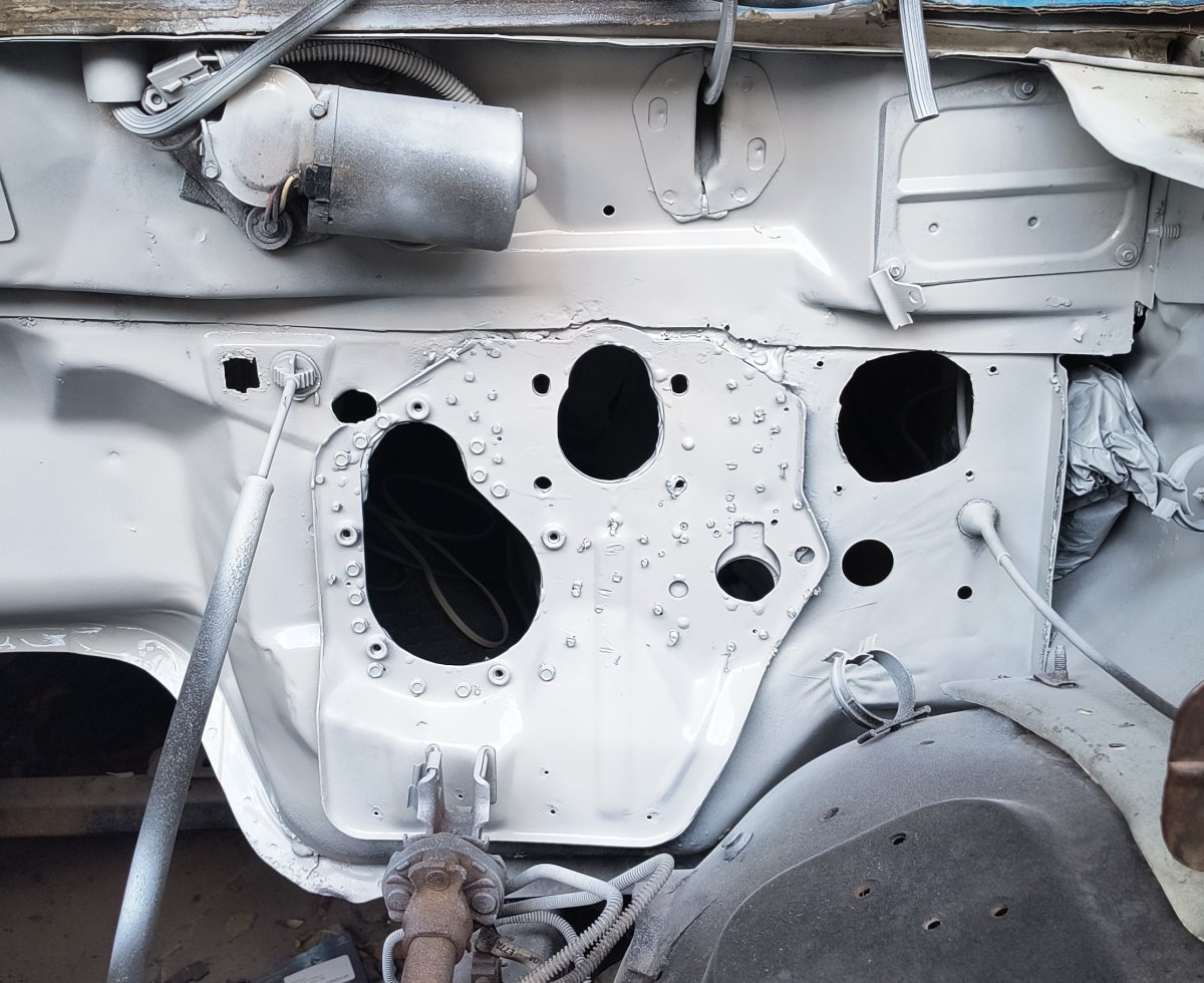

Here is the progression of changes:
1, Explorer engine bay reinforcement plate located, installed with firewall cutout for 94 steering column.
2, cab side (bad lighting), shows triming togas pedal bracket and harness hole opened up for big connector.

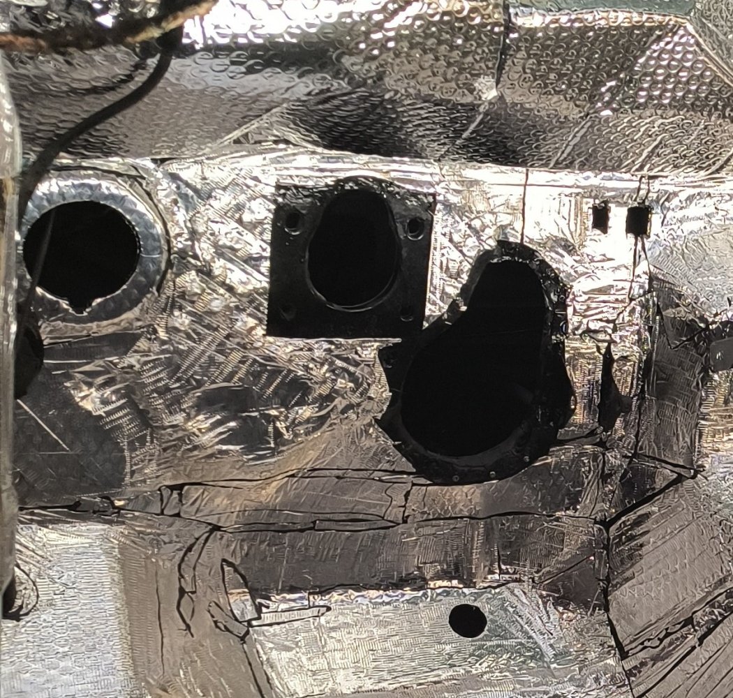

1, cabin with Explorer keyed harness connector hole.
2, engine side.
3, with big harness bundle connector in keyed hole.

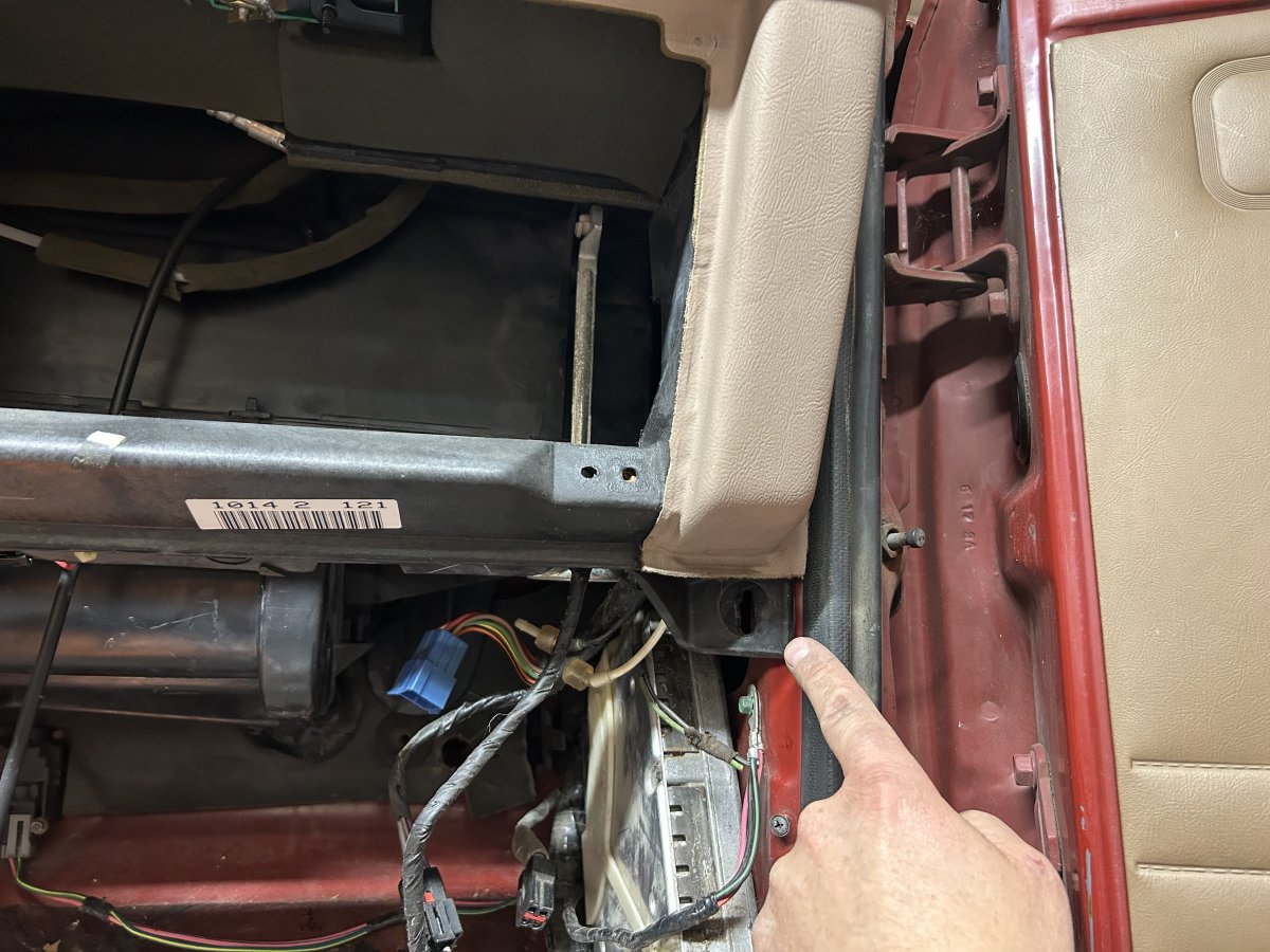

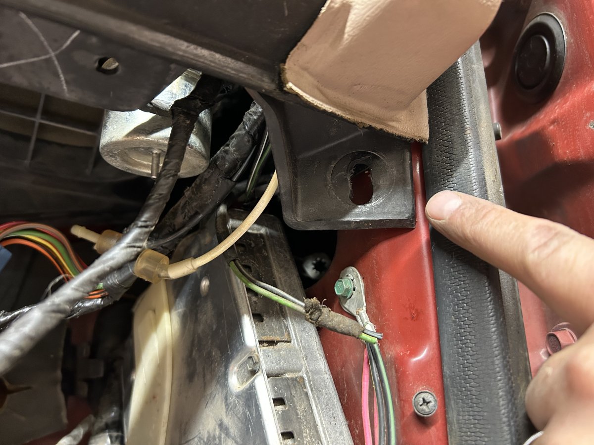

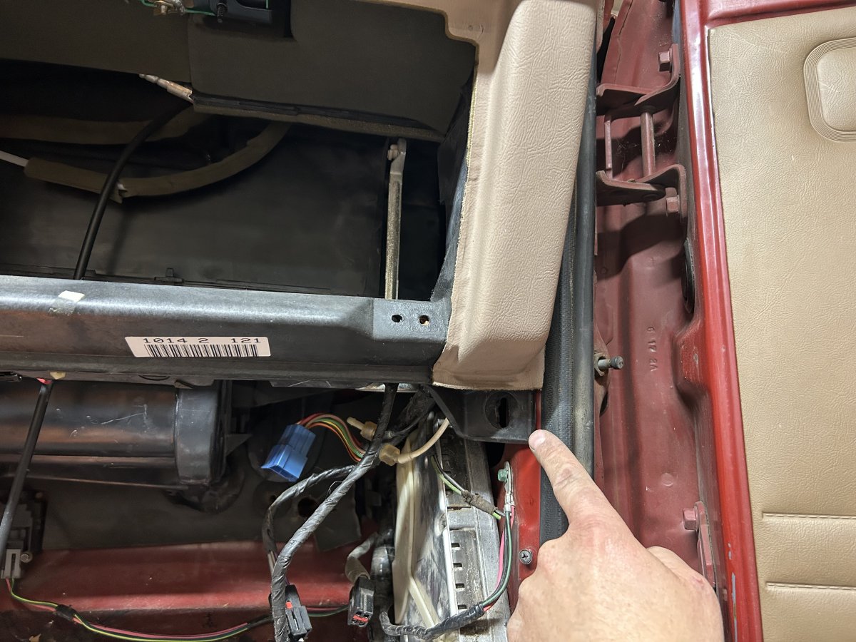

I found a mounting hole on the column bracket that will work to anchor the dash, as well as one down by the the parking brake bracket... but the explorer dash requires a mounting tab for the passenger side, down by the ECM (computer). Currently, it is unsupported and needs something to connect it to the A column. Here are some pics to help understand. What did you do to anchor it?
  • 1986 to 1994 4.0 Swap - HELP - question about steering and dash
It wouldn't be that hard to just fabricate a mount.
i would just make a tab with flat stock.
there are several variations of these and this is the first of those. the steering and hvac change again after 94....
