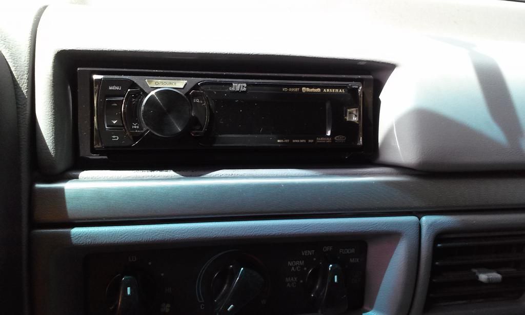

Well I got my new head unit installed. It sounds awesome! :headbang: The USB cables aren't quite long enough to reach the console though. I might just plug in some extension cables, or run them to the glove box instead. We'll see. I'm going to eventually add an amp to power a subwoofer, so I already connected an RCA cable and remote turn-on lead, so I won't have to take the head unit back out of the dash again. I also connected wires to the switched 12 volt wire and the illumination wire in the harness. These wires are currently just hanging out the bottom of the dash. In case I add any aftermarket gauges in the future, I'll need these wires to power the gauges, and to light them up at night. Again, just thinking ahead so I don't have to pull the head unit out again.

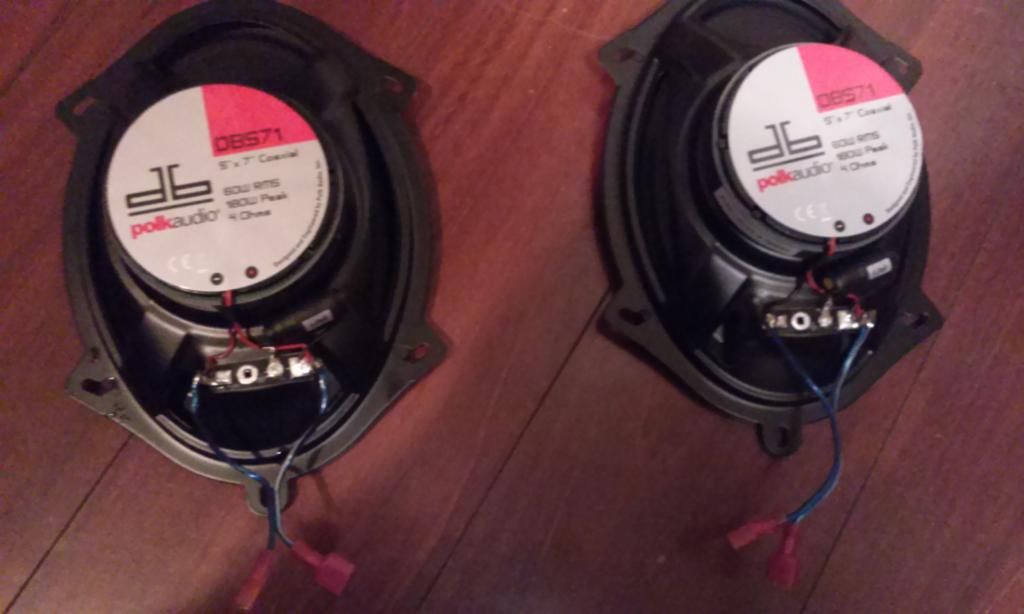

I soldered pigtails onto the rear speakers, just like I did with the front speakers
And, they're installed

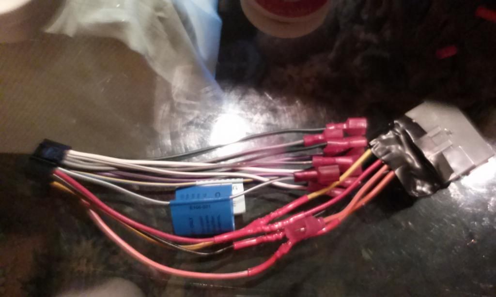

Head unit wiring harness soldered together
Big ol' mess of wires hanging out of the dash with everything labeled.
Wiring harness installed in truck, which cleaned things up nicely
And head unit installed
