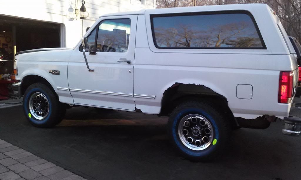

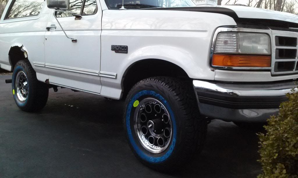

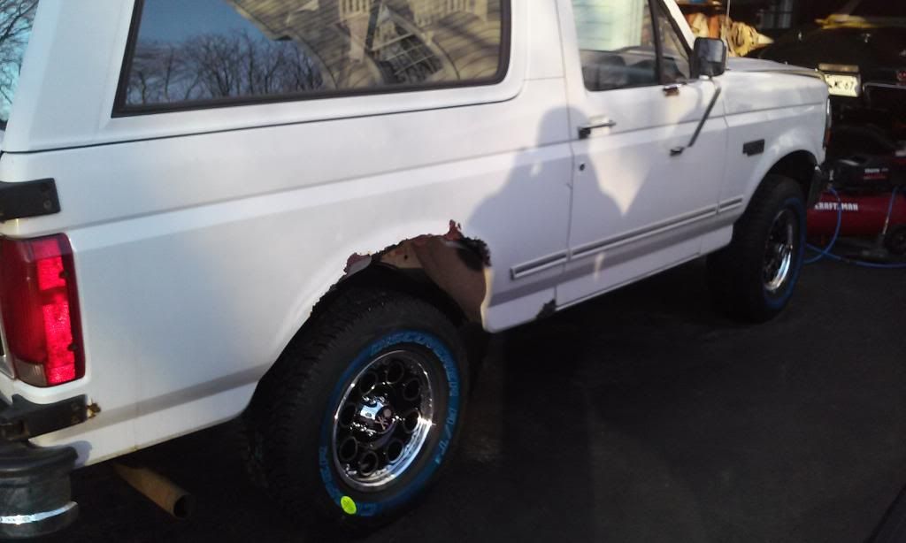

My mom texted me and said my wheels/tires have arrived this morning. Usually when something gets delivered to my house via UPS, it comes at around 5:00 PM. But the delivery guy said the tires are huge and there was no way he was gonna drive around all day with them lol! I'll be installing them tonight, just to see how they look. I may take them right back off until I get the front end done, though. I'll definitely get some pics with them on.

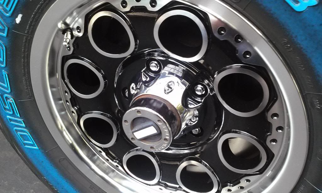

I didn't have time to clean the blue crap off last night, but I think these look absolutely bitchin! I tried looking for open center caps, so the manual hubs can poke through. I couldn't find any online. I might just cut holes in the ones I have.
Yesterday I cut the center caps so they would fit over the hubs, and I cleaned the blue crap off the tires.
