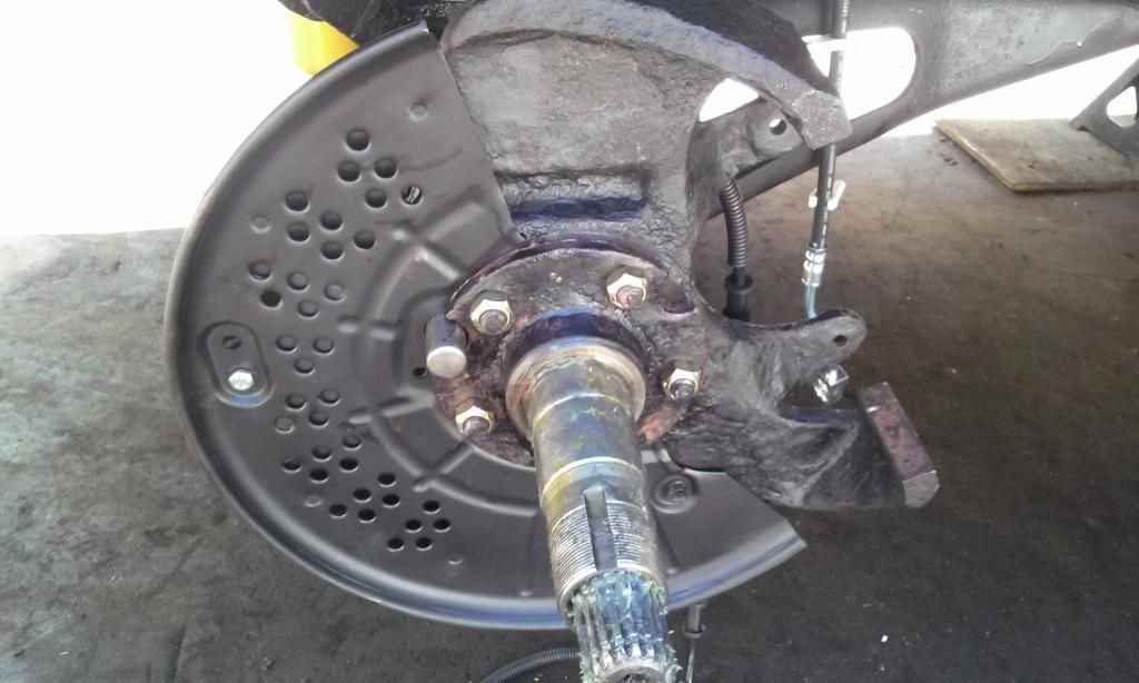

The passenger side stub shaft on the D50 is different than the D44, so I have to use my new Craigslist shaft. It's bigger and stronger anyway (woot, upgrades!). The U-joint in it is really bad, so I tried to replace it last night. It is extremely rusty and the clips broke off when I tried to remove them. I gave up and dropped the shaft off at a driveshaft shop this morning.

I also picked up the stub shaft from the shop last night. They did a great job replacing that U-joint, and they even knocked all the rust off and cleaned it really well. It's like it's brand new.

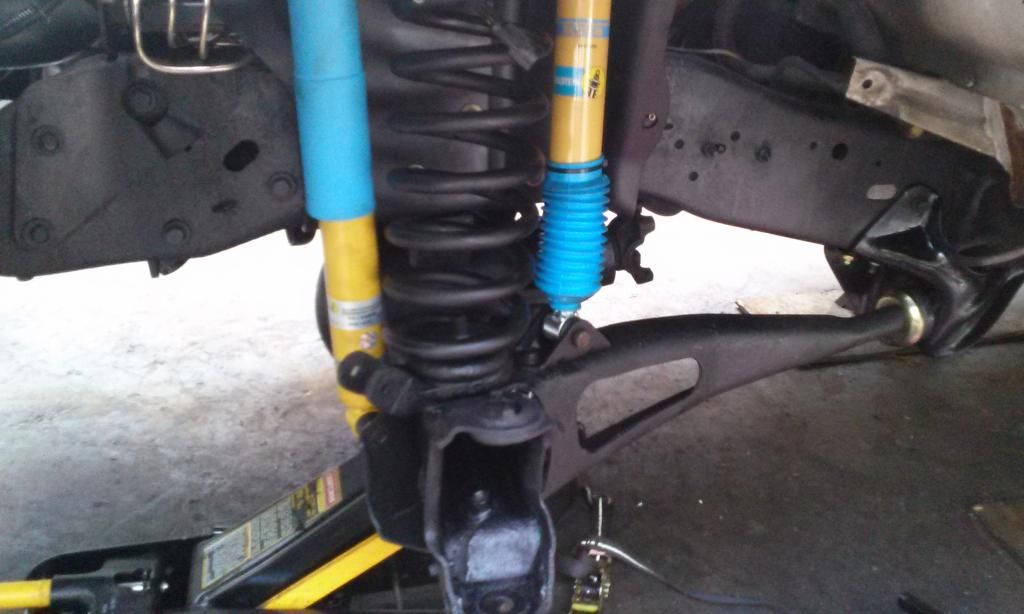

So I was looking back through this thread, and I realized I never posted pics of the driver's side suspension rebuild! Whoops! Better late than never I guess...Here's the driver's side coming back together:
