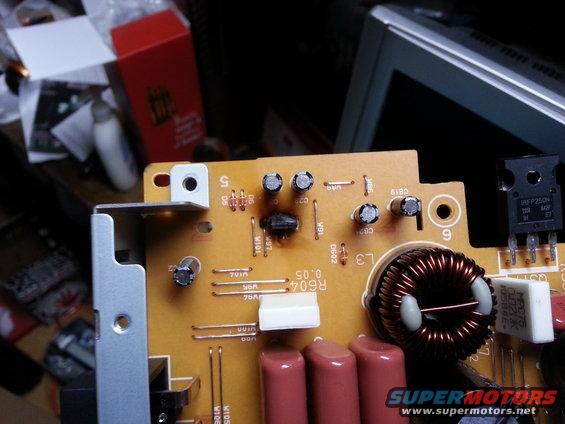

Slight change of plans on the amp...I was driving the Accord to work yesterday when all of a sudden my sub stops working. It also didn't work at all on the way home, and I could smell a "burnt electronics" smell. I did some diagnosing when I got home, and came to the conclusion that my amp is dead. I took it apart out of curiosity and found a burned up transistor:

I think I can maybe solder a new one in there and fix it. It's worth a try, I guess. If I can't fix it, I'll get a new amp for the Bronco. Now I need to start shopping for a new amp for the Accord a little sooner than I had planned.
