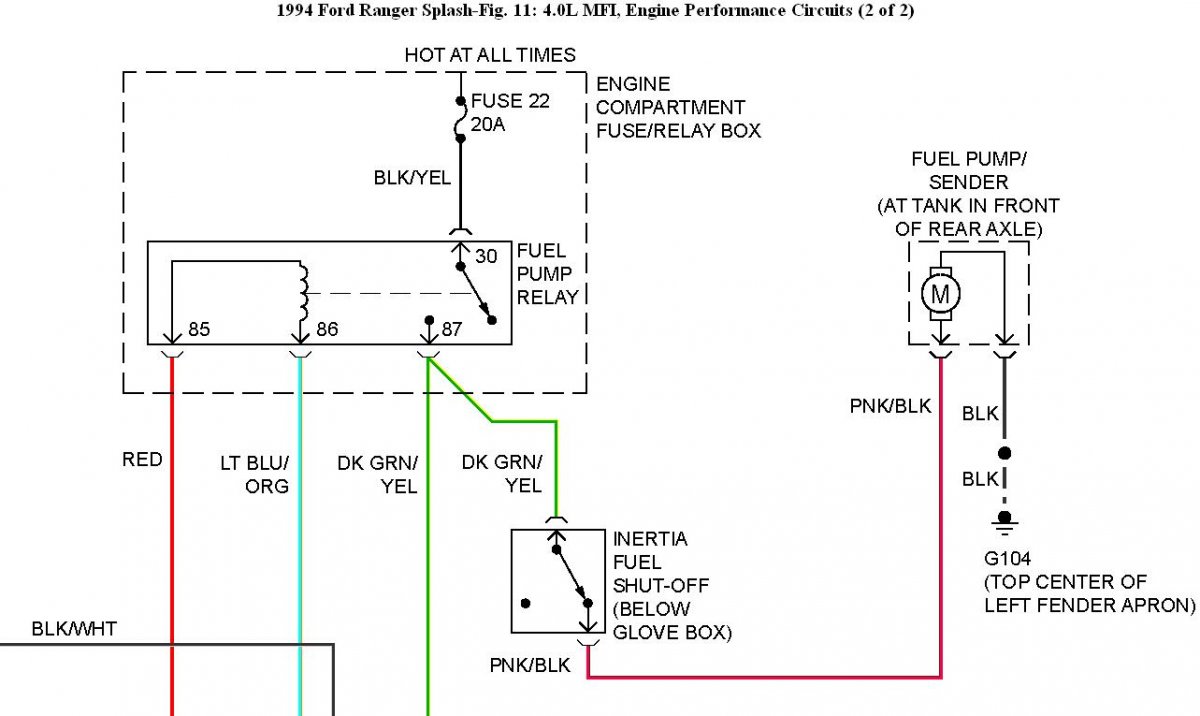

Does anyone know which colors are what on a 94 4.0? (Sender, power, ground, ground) there's 4 wires and I think this is the proper circuit diagram but it doesn't show the actual connector.
