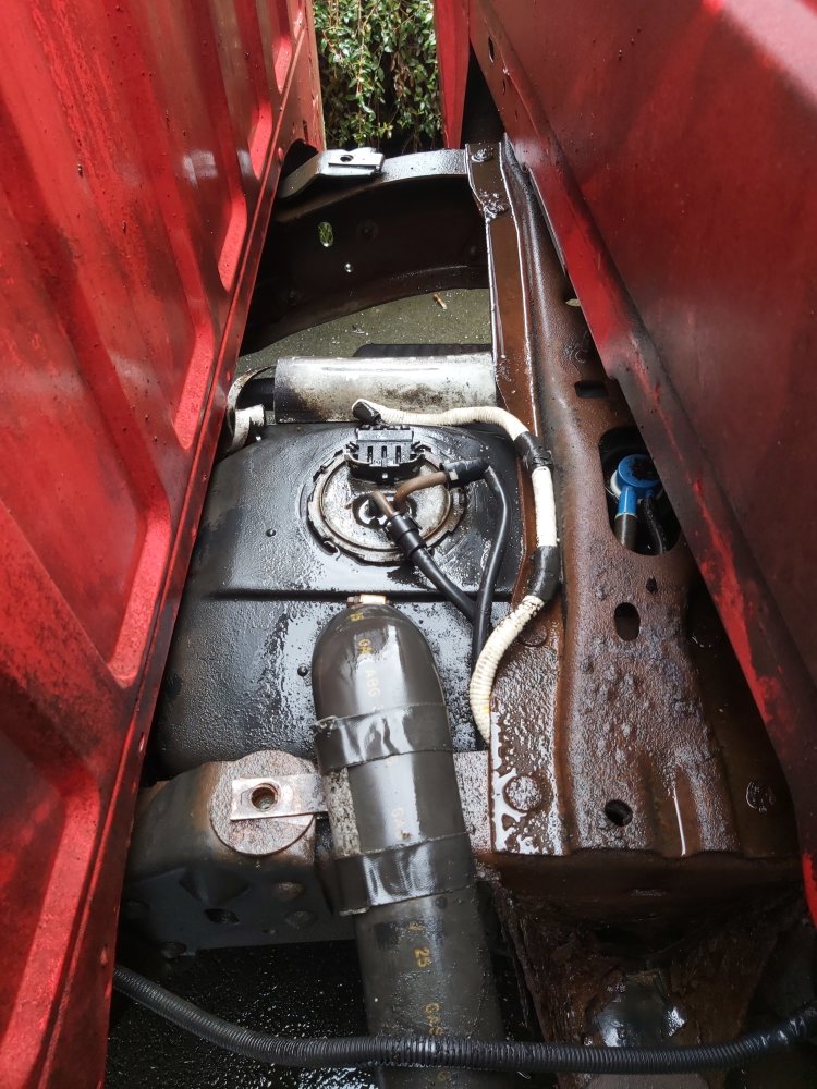

This morning I got the tools out and canopy off, then bed liner out
6 bed bolts came out OK, tight but all 6 came out with breaker bar and T-55
3 7mm filler bolts
1 rear light connector
Bed is slid back and I hosed off the top of tank
Took a few hours
I will let it dry out a bit, before testing wires and pulling fuel lines, still raining off and on here
