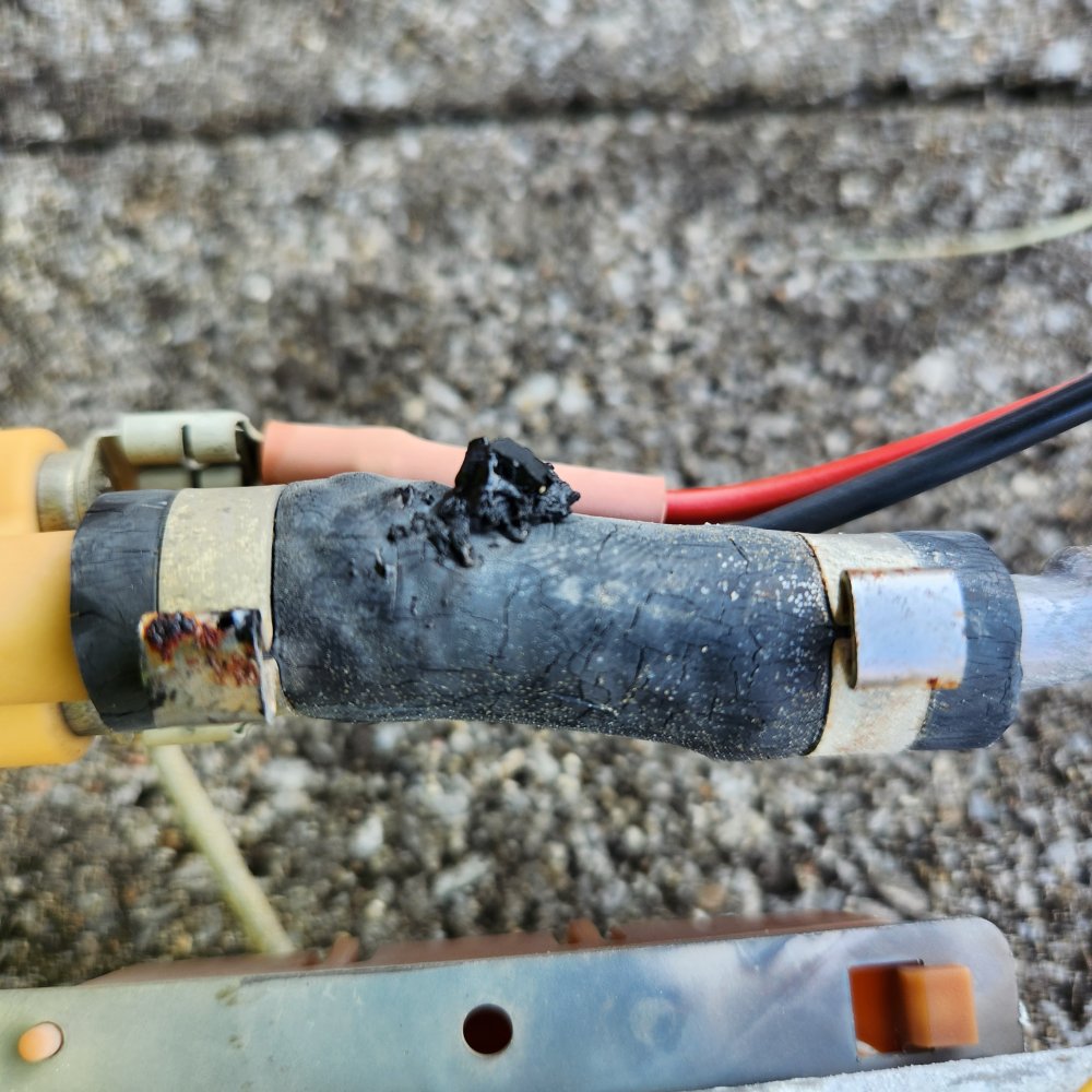

I have to replace the Fuel Tank Filler Hose again too as that hasn't lasted even 5 years!
The end of the smaller, internal hose has rotted away and I'm thinking that some of that debris may have caused the Fuel Pump to fail.

Welcome to the new world we live in. If you find someone that has it in stock, it's all cheap China junk.
I bought a filler hose for my '97 and it was the wrong one, I think it was like 2" too short... so I have nothing on that, I ended up wrapping nylon pipe tape around the hose and putting the clamp on the outside, haven't leaked fuel out the filler neck in over a year for about $.25 in tape...
The fuel pump on the other hand, the inlet sock should take care of any random hose stuff, they just go out over time and things happen... Yes there's a LOT of junk out there anymore... I put a Delphi unit in the '90 several years ago and it's going fine... I was going to say grab a generic Walbro unit with sock and install kit but they're kinda spendy and you don't need the 255lph units like they all look like...
