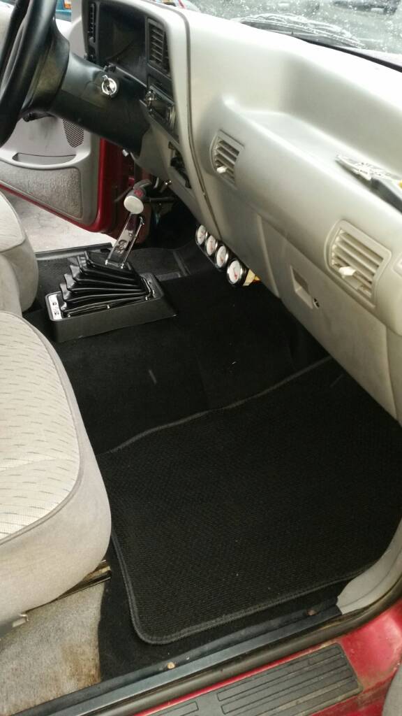

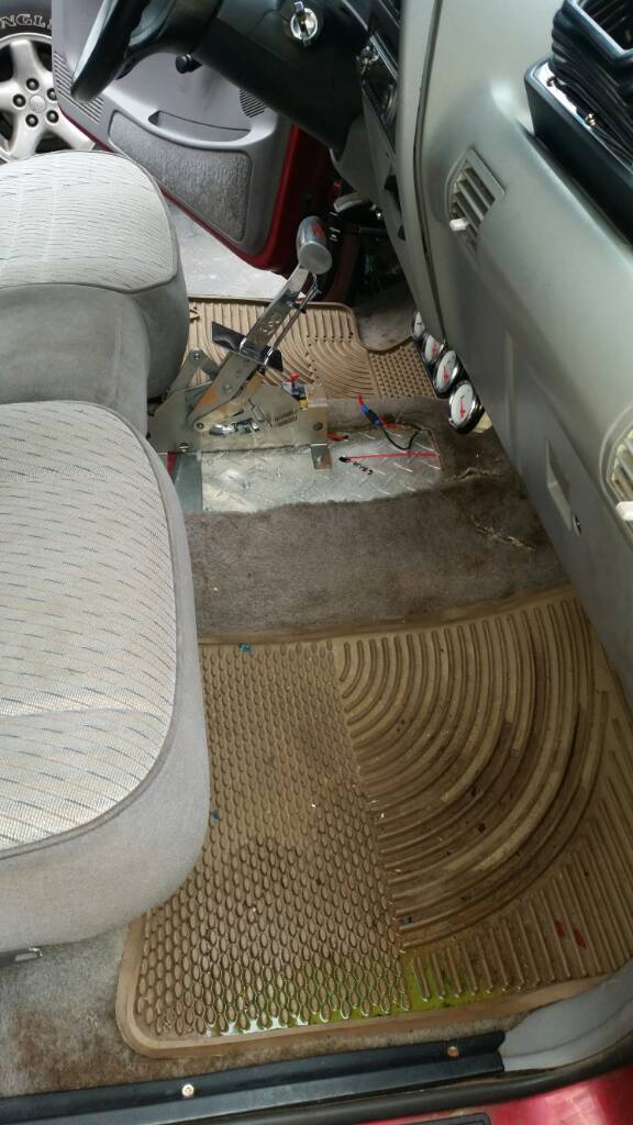

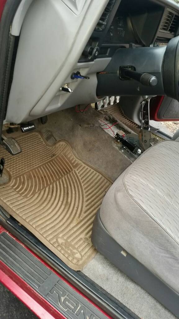

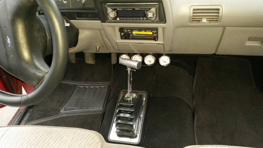

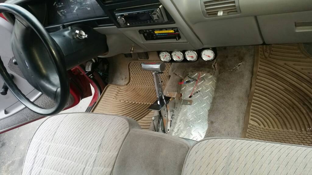

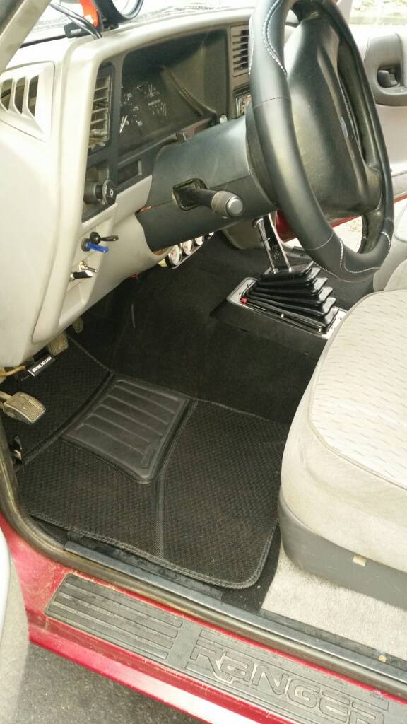

I didn't do much today on it but did manage to improve the interior a lil for my driving pleasure :)
Before:
After:
It's not the best but def cleaner Than previously and will hold over till I get new carpet and seats figured out, total cost of 40 bucks, included a new steering cover also.
