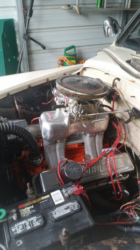

Hey 84, forgot to address ur question on the hot rod, my bad. That's my dad's 1950 dodge coronet rat rod he calls roadkill ;). It's got a 283 sbc pretty worked with th350 n stock rear till spring.
We made his hood scoop out of an old grill.

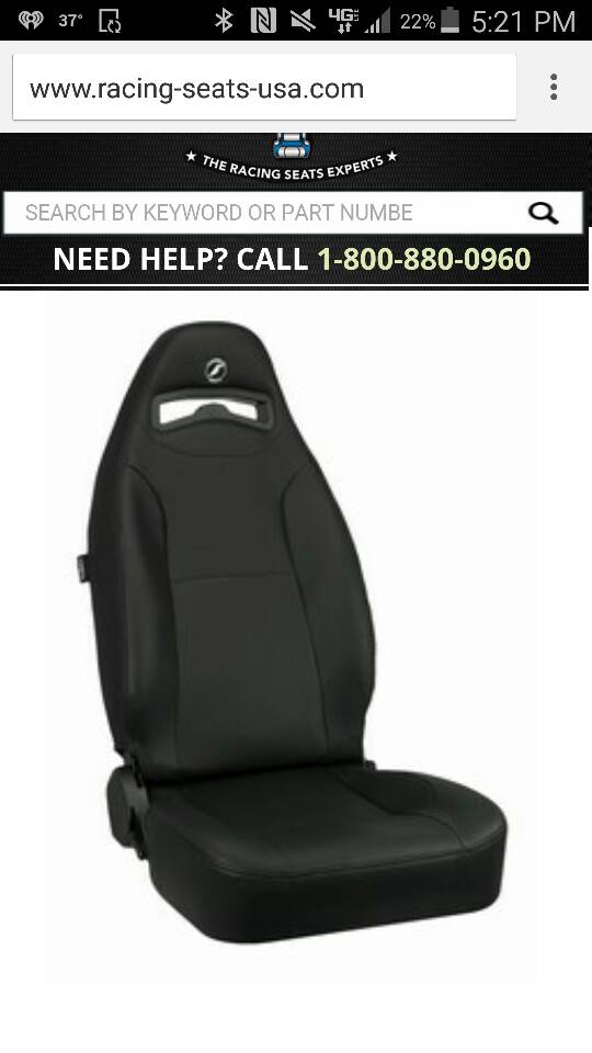

I also pretty sure I found the seats I want to use for when I get to interior stuff.
Check em out, corbeau moabs:
They are under 500 for the pair so I think that is the way to go when I get there.....for today's thoughts anyways haha
