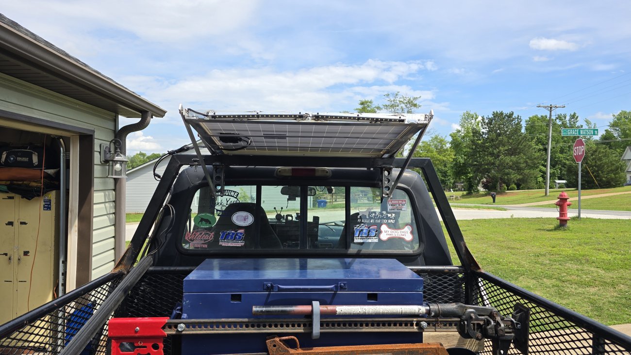

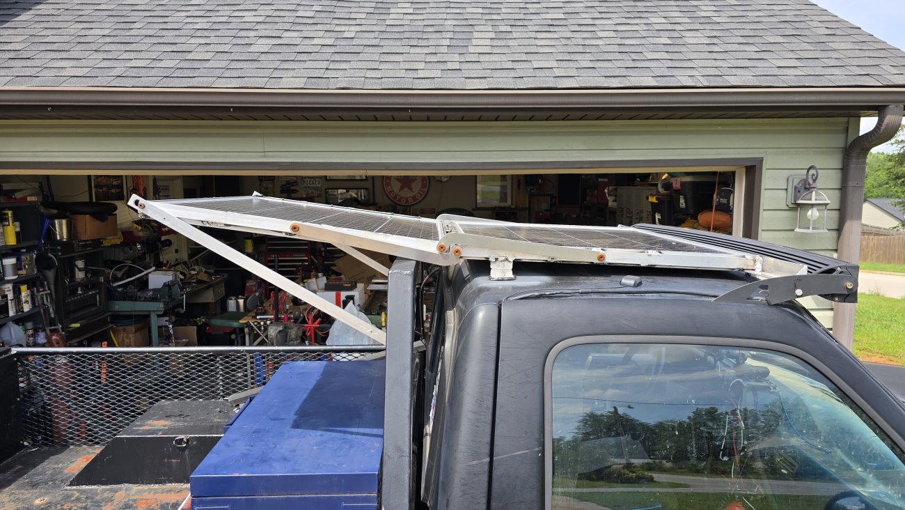

Can you charge on the go with the one panel or is that even a thing?
Both panels are always connected to the solar controller. If both panels see sunshine, both charge. If one is in the dark, it just doesn't generate any voltage.
If the Automatic Cutoff relay on the engi e battery senses too much difference between the house batteries and engine battery, it will separate them to preserve the engine battery. But the solar controller is always connected to the system to charge whatever batteries are active. The solar controller has some smart programs for various charging styles and battery conditions.

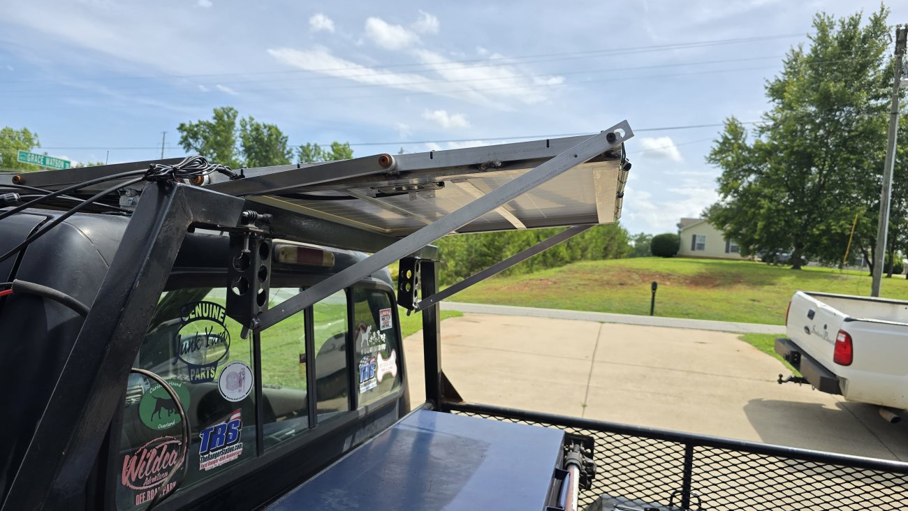

Today, I made some supports for the rear end of the solar panels when they are deployed. They aren't heavy. But I didn't like the way so much panel hung unsupported past the cantilever arms. This is much better. I also got the LED strips wired up today.

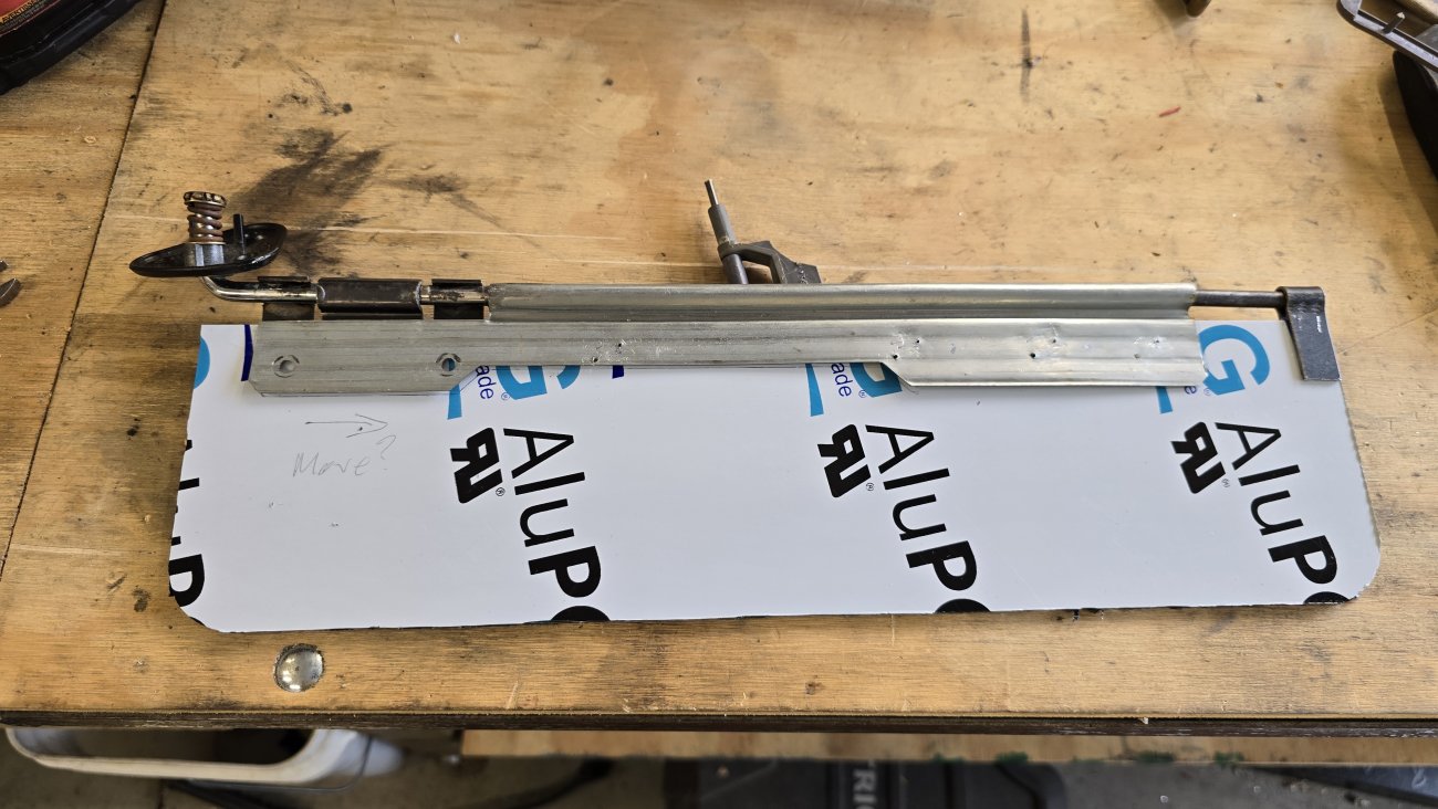

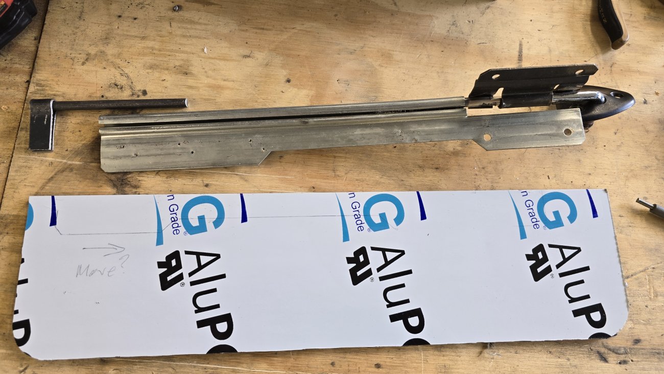

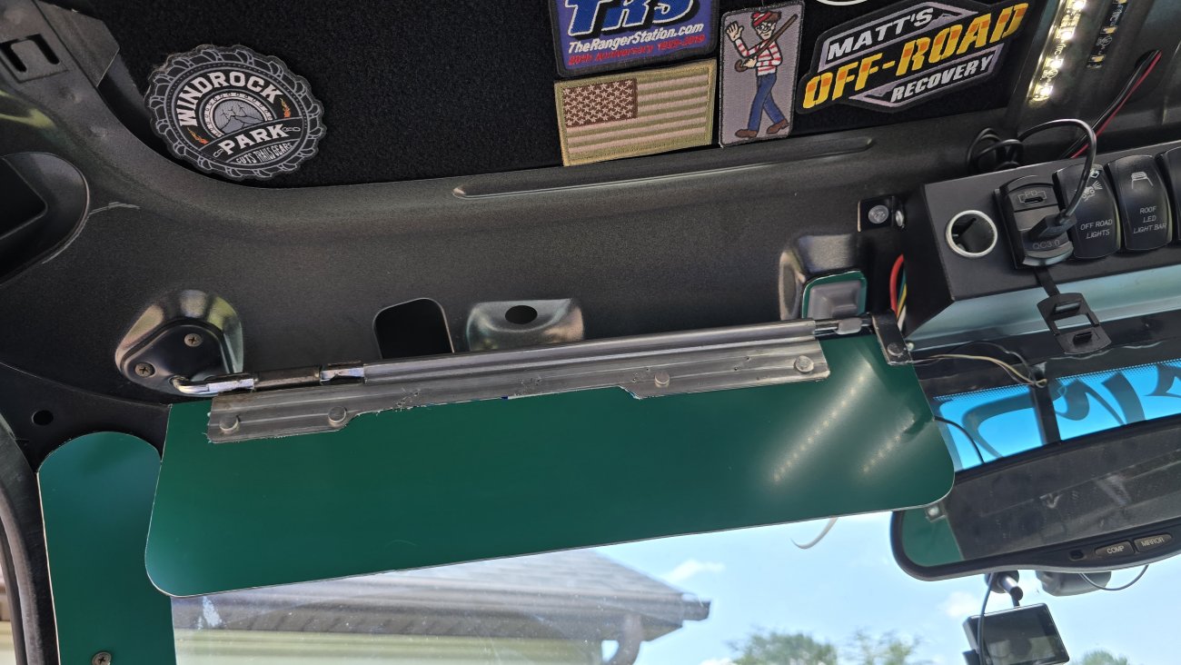

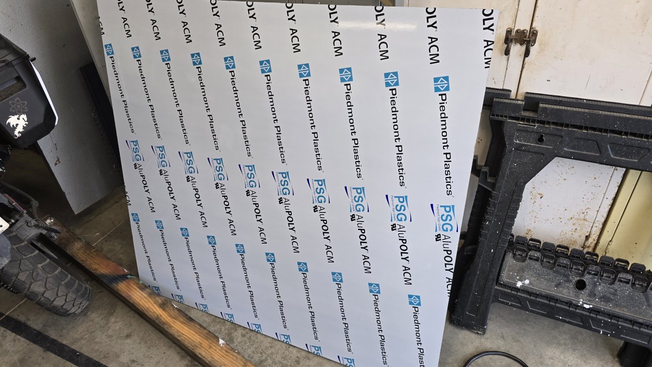

I worked on rebuilding my sun visors today. The originals needed to be recovered and also shortened to clear the auxiliary switch panel I installed. I stopped by a place that sells plastics to see what materials might be available. He was recommending plexiglass. But I didn't like that. It doesn't block sun very well unless you paint or cover it. ABS might work. Then he mentioned some metal-clad plastic that is commonly used in the sign industry. Some kind of plastic sandwiched between 2 sheets of aluminum, and it comes in colors. It was actually cheaper than plexiglass. So I got some in a nice green that matches my Curious Hound logo. Very easy to work with. He said you can score it and break it. I chose to cut it with my metal cutting mini circular saw. I've cut the pieces and stripped the old visors apart.
My plan is to assemble using solid aluminum domed head rivets. Still waiting on my rivet setter to arrive. So, no finished photos today. Also, the plastic end part where it snaps into the clip in the roof was brittle and hard to work with. So I remade that using some 1/4" steel rod and 16ga sheet metal.

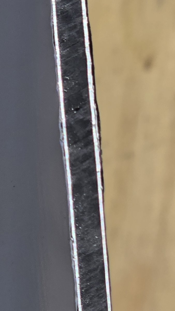

This is the material. I had to buy 1/2 a sheet.
1993 Splash in SC
An edge view of the aluminum/plastic sandwich.

The parts laid out.
1993 Splash in SC
This is how it will assemble.
1993 Splash in SC
I like it. So all that hardware on top was in the factory visor?

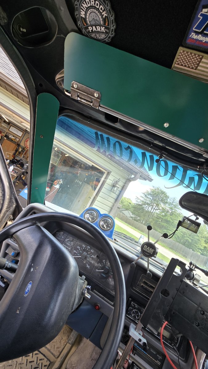

Yes. I just got rid of the cloth, foam padding and mdf stiffened. I'm even considering putting the mirror back on the new passenger side visor.

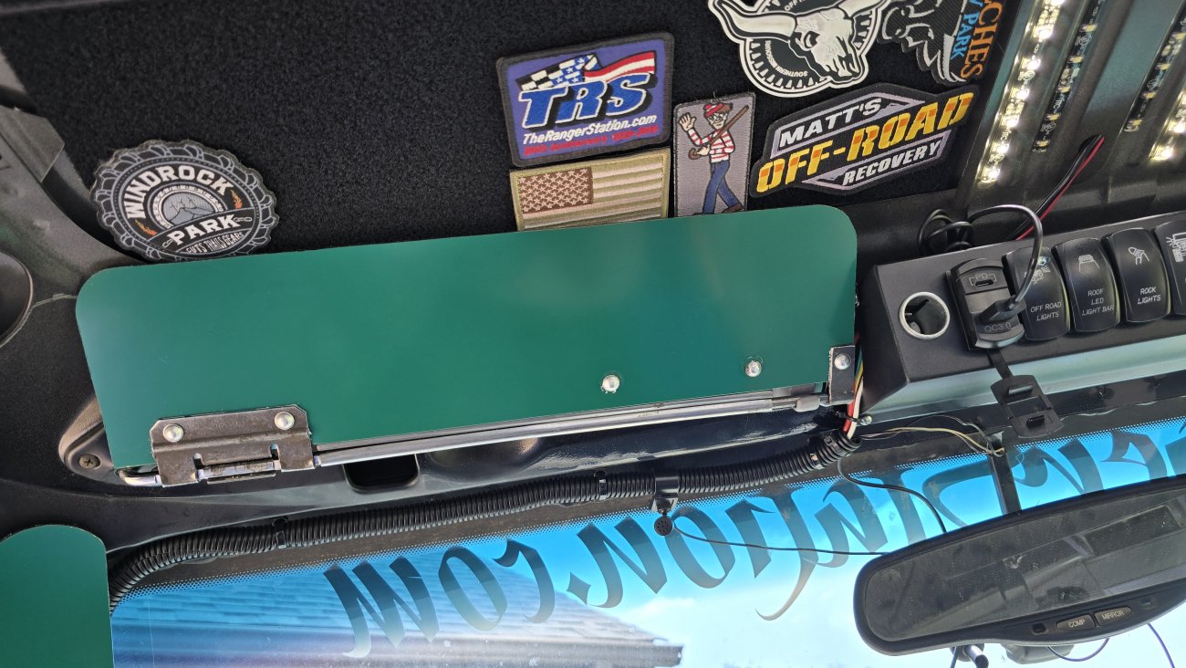

Finished the visors and decided to make some simple trim pieces for the A-pillars. I like it.
Interesting note; the hardware pieces for the visors are identical. There is no "left side" or right side designation. What that means is that on one side you see the "front" of the hardware and on the other side you see the "back".

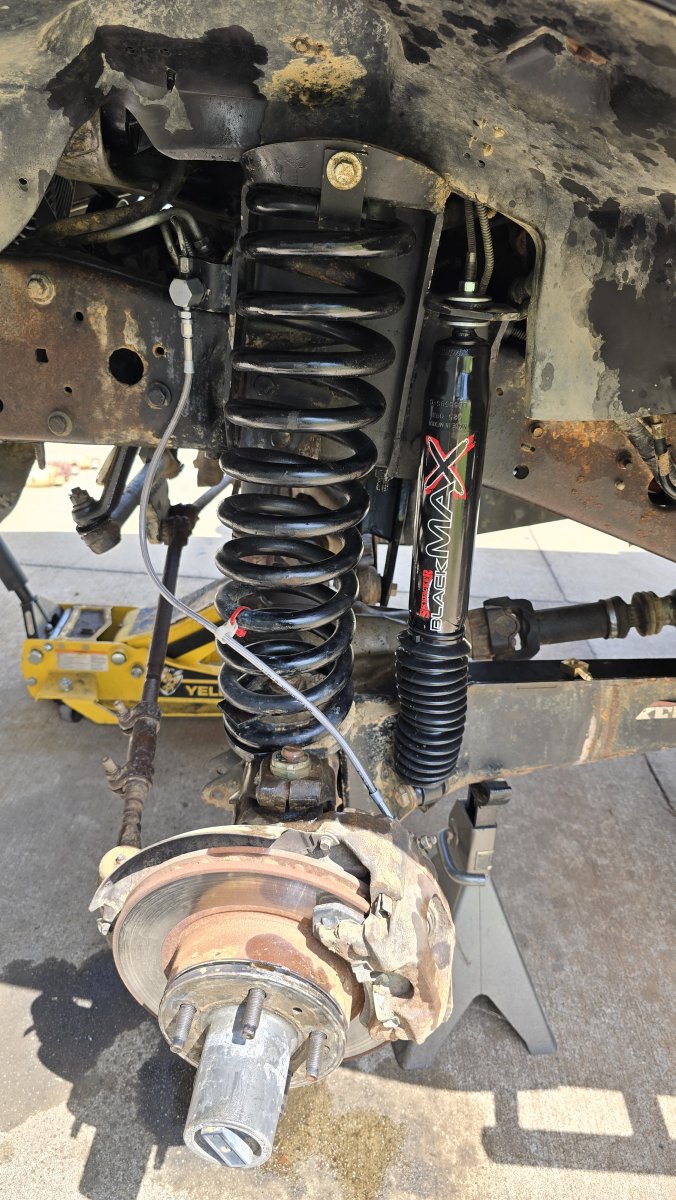

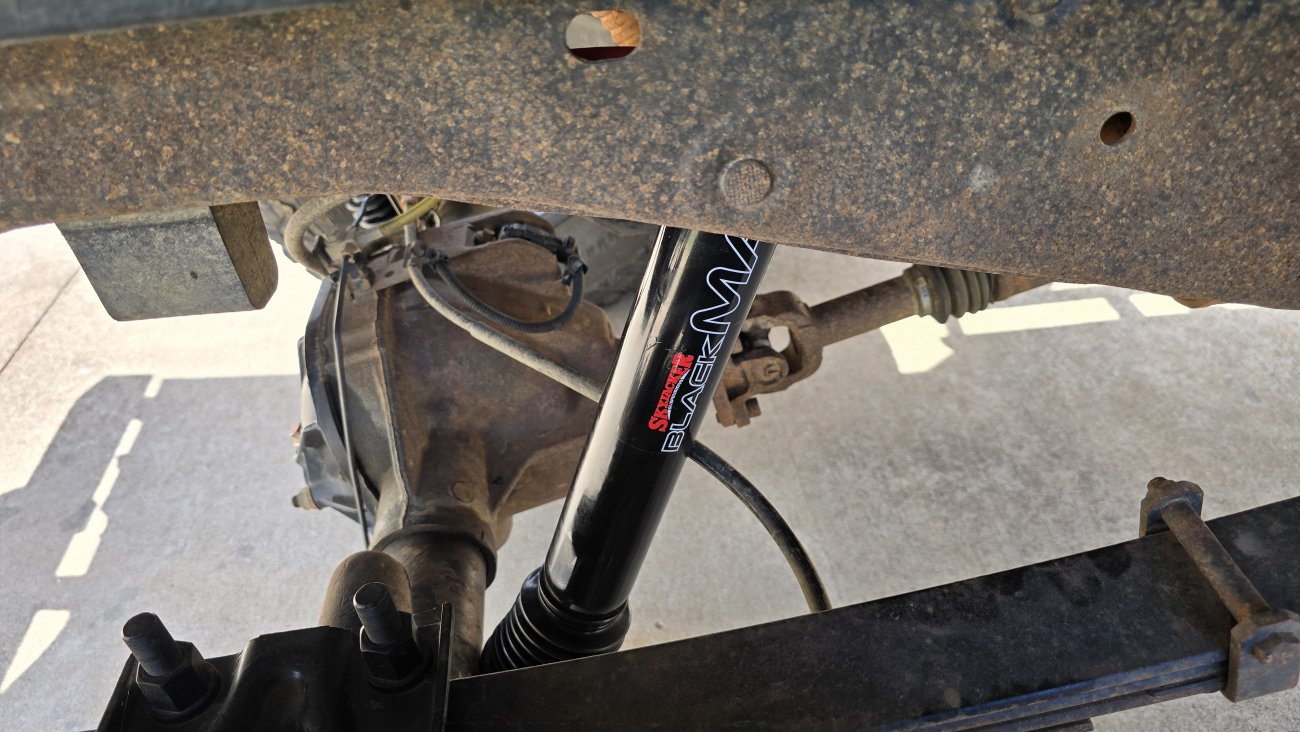

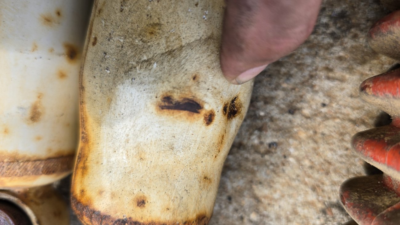

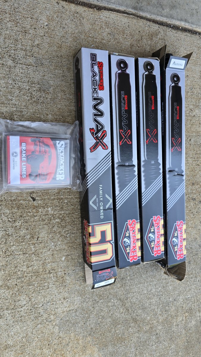

Today's work was more for "peace of mind". I replaced shocks all around and brake hoses in the front. Just trying to make the truck as ready and reliable as I can. The front brake hoses have acted as suspension limiting straps a few times and I was nervous that they may be compromised.
Components ready to go.
1993 Splash in SC

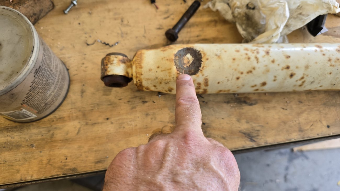

My driver side rear shock has had this dent for several years.
1993 Splash in SC
1993 Splash in SC

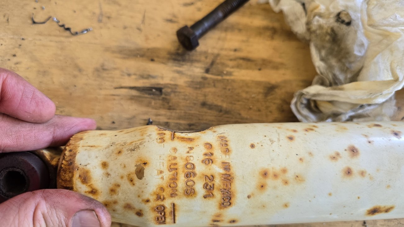

Didn't know about this dent on a front shock until I took them off today.
1993 Splash in SC
I feel better now.
1993 Splash in SC
1993 Splash in SC
1993 Splash in SC
Dang it.
