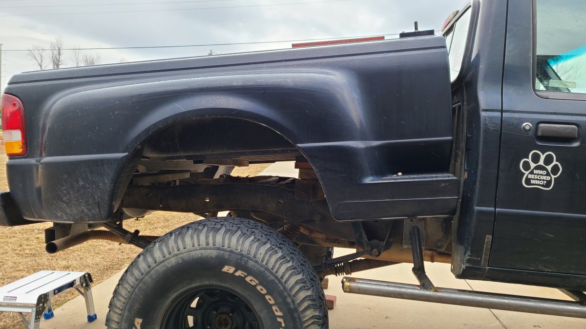

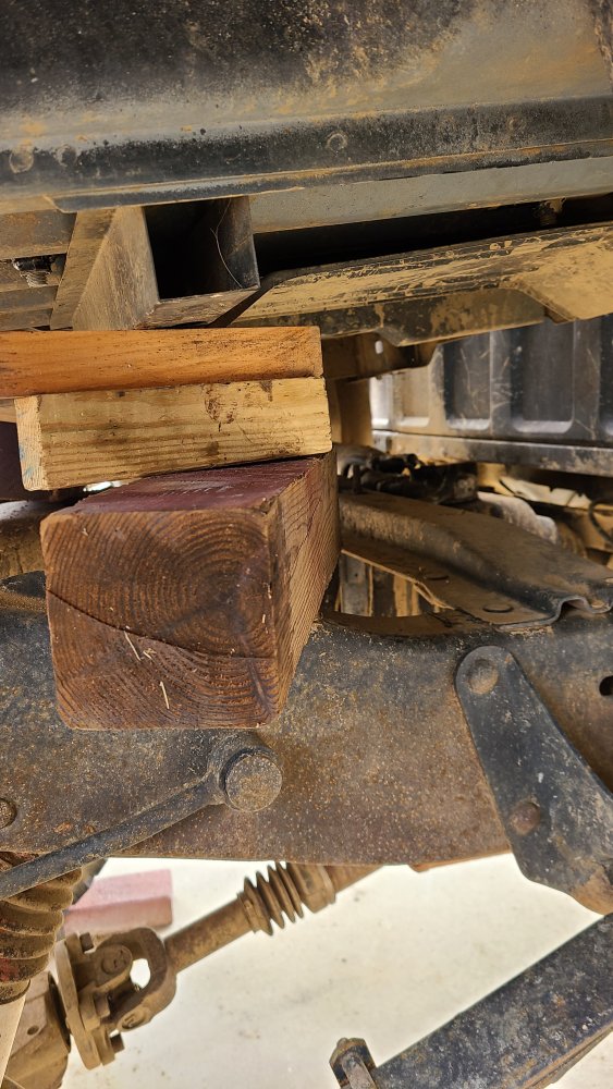

Passenger side is almost finished. Rivets are drilled out of body mount and parking brake cable bracket on driver side. I don't want to take the bed off for access on driver side. How is the fuel tank mounted? I removed the skid plate. I can see 3 bolts holding the tank. 1 at the rear and 2 above the drive shaft. I can't seem to locate anything within reach over by the frame rail. What's up there? All I really need is to put some blocks under the tank and slide it over toward the drive shaft while I work. I don't really need to drop it.

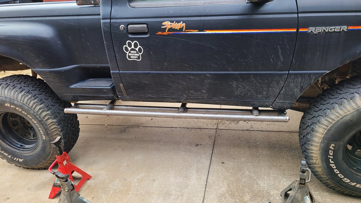

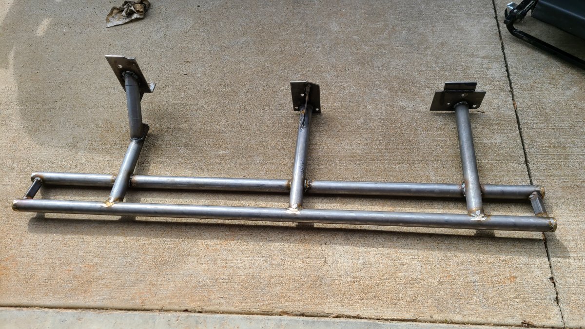

Passenger side

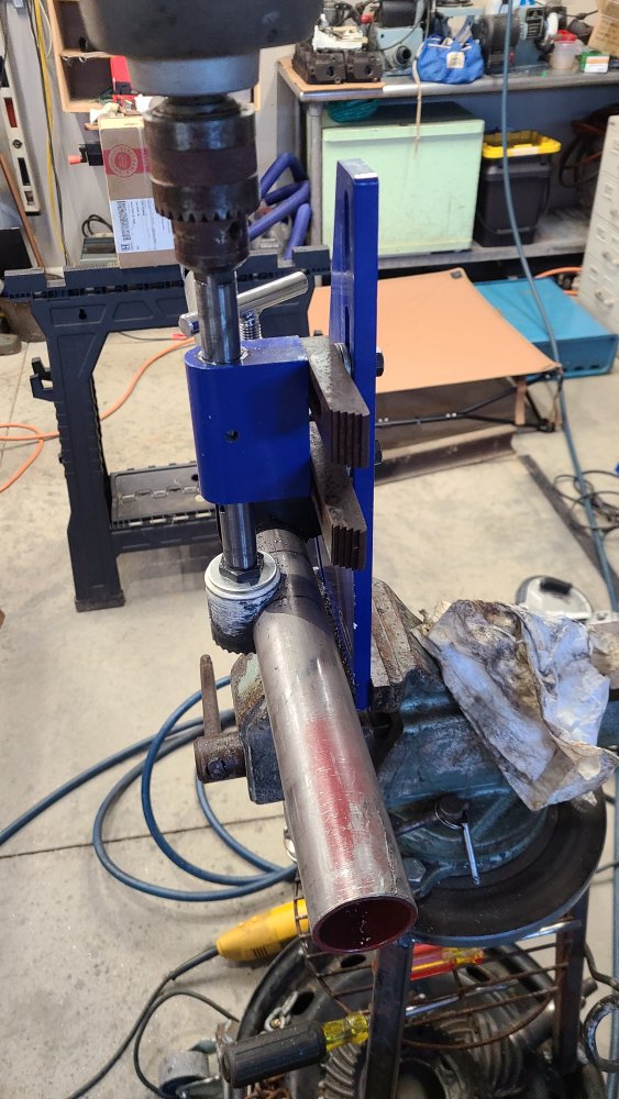

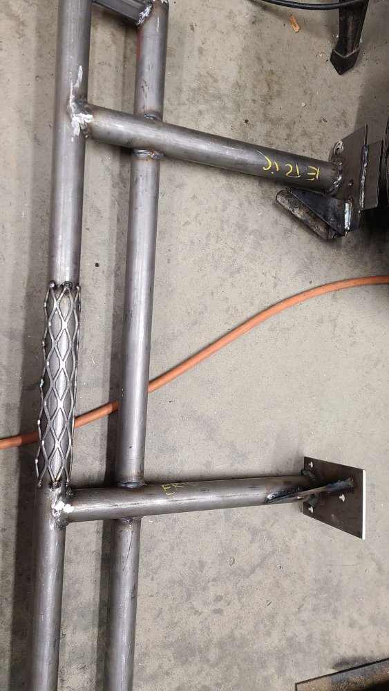

Here is how I used the tubing notcher to cut saddles.
On mine one end of one strap has a "T" shaped end that sits in a slot on a crossmember.
Yeah the tank straps will be in slots in the frame, and you kind of have to move the tank out of the way to get the straps to lift/rotate enough to come out.
Looking good!
Thanks, both of you.. That gives me the confidence to put some blocks under the tank, remove the bolts and see if I can slide it over a couple inches. There's only 1/4 tank of fuel in it.

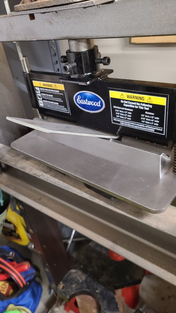

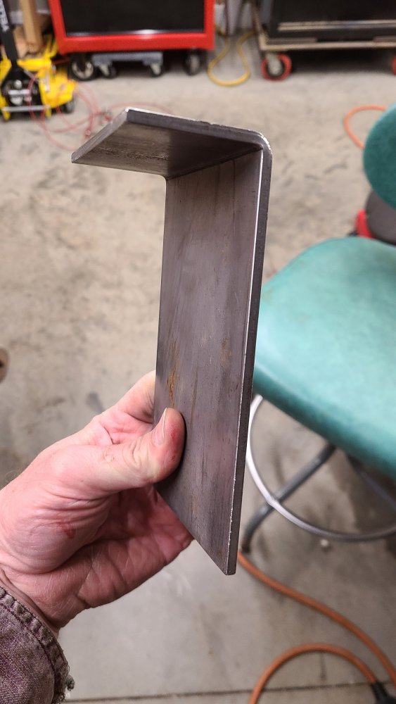

Borrowed a brake from a coworker so I could bend some brackets. I need to get one of these.
Passenger side finished except for paint.

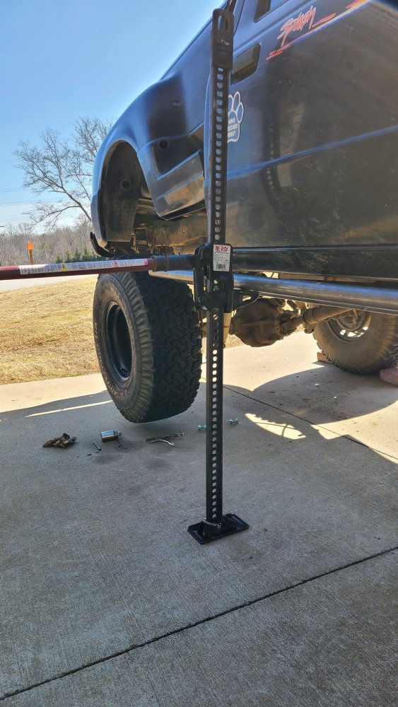

Passed the load test.
In case any new people are wondering if 1 person can lift the bed for access to fuel tank, springbhangars, shocks, etc. Remove all but the rear bed bolts. Loosen the rear bolts as far as you can. Go to one side, lift bed and put a block in. Then the other side. Then add another or bigger block on first side.just walk it up a step at a time and make sure you have the blocks in a good position.

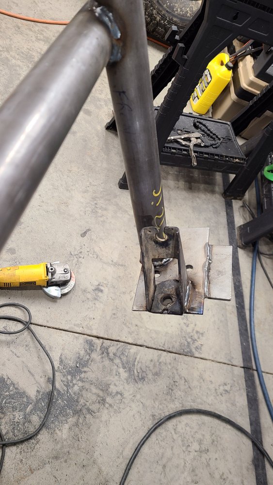

Got all the holes drilled in the frame on the driver side and all the major pieces of the slider are tacked together. Now i just have to finish welding. I’ll do that Friday. The event I wanted to attend this weekend will probably be rained out. So I’ll paint the sliders on Saturday. That way I can bolt everything together one last time and hopefully never have to mess with them again.
Looks good! Definitely very sturdy.
I like the saddle idea on the sliders. I never would have thought to do that.

Finished the welding today.
Incorporated the parking brake cable bracket on the front driver side mounting bracket.
And, last weekend, I found some expanded metal in a scrap bin and had an idea. A grippy spot to step on. Wish there was more of it.
