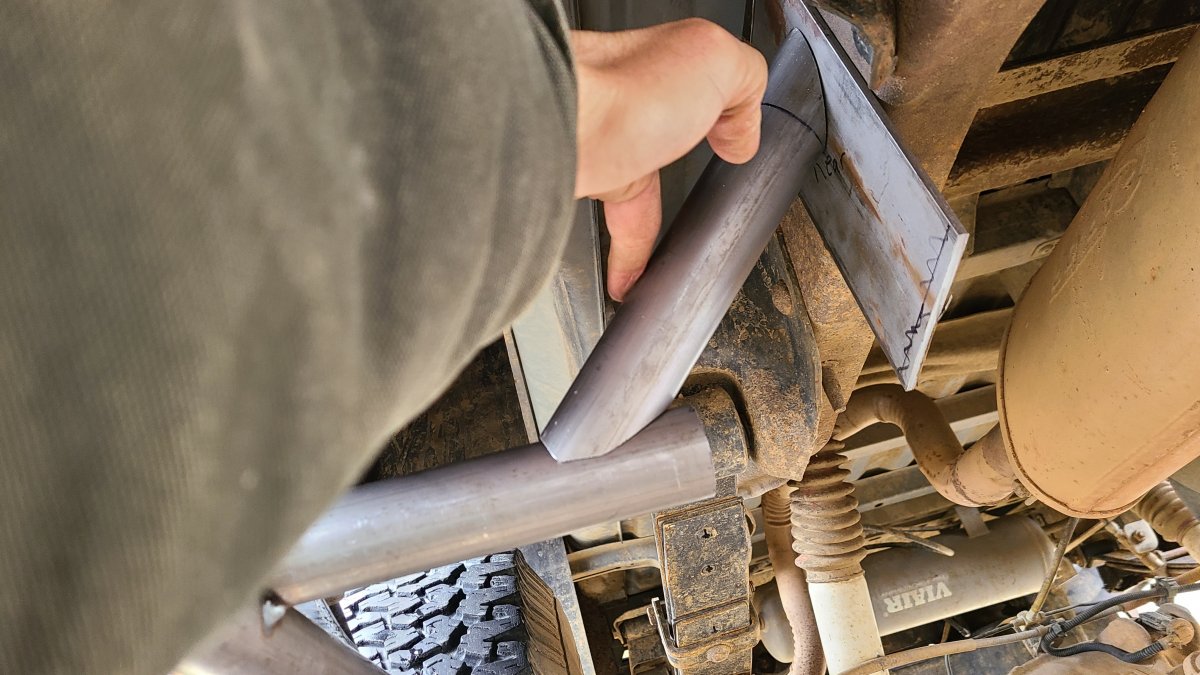

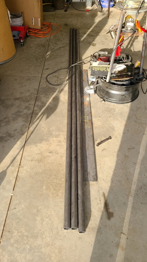

What have we here? 1 Do-it-yourself custom Rock sliders kit from Metals Supermarket. This is going to be interesting. My Skyjacker extended radius arm brackets take up a lot of real estate where I want to install my front Rock slider support. Middle support will be easy. Rear will take some engineering because the frame bends up behind the body quite a bit. Plus, the gas tank restricts access on the driver side for drilling and installing bolts.

That gas tank really is a pain where it is; one of the reasons I moved mine. You could run a couple bolts through the bottom of the C channel frame instead of through the side? And, could you bolt your bracket on top of the skyjacker one, reusing it's holes?
I was going to drop my tank for mine... But it was just out last summer.

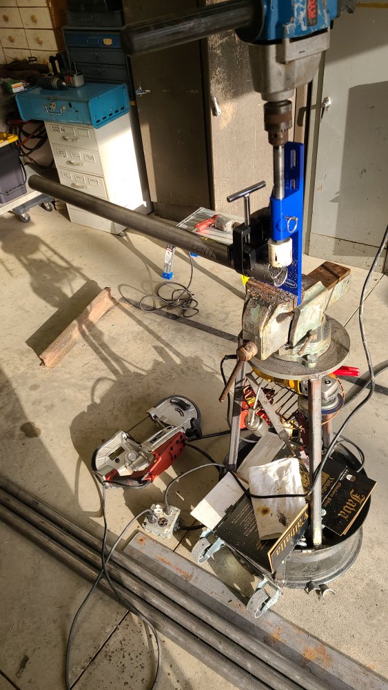

You bought yourself a tube notcher also?
Tubing notcher does some cool stuff.

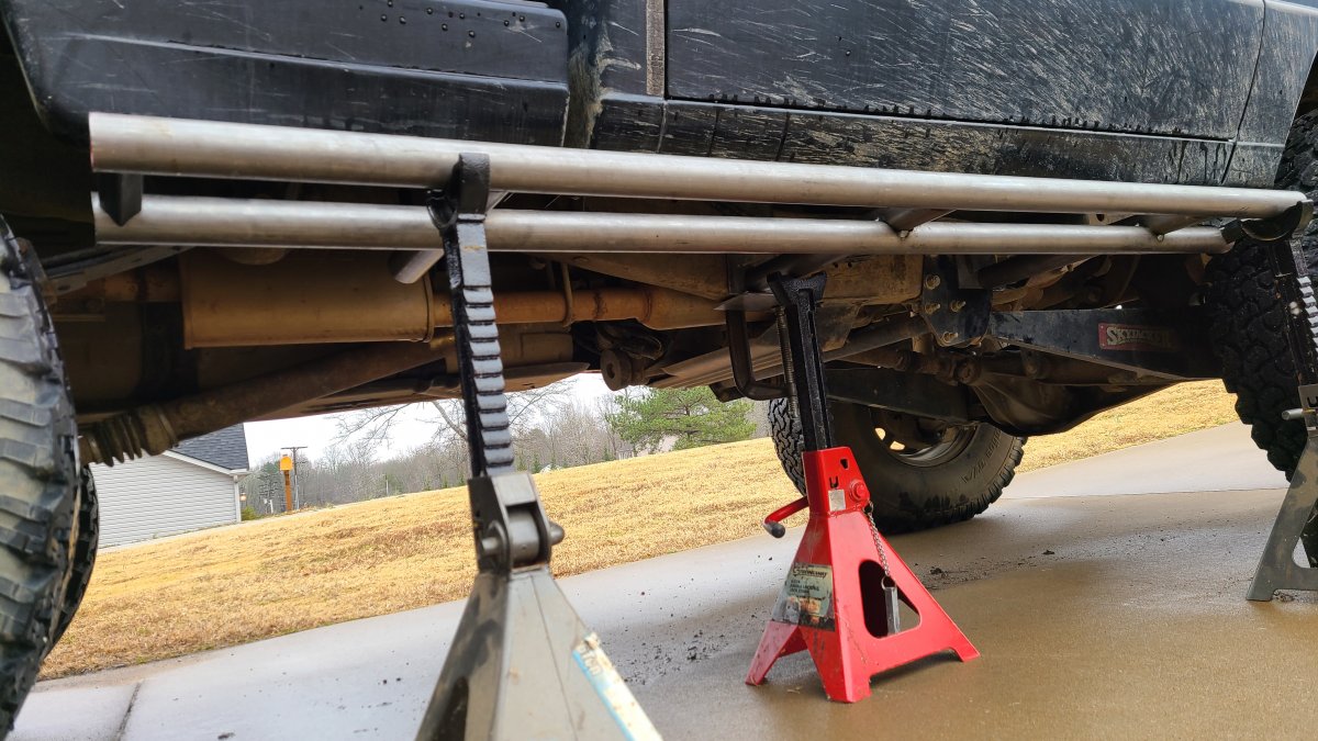

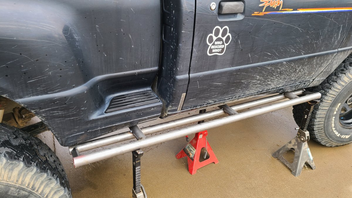

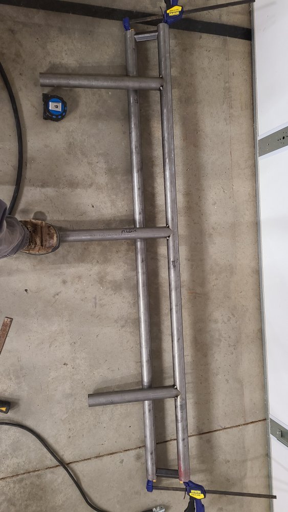

I have all my pieces cut/notched. My front mounting bracket will share a hole with a body mount bracket. So I got that rivet knocked out on one side. Then I decided to do some mock-up and finalize the positions for the mounting legs. About the time I finished that, it started snowing on me. So I pulled everything inside and tacked the mounting legs onto the outer rails. I will have 2 rails, similar to other designs. Here is a photo of the second rail clamped in place. I'm going to notch it half way through where it meets the mounting legs. So it will join with sort of a saddle joint. Should be strong and look cool. You might see that tomorrow since it us supposed to rain and I won't be able to work outside drilling holes in the frame. By the way. The rear mounting leg is short because it has to do a dog leg up to the frame. That's why the 45 degree fancy stuff in the photo above.
1993 Splash in SC
I like how the support legs sit on the inner pipe. Good bracing and clean for stuff dragging underneath.

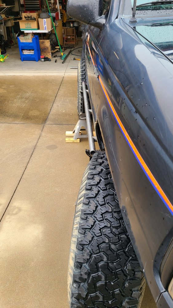

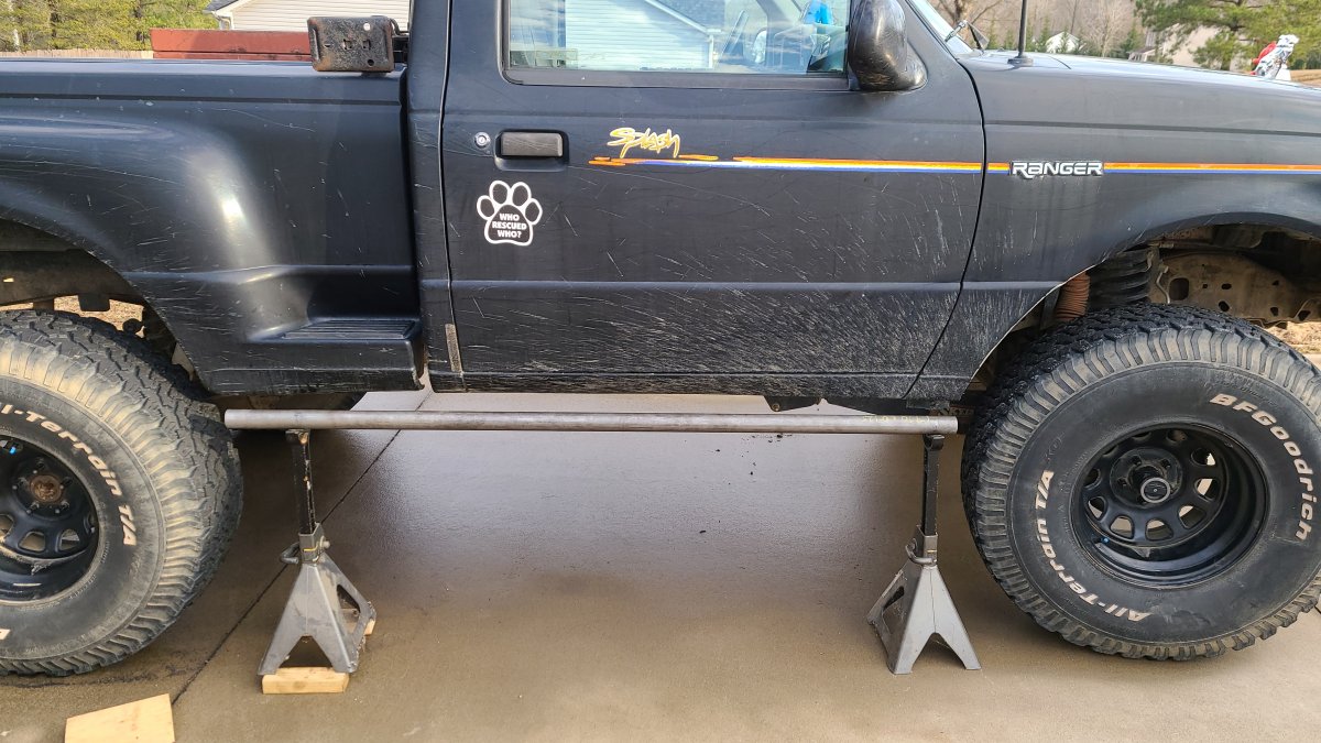

Got a bit more done today. I cut the side notches on the lower tube. Cutting is easy. Getting them lined up in the right place is tricky. I had to readjust and now there are a couple wide gaps to fill. Hopefully the driver side will turn out better. I like the overall look.

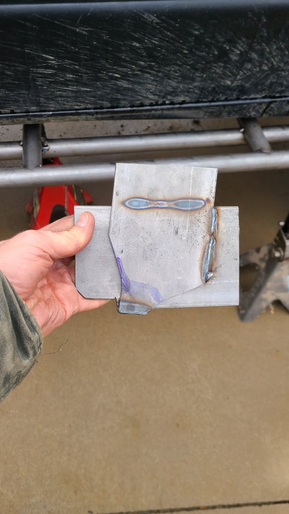

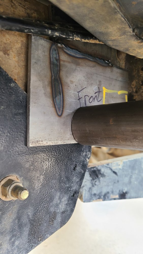

Front bracket needed a filler plate behind it, so I made this.
1993 Splash in SC

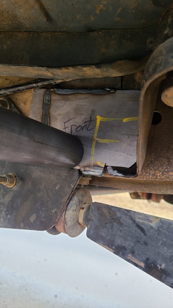

It fits here.
1993 Splash in SC
Like this.
1993 Splash in SC
The whole thing will shift forward about an inch after I grind a bit off the bottom of the front fender.

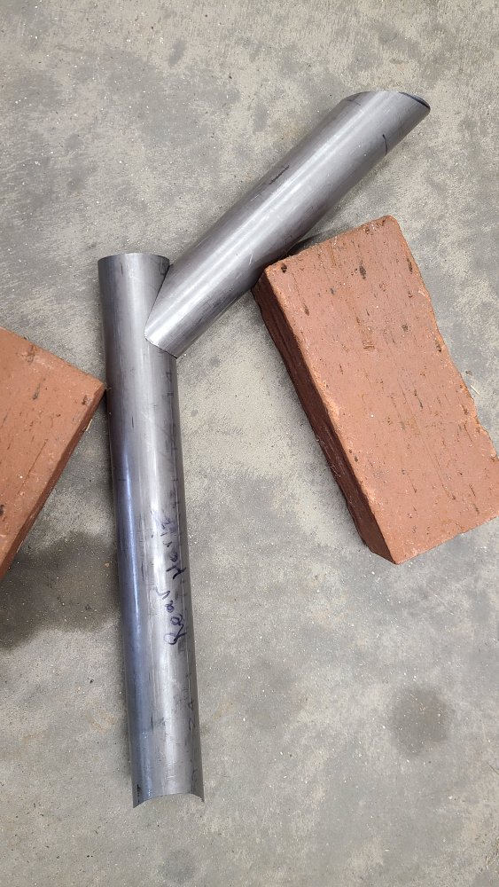

Rear bracket will look something like this
