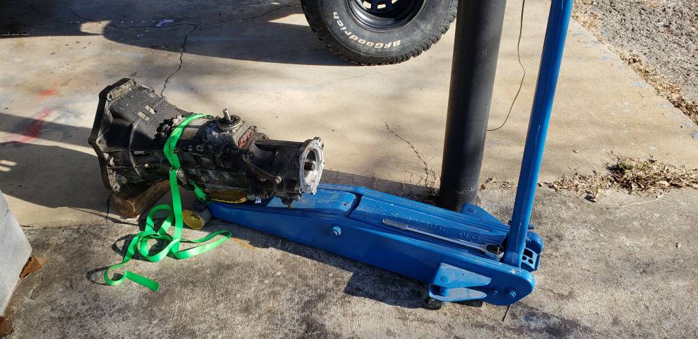

Oh, why didn't anyone tell me there is absolutely no way I could do a clutch job in one day by myself? Other than taking a lot of time, it's going well. Everything is out, the new rear main seal is installed, flywheeel is bolted on waiting for me to find the torque specs, new slave cylinder and throwout bearing are bolted in and I did a quick, rough cleanup of the transmission. Twenty minutes on the lathe was well spent making a "hydraulic plunger" for removing the pilot bearing. It popped out in about 20 seconds.

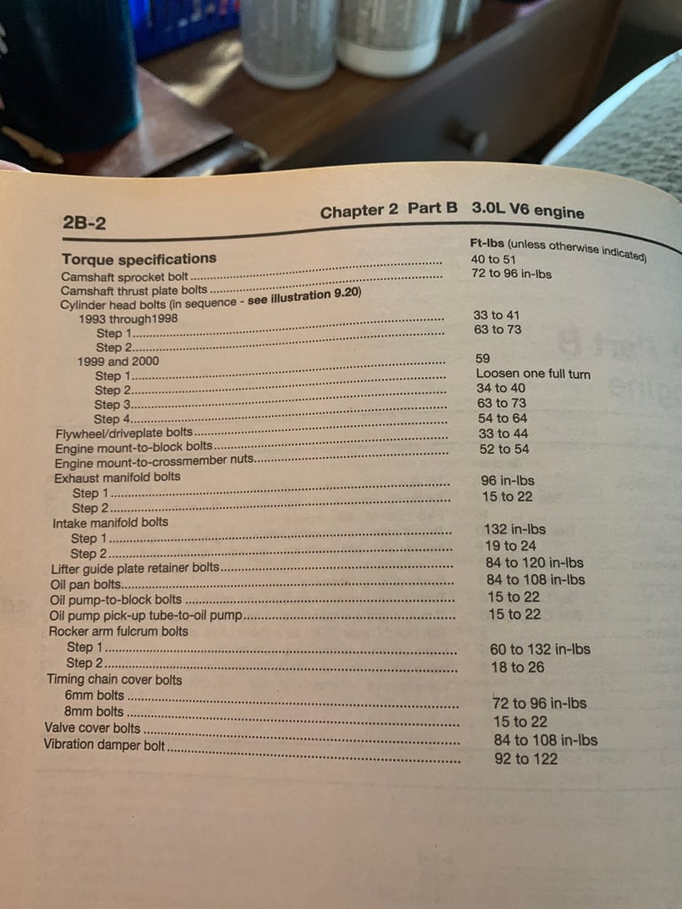

Eric,
Looked in my Haynes manual and found these specs. Let me know if they are what you need.
Yes. Everything I need is in those pictures. That helped a lot.
Thank you. Thank you!

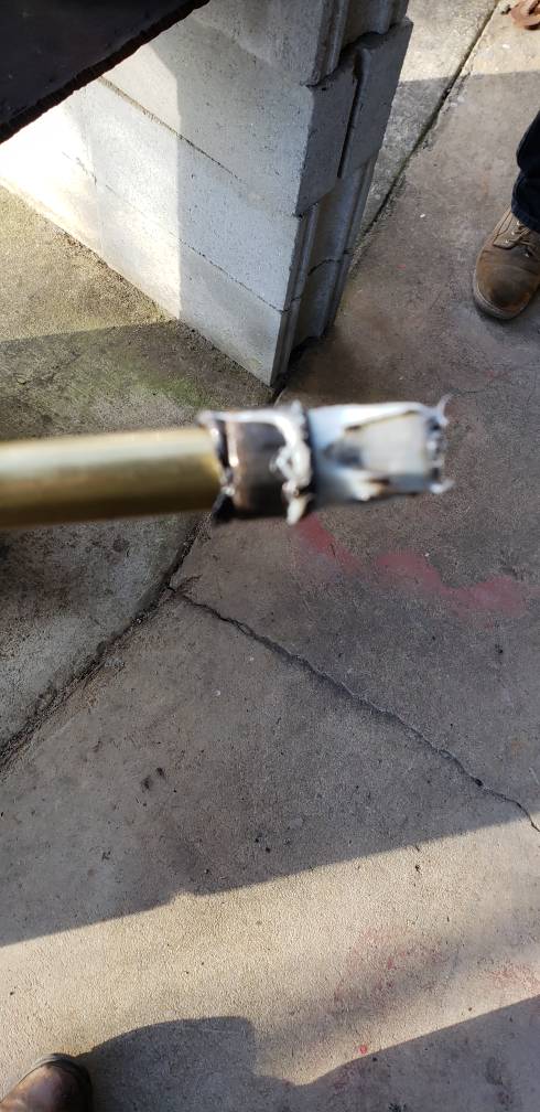

2. The hydraulic method of removing the pilot bearing worked well for me. I had piece of 5/8" brass rod that I use as a punch. Turned it down to 0.59" for a length at least double the length of the bearing. Pack the old bearing and cavity with grease. Stick the tool in and hit it with a hammer a couple times. Voila! The bearing is out. Photos below.

The grease trick is slick. :icon_rofl:
I usually use a small tree branch if I have nothing on hand. Whittle it to approximately the right size and go to town.
Wooden dowel is a good idea. Cheap and easy to shape. Could probably put a piece in a drill press and machine it down to size with a file or rasp.

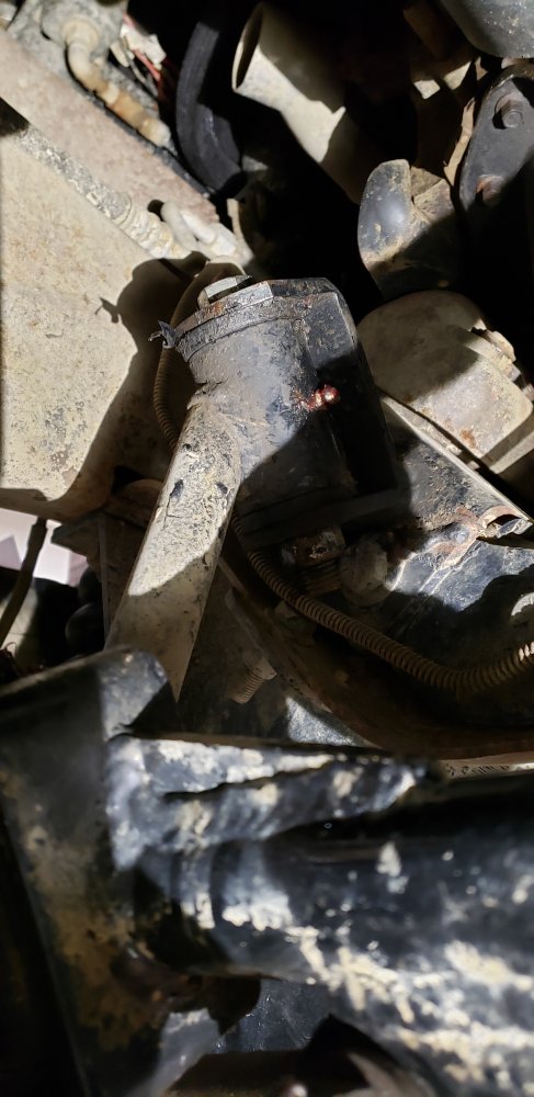

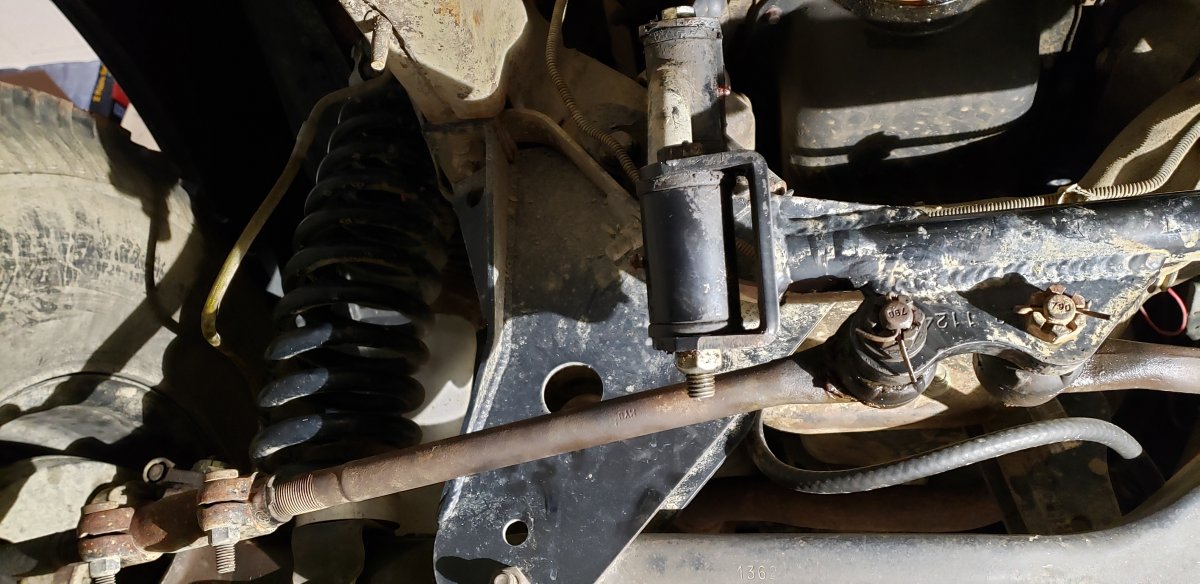

Made the same "wiggle check" to see if everything was tight on this side. "clunk, clunk, clunk, clunk" Uh-oh. what's that play coming from? Ball joints at the wheel all seemed fine. Found play in the tie rod ball jont where it attaches to the traverse bar of the Super-runner K-link steering setup. The stud was loose in the hole on the traverse arm. I remember having trouble tightening one of these when I first installed the kit. But I thought I had gotten it tight. Obviously, I was mistaken. So I took it apart, cleaned the grease out of the hole and off the ball joint stud, re-assembled and tried to tighten it. No go. I tried putting pressure on the tie rod to keep the joint from spinning. Still wouldn't tighten no matter what I tried. Well, I wanted to do some other things that day. So I went on to do my alignment and took the truck for a test drive. The alignment was terrible. Drive-able but sloppy and dangerous. I gave up for the day.
Today, I did some checking. What I found is that the tapered hole in the traverse bar had been tapered too deep. Photos below. You can see that the stud sticks through further than the one for the driver side. In fact, the castle nut goes so far that it almost clears the cotter pin hole. in another photo, you can see the end of the taper protruding on the nut side of the traverse bar when I squeeze all the play out of it. There is a flat washer that goes on behind the nut. I could probably drill a bigger hole in the washer so it clears the taper and that might let me tighten the nut properly, But that will also put the ball joint closer to the back side of the traverse bar and limit it's rotational travel when everything moves and flexes while driving. That might be a temporary fix.
So, I think my plan is to build new tie rods using DOM tubing and heim joints. That way I'm dealing with straight through holes where things join together. I also want to modify the bottom of the traverse bar where the tie rods connect. I will probably weld another piece of steel on to it so that my mounting holes are lower. That will help put the tie rods more in-line with their mounting points on the steering knuckles. My mods will loosely combine some hints from the article about this in our steering "How To Tech" articles and the mods that BlackbII did when he created his own K-link steering setup from scratch. Eventually, I want to replace the poly bushings in the idler arm with bearings since I am also noticing wear/play in those bushings.

Here you can see the tie rod ball joint stud protruding more for the driver side (right side - the photo is upside down)
overall view of the passenger side
Tapered part of ball joint stud protruding way too far.
traverse bar idler arm. bushings in upper end have excessive play
Lowering the mounting point of the tie rods on the center link is a good idea; it'll get the tie rods more inline with the axle beams. Using heim joints is a good idea because it allows you to use regular holes and bolts, but when it's on a steering application making them double shear is a good idea, which complicates things a bit. I used "GM 1 ton" tie rod ends on mine as they are readily available and should last forever.
