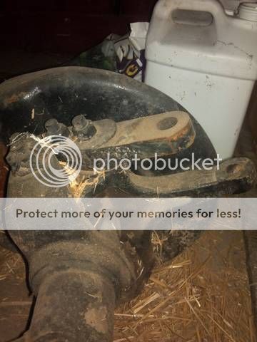

Well I scored a complete Chevy Dana 44 off craigslist today. BOTH knuckles are drilled/tapped and come with new High Steer arms. Got it for $150. There's easily $200 worth of parts on this axle. Comes with a L/S and 4.10's.
Here's some pics of the axle I'm picking up tomorrow for $150

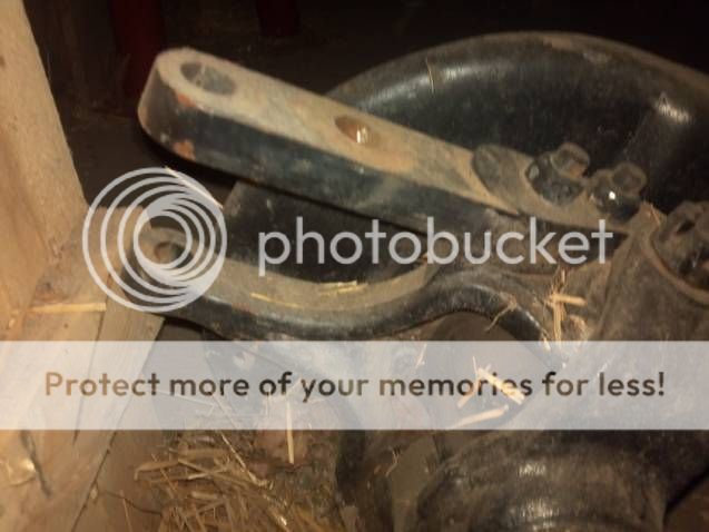

So I went and picked up the chevy axle today. It was in excellent shape! Both knuckles are flat top and drilled/tapped WITH Sky-manufacturing High steer arms. Both caliper brackets are in good shape, as well as the spindles and stub shafts. For $150, it was a steal and only 1/2 hour away from the house. Well worth the drive. I'm not sure what knuckle I have on the driver side though. It should have 36520 stamped into it and drilled/tapped from the factory. It doesnt but is drilled/tapped...I'll have to do some more research.
