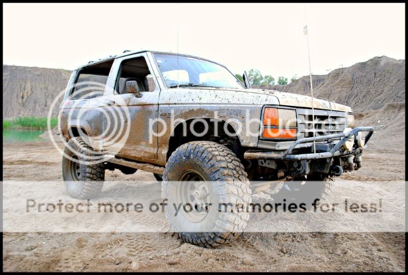

Thanks dude! Looks great. How much lift did you achieve with the 6" coils on the BII and 5.0L?
This is how it sat with 4" RBV Skyjacker Softride leafs and Belltech shackles in rear and the XJ 6" coils up front.No bodylift and on 35's. Never really measured it tho.
1993 Splash build
So about 6 inches of lift. Very nice! Thanks again. Since I have a BL, Im sticking with 4" suspension so it doesnt sit too high.
