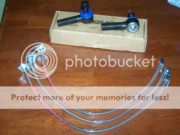

More goodies in the mail today. Stainless braided brake hoses and true 1 ton t.r.e.'s. The brake hoses come with weld or bolt on relocation brackets.
nice, do you have a reamer for those tres?
Looking good!! U got one hell of a deal on that shaft
Nope. I stupidly sold it to a member on here bc I never thought I'd need it lol. SO, I'll just use my 7/8" reamer and use RuffStuff's inserts.

Where'd you get the brake hoses at and how much did they set you back?
SVT
Rough Country. They were $75 for the set. DOT approved as well. They're actually for a Jeep Cherokee.

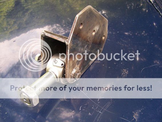

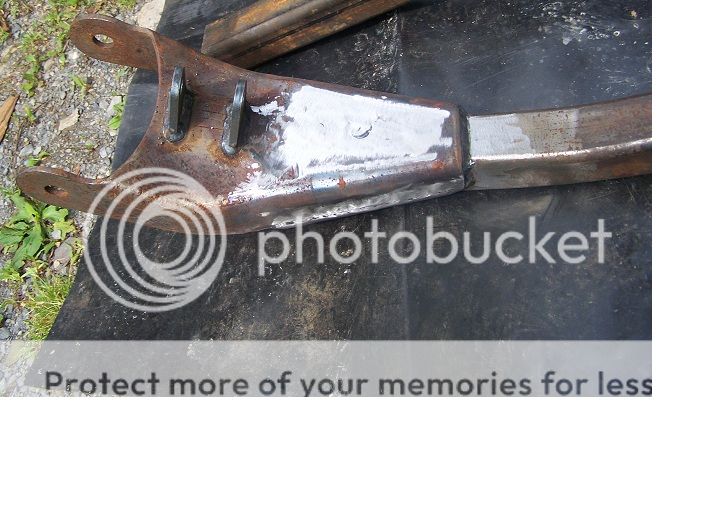

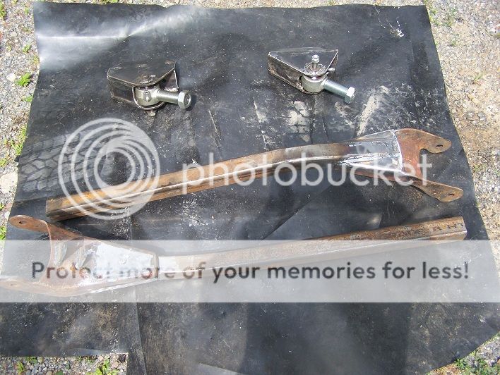

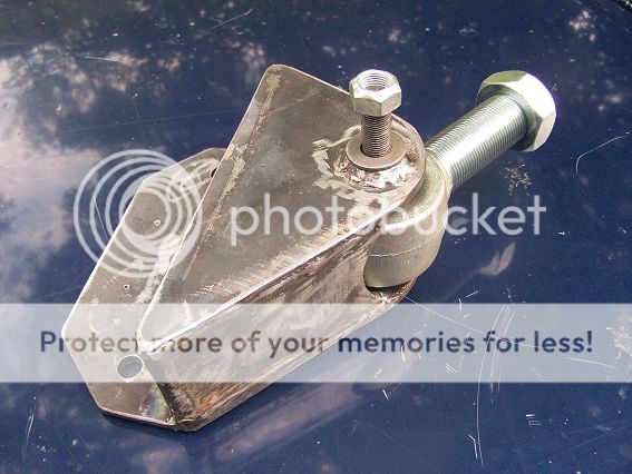

Yea buddy! Progress!!! I also changed the lower shock mount from the stud mount to a through bolt. I think it's stonger. Also welded a 1/4" thick washer for reinforcement on the ballistic joint mount. Had to modify the bracket to accept the 2-5/8" joints as the dipshits didnt send me the right ones ( I ordered the 2-3/8" wide ones. )
Looking good!. About ready to do the swap?
Im shooting for the end of August to begine the swap. I should have everything ready by then.
Thanks dude. Arms turned out a lot better than expected!
