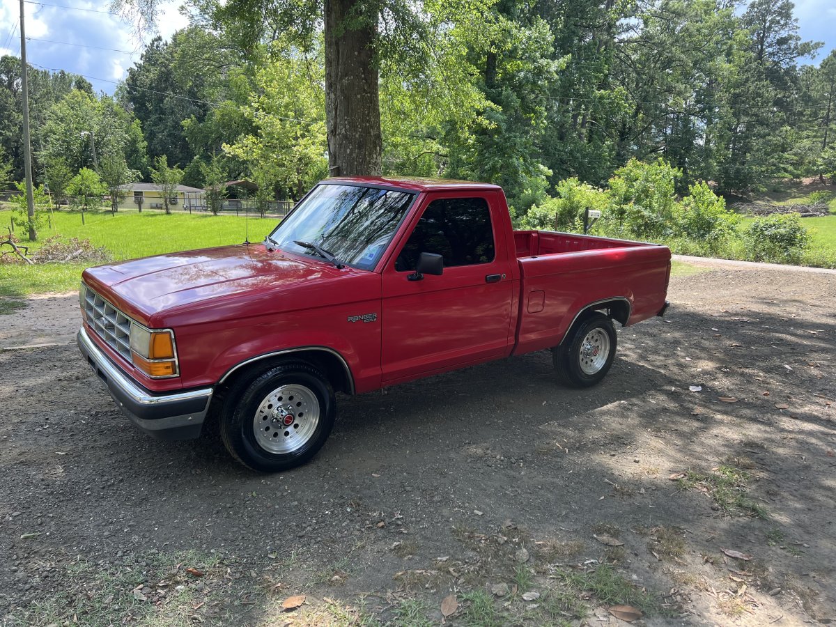

I have a 1992 Ford Ranger 2.3 5 speed standard. I’m wanting to do a engine and transmission swap. V6 or V8. It really doesn’t matter to me I just want something stouter than the baby 4 cylinder that’s currently in it. I have no idea where to even begin, what motors and transmissions will be compatible and any extras that I need to be aware of. I would love to just purchase a donor vehicle and pull everything and swap it over. Any advice will be helpful, and what donor vehicles I can buy for the swap.
1992 Ford Ranger 2.3 Engine Swap Recommendations
Nice looking RED Ranger (y)

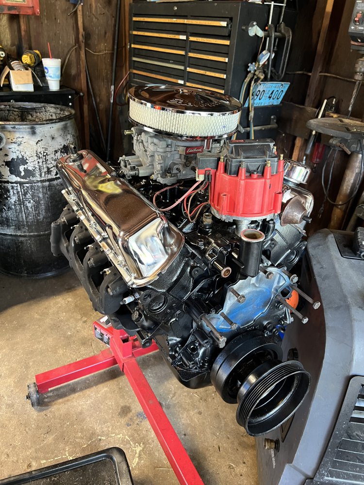

Update on the Ranger swap. I’ve found a 1970’s carbureted rebuilt 302 motor for a great deal so I picked that up. Now I’m needing any information I can get on compatible manual transmissions. The ranger is currently a 1992 2.8 L 5 speed manual and I want to go back with manual. Any help is appreciated!

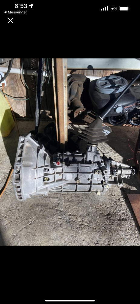

I found one out of an 06 F150 v6 5 speed, but he doesn’t remember was liter engine was in the truck.

Will this transmission work with my setup? He’s suppose to be sending a picture of the bell housing.
Yes, it will if its from a 4.2l engine, 1997 to 2008
But no speedometer hook up

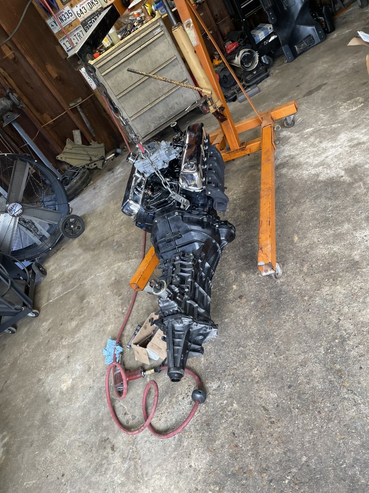

I’m needing more in detail help on what anyone else has done as far as brackets/pulleys for power steering, A/C, alternator, etc. We are putting the motor in the truck this weekend. I’m wanting to retain my power steering pump from my factory 1992 2.3 L. I also want to retain my factory alternator, and a/c compressor. Does anyone have any more in depth detail on parts and brackets used? All I have found is very vague. It’s a late 70’s model 302. Serpentine drive.
