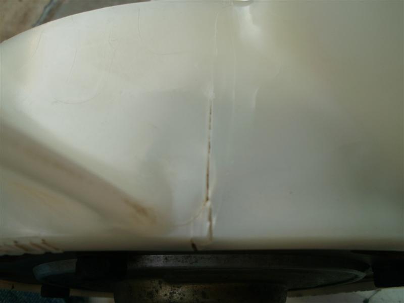

Inspect the plastic of the fan closely, between the blades. If it is cracked, get a new one. Fan is E5TZ*8600*A and is about $85 from Ford. Bolts on to the clutch which is a separate item.
