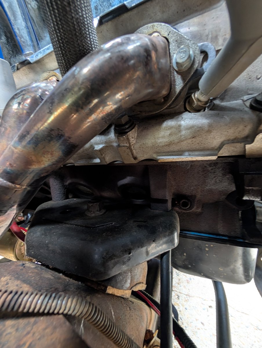

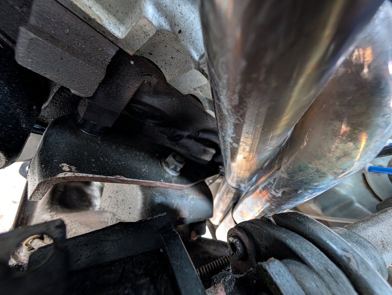

Right side header pic for @tjm73. One could probably get away with a smaller cutout. I can't remember why I made mine so big.
1990 Ranger 302 swap
Motor mount plates from donor Explorer:
(Left)
(Right)
That clearance is TIGHT. Thanks for the pics. Gives me food for thought.
Yeah, you can't remove the headers without lifting the engine. I had to put these in when I was dropping the engine for the final time.

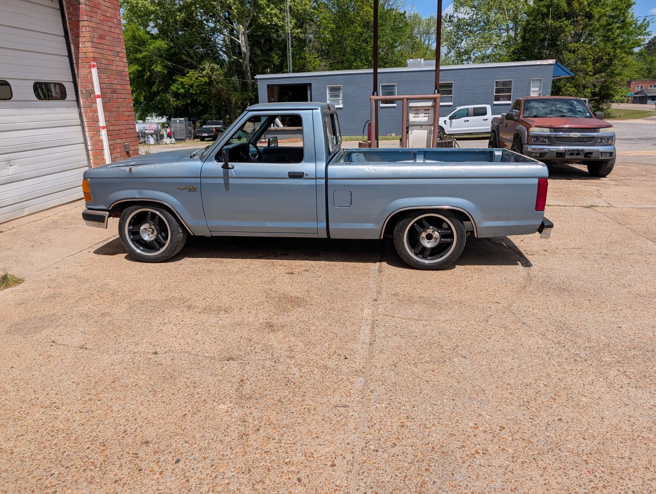

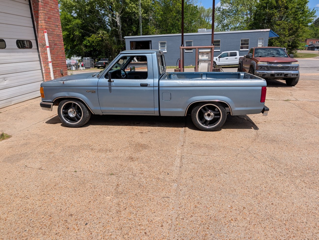

Over the last couple of weeks I've been replacing all of the suspension bushings, ball joints and steering linkage and installing a 3/5 lowering kit from Rick's Rangerz with the Doetsch shocks he offers. So far the ride isn't rough at all, but I only drove it 6 miles to the alignment shop.

I like the new altitude. Did you use the DJM beams up front? Are the front wheels centered in the wheel opening or are they biased to the rear a little bit. You are basically building the truck I am about to start building.

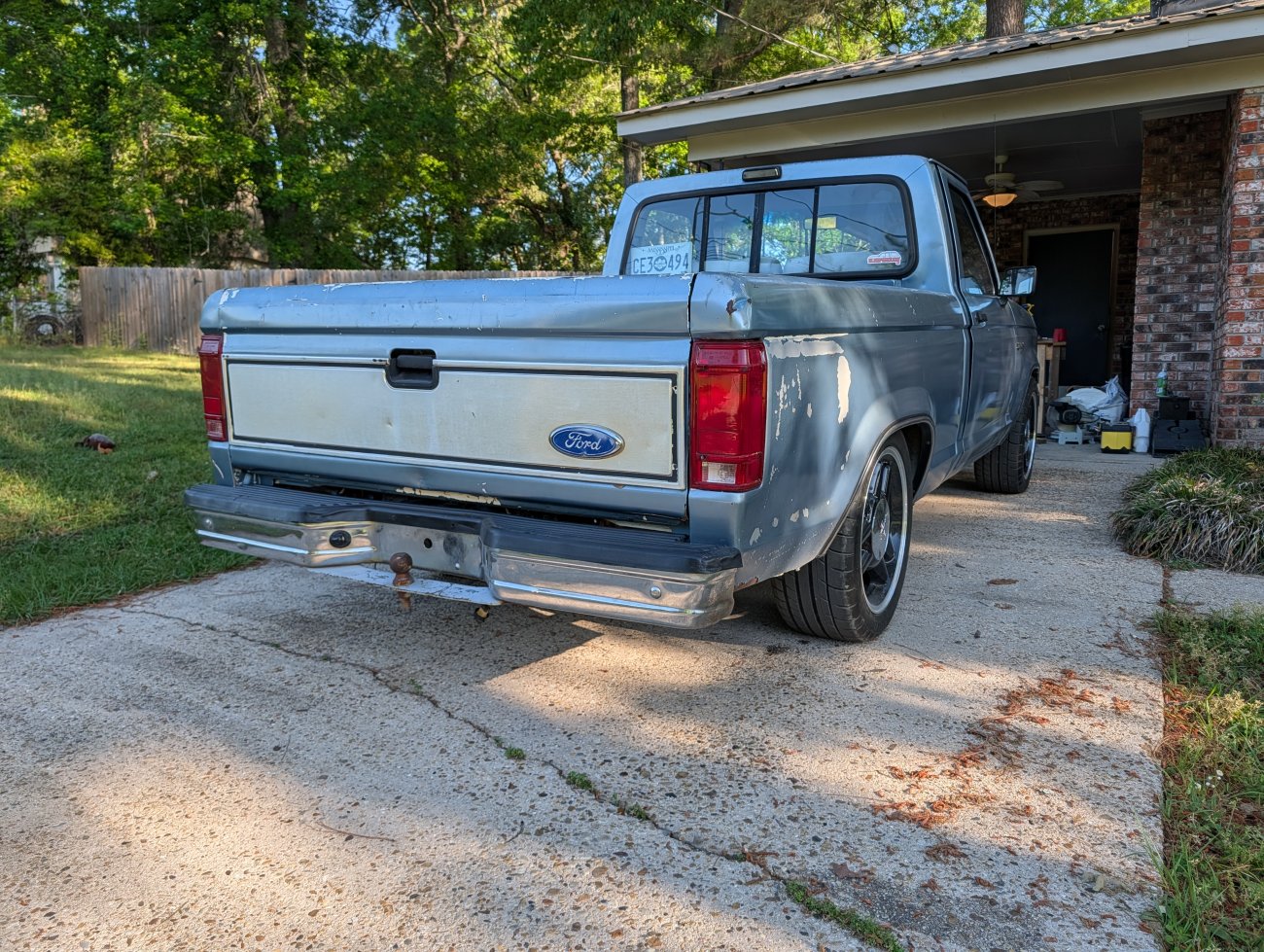

Are you running a 94-11 rear bumper? I bought one to put on my '89.

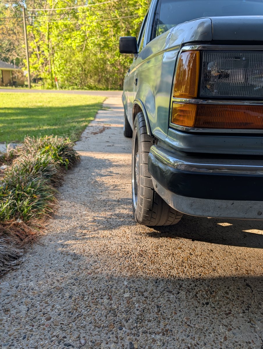

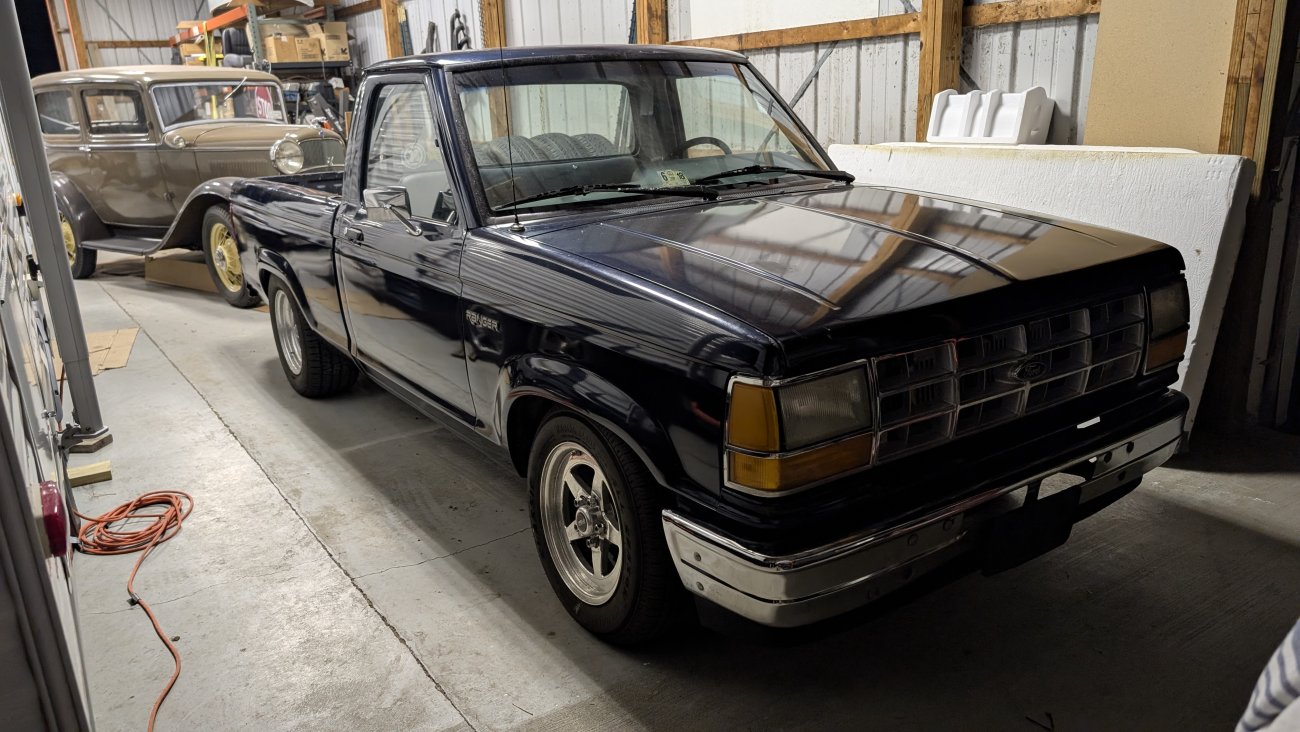

This is my truck. It's been lowered with just coils by a previous owner. I have to undo that and redo it right. Other than my wheels & tires and the lowering it has it's a completely stock survivor.

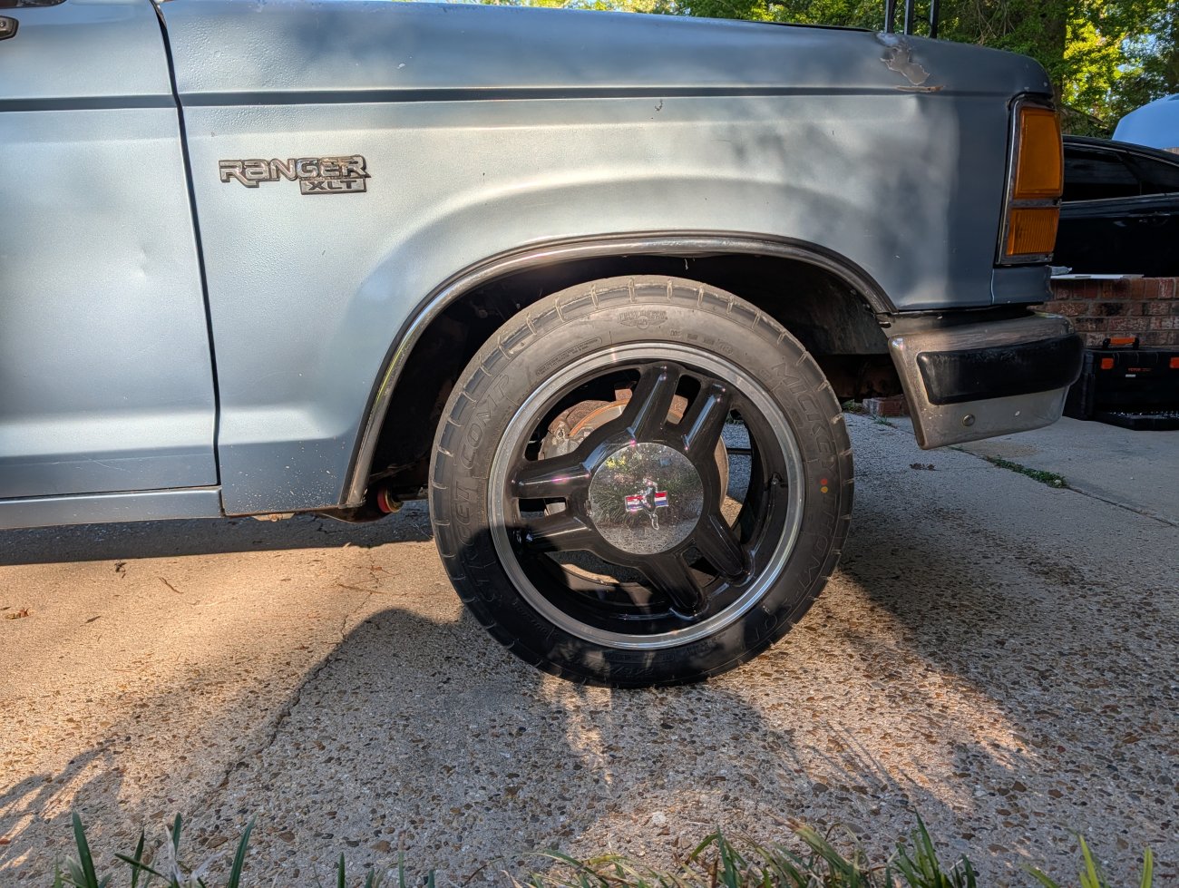

I went the cheap route and used 3" drop springs. The side that is aligned (shop didn't know about the dual adjustable bushings and didn't get the driver's side straight) doesn't look like the wheel is pulled back in the well too much. I'm going back to the shop tomorrow to get the driver's side worked out.

After the partial alignment and driving 60 miles, the suspension is pretty sporty. As in it feels like what you would think a track car rides like. It isn't harsh but definitely a lot firmer than stock. Plus the driver's side tire rubs the top of the fender over the rougher bumps. Most of the roughness is in the rear though. My truck has 4 leafs total in the stack, so maybe a 3-leaf stack would soften that up. Another option is to research stock-quality shocks in the shorter length.
The rear bumper on mine is still stock. There is an 89 at my local junkyard that has bumpers that are still in great condition. I'm also debating a roll pan in the future. I kinda want to make this a 90s style mini truck without slamming it to the ground. The 3/5 is as low as I want to go.

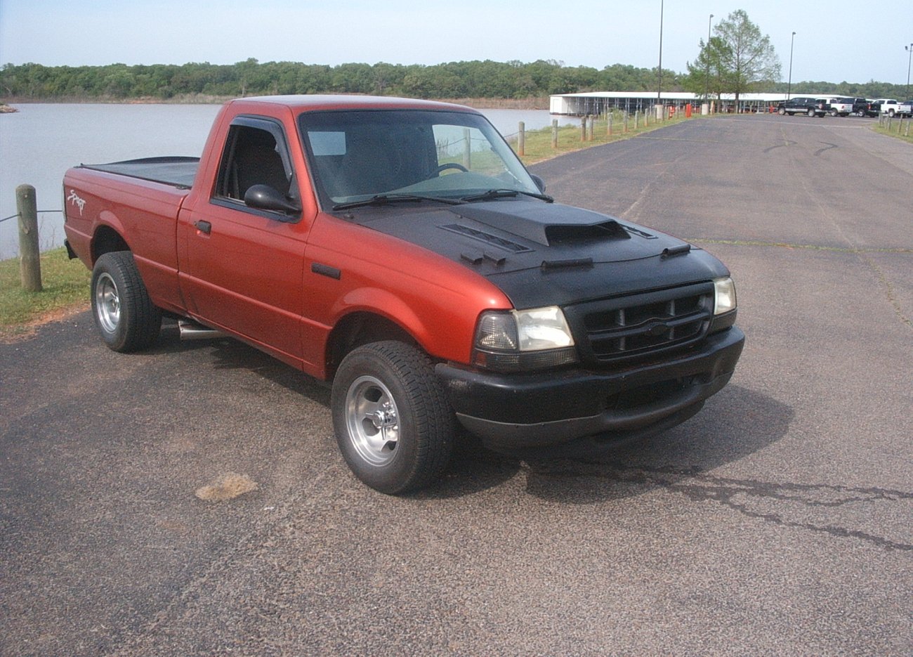

Ya'll want to get your under hood temps in check, install hood vents. I put these on mine way back in 2015. You oughta feel the heat that blows out of them, just idling with a clutch fan. One fine winter day, after a large storm, there was plugs of snow in them. Left them in there and went for a drive. Along about 45 mph, all the sudden, all ten of them blasted out and smacked into the windshield, without touching the hood. That's a lot of pressure.
I see I need to get new pics. These are the old four slot vents. I now have five slot carbon fiber vents on it. The two little scoops are directly over the large cone filter. The hood scoop has 25 two inch holes under it. Especially in the winter, I can go for a drive around my favorite curvy road, stop, and everything under the hood is barely warm. Oh, the hood bra has those two things that stick up. They make the hood vents work even better. They spoil the air flow over the vents so they don't have to pass through smooth airflow. Saw a wind tunnel vid on hood vents once. Showed how spoiling the airflow over them makes them more effective.
Here are the vents, pricey, but expected for carbon fiber. https://www.importimageracing.com/p...jqnHY44anU--NNHa5p0ZuB-rwGRhf39kVhTaMUOe8n2jv
I made a sheet metal template, taped it to the hood, marked the hood with a sharpy, cut the holes with a cutting wheel and rotary files.

These are just thoughts right now. My main problem with the suspension is the front tires rubbing. When I was shopping for wheels I also looked at a set of Crown Vic Interceptor wheels. They're 17x7.5's with +44.5 offset. That should bring the outside in by 3/4" and the inside only moves 5/16" inward from what I have now (17x8 +30). They're also cheap enough that I could get 2 and try them out.
