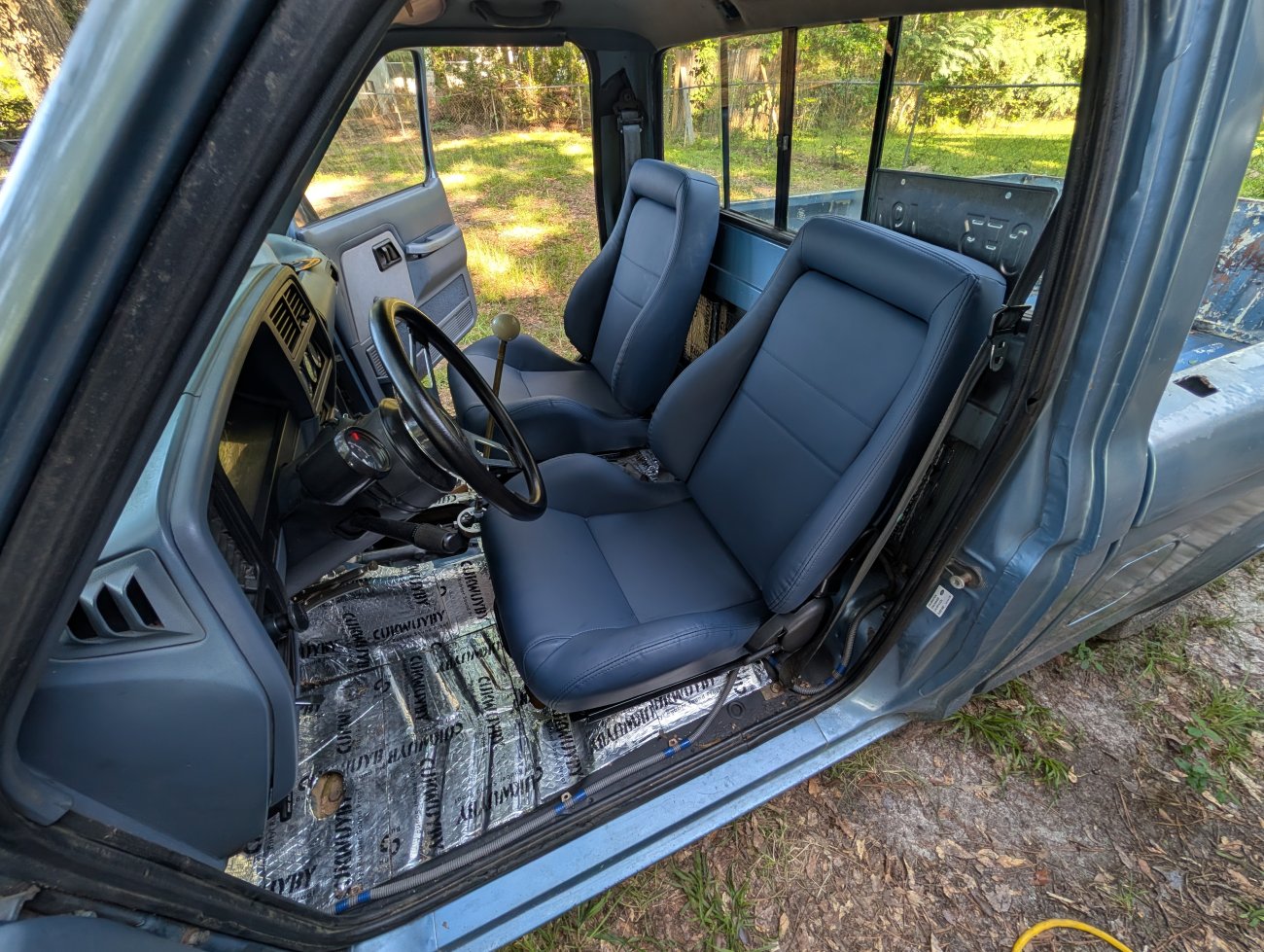

Figured I'd post an update since I'm doing something to the truck.

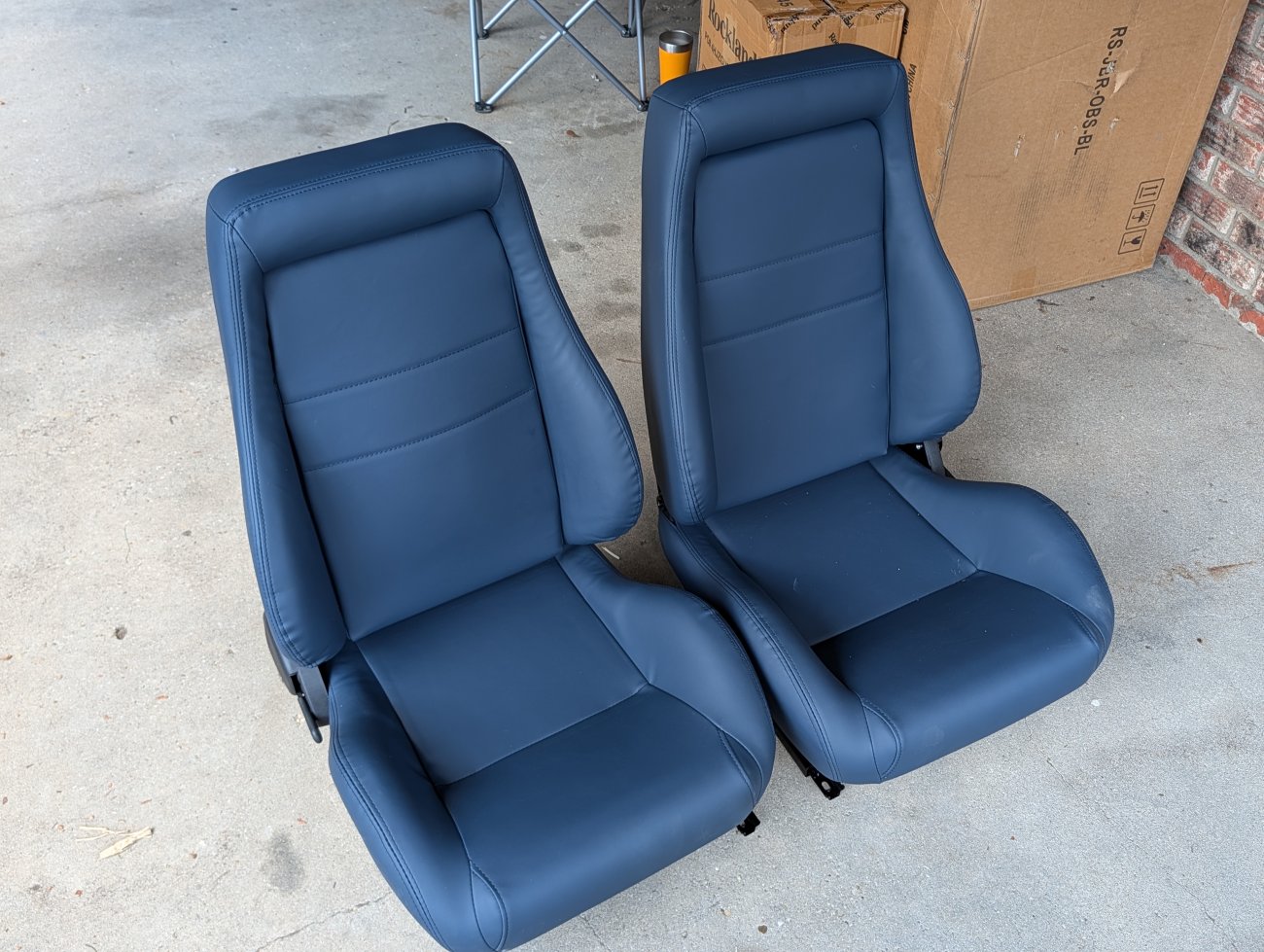

I got bored and decided to work on the floor pan and in the process found some low back buckets on Amazon for a somewhere around $350.

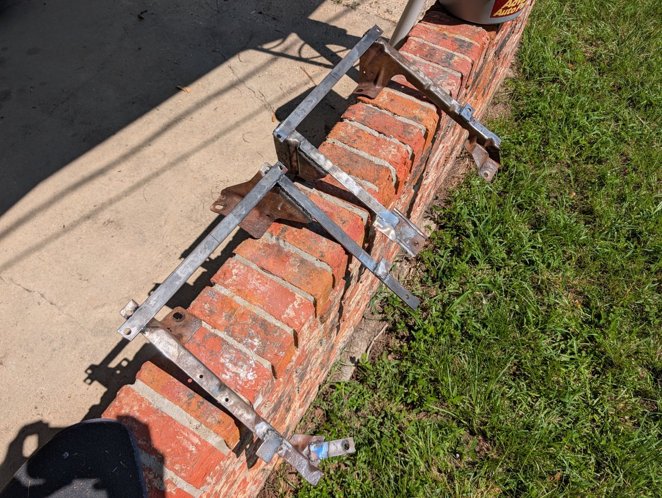

Here are some pics of where I'm at so far. I'm in the middle of modifying the original seat brackets to fit the new ones. Welding for the first time with a 120v flux core my dad had laying around.

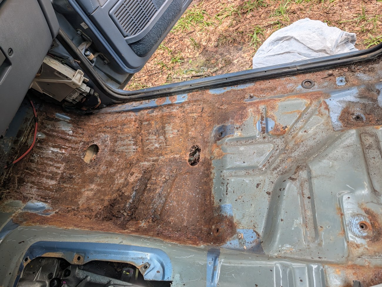

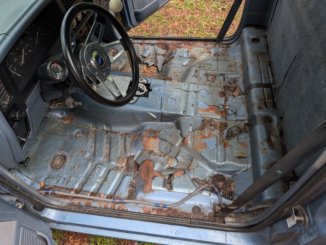

Before stripping the old sound deadener:
After deadener removal:

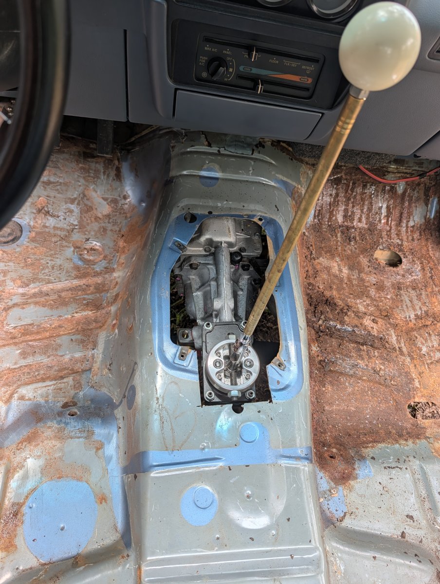

Shot of T5 shifter position:

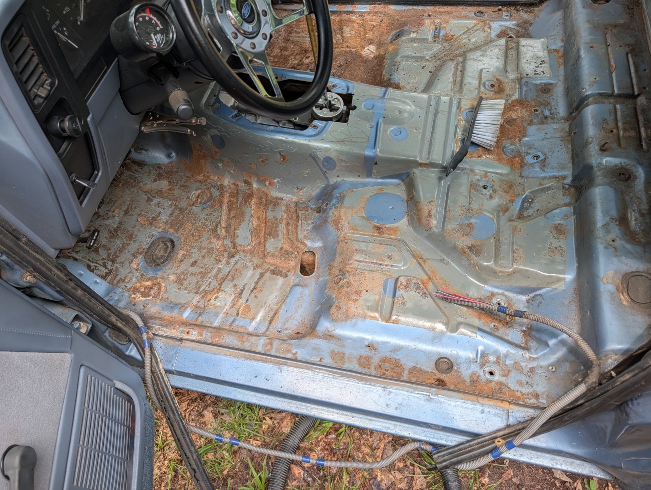

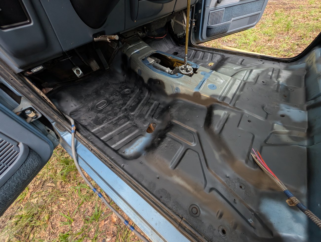

Wire brushed rust:

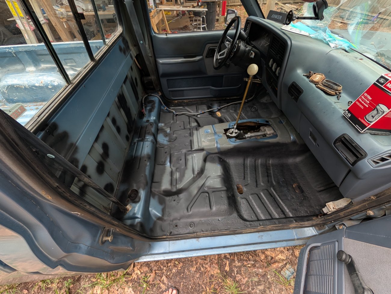

Rust-Oleum Rust Reformer:

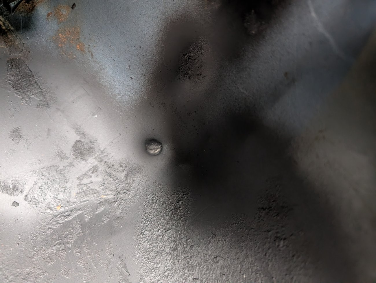

Finally, here's a shot of the bleeder on the clutch slave self-clearancing the floor pan. 😅
Just bench bleed your hydraulic clutch system and you'll never need this valve again. 😄

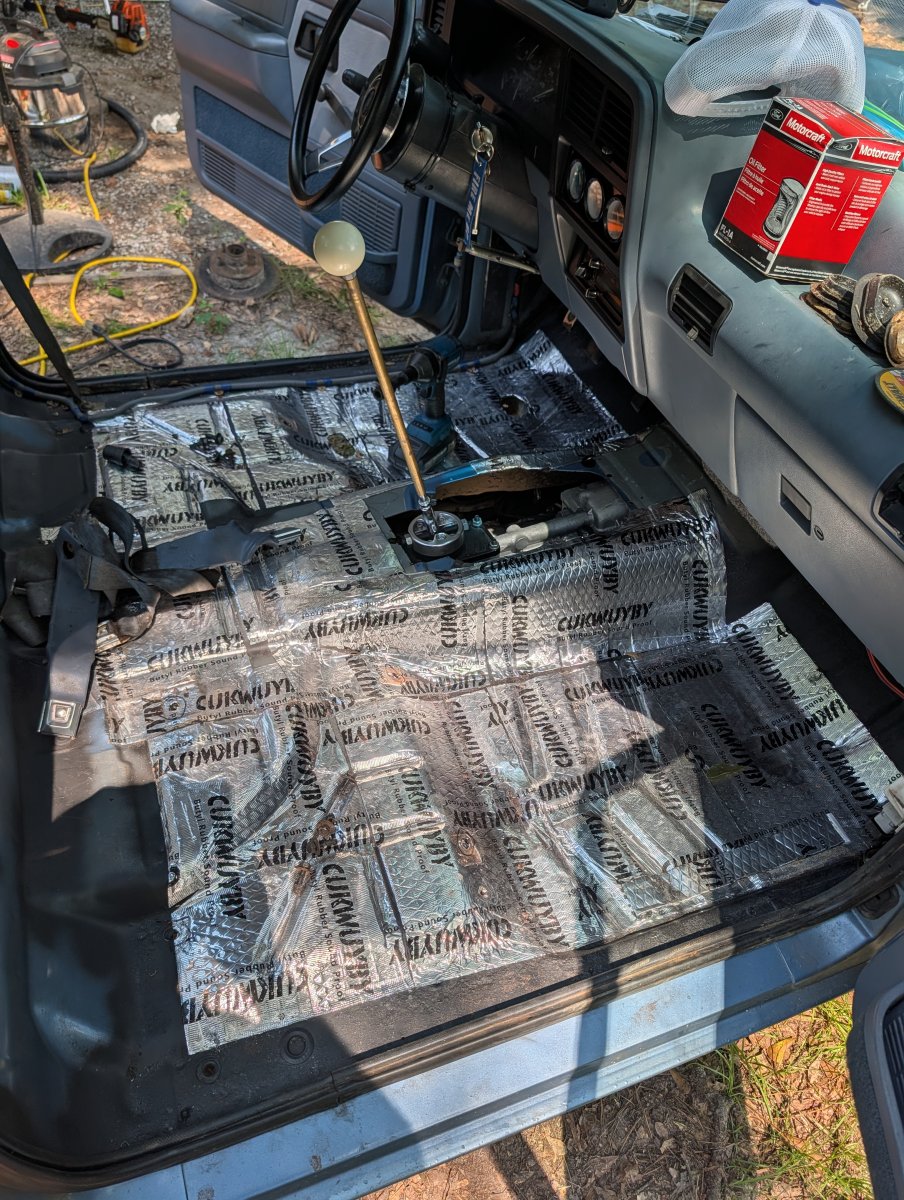

New sound deadener:
I still have a few spots to cover, like in front of the shifter. Not sure if I should go all the way to the back wall.
Seat brackets almost done:
Don't look at my boogers! 🫣 The welds got a little better towards the end. Parts of the driver's side bracket were rusted so bad they practically fell off. Towards the end, I realized that I could've gotten away with just welding tabs to widen the parts where the seat sliders would bolt up.

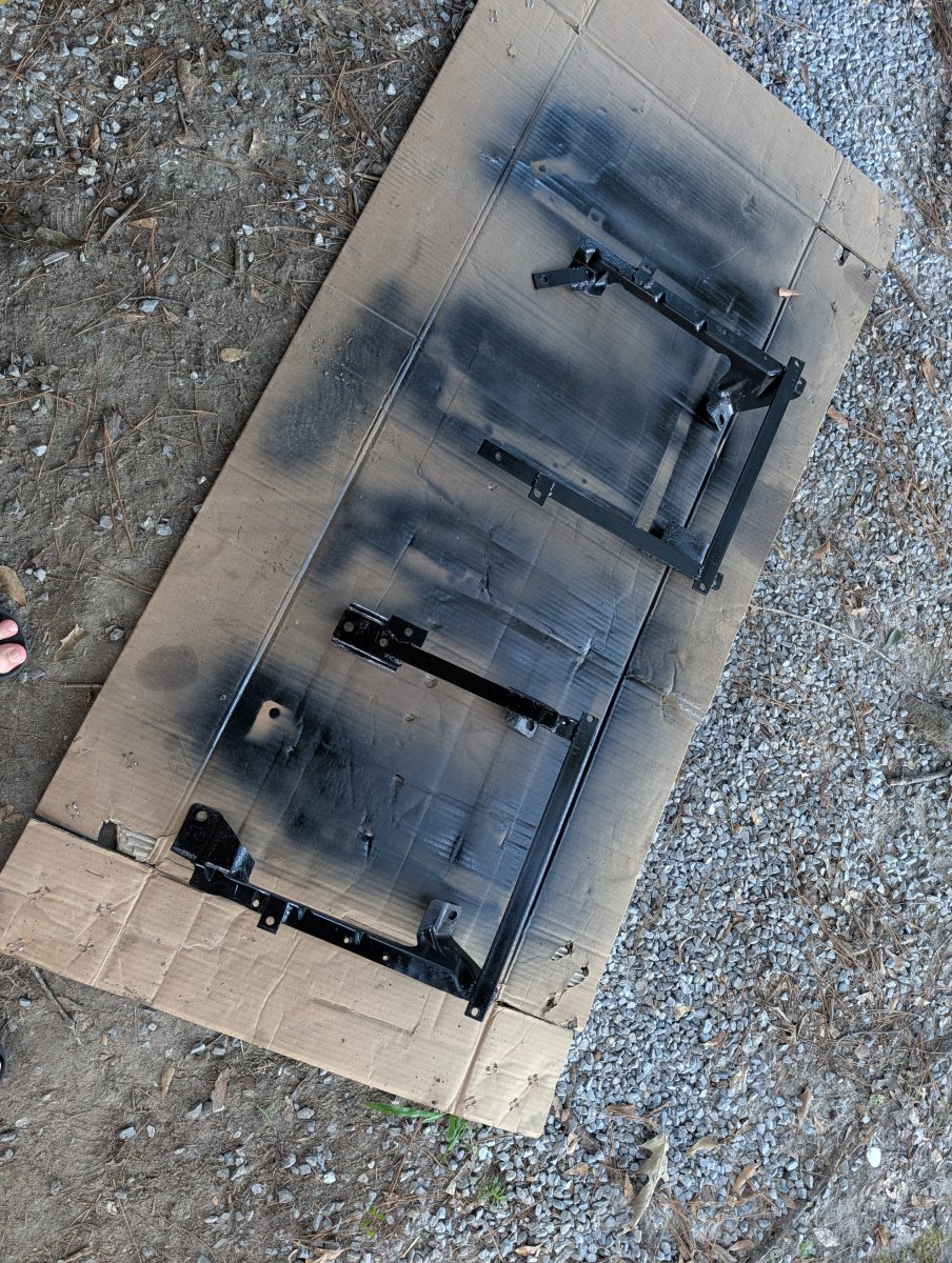

I just have to drill 3 more holes and paint the brackets and we'll be cruising again!

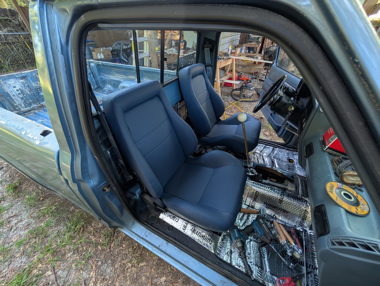

Got the seats put in this morning! I'm really happy how the color works with the original interior. The driver's side sits a little high for my liking, but lowering it is beyond my fab skills atm. Maybe I'll try it this fall/winter.
