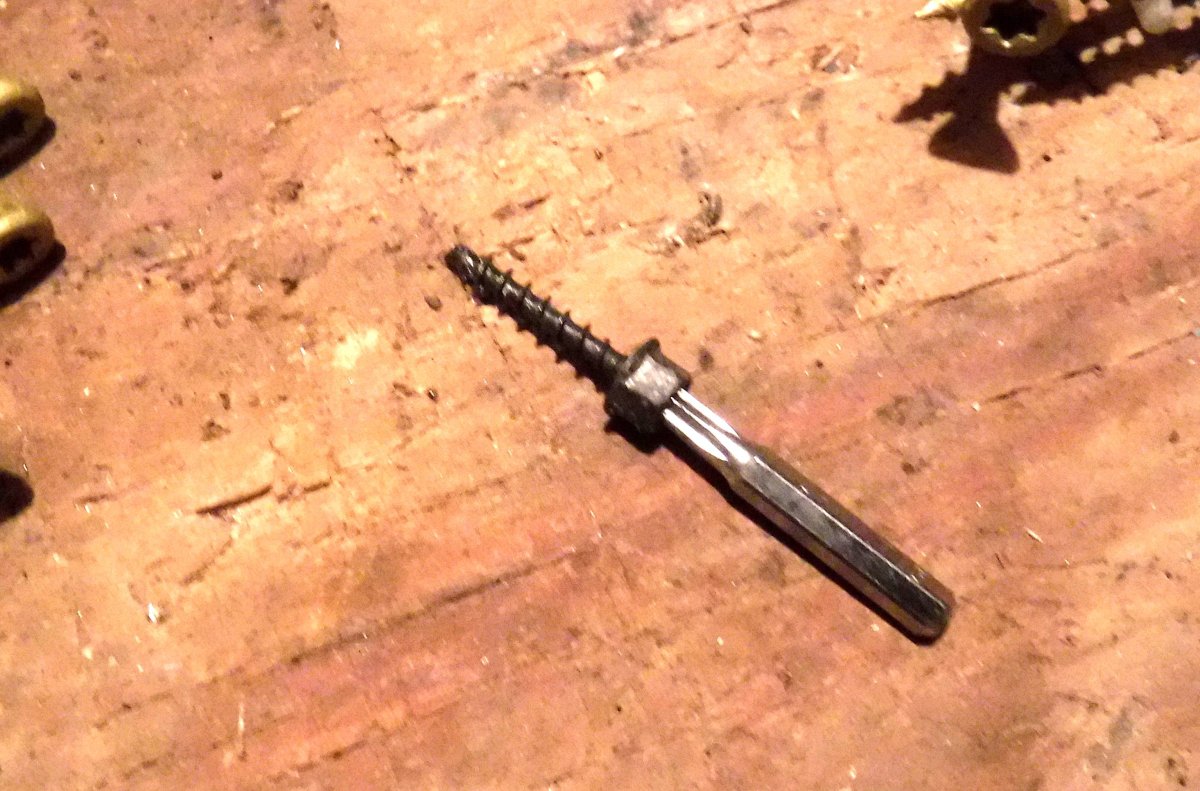

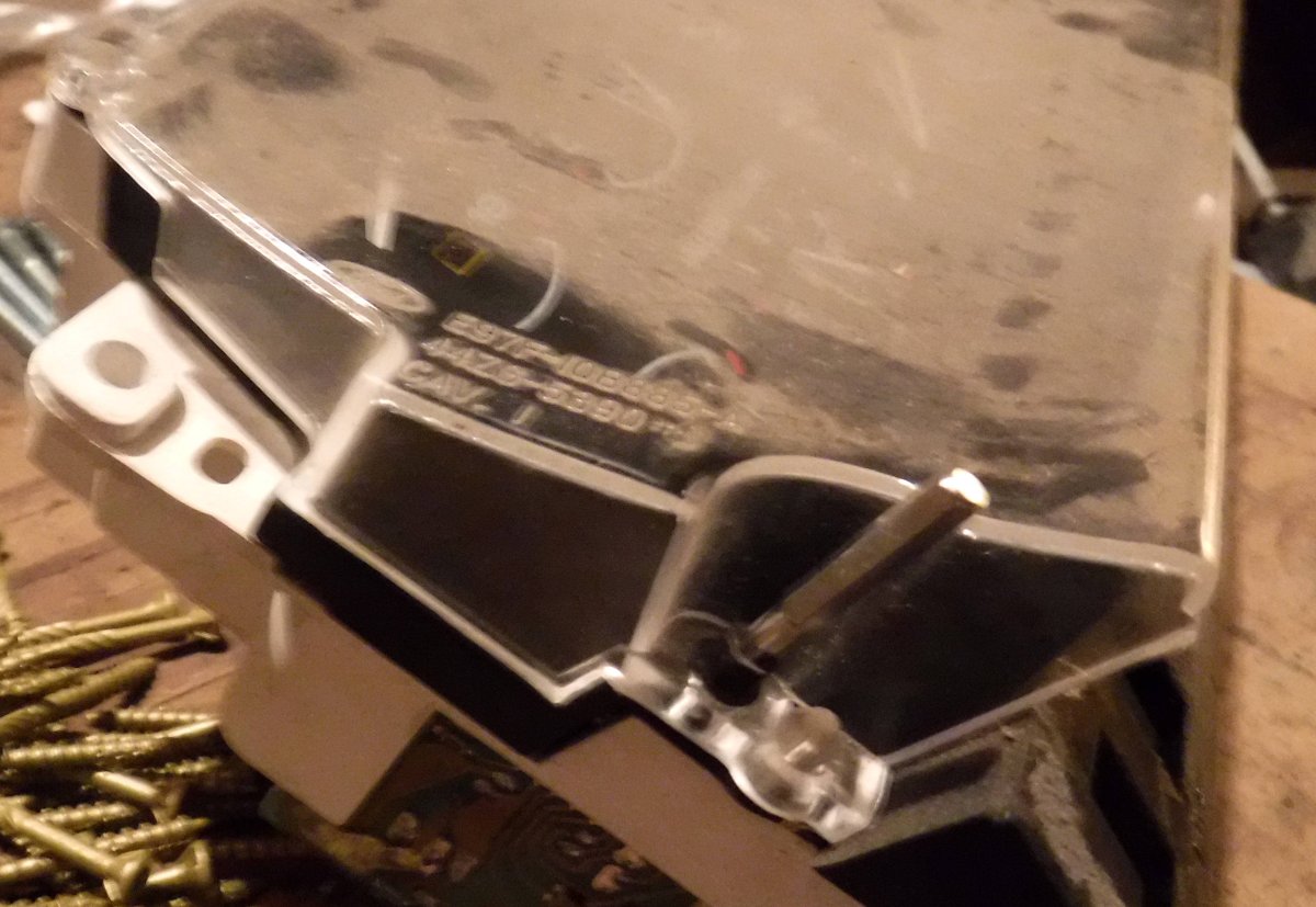

It isn't so bad taking it apart, this took me about 15 minutes which includes finding it, locating the right tools and pulling the 2 bezel layers and the gauges and taking these photos.
The worst part on mine is to disconnect that speedometer cable, I never did figure that out and always chose to let it alone.
Taking this spare out of the Mazda was no problem but yest that cable got broke, and I still haven't figured out how :)
If you tear yours down I'd get about 20 bulbs ready and just replace them
