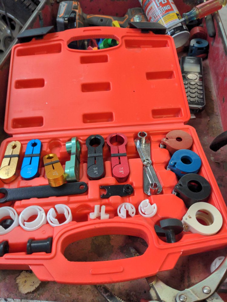

Needing some help/advice on the spring clip connectors at the fuel rail. I've popped several of these loose in the past using the disconnect tools, but I can not budge the ones on this truck. It's like none of the tools actually fit the connector. I've tried every way but the right way and was wondering if there is something different about these and what I'm doing wrong.

I will keep working at it. I was kinda looking for confirmation that I was using the right tools. I've taken many of these style couplers off in the past, some more difficult than others, but these are the worst I've ever encountered. Was wanting to make sure I wasn't missing something.

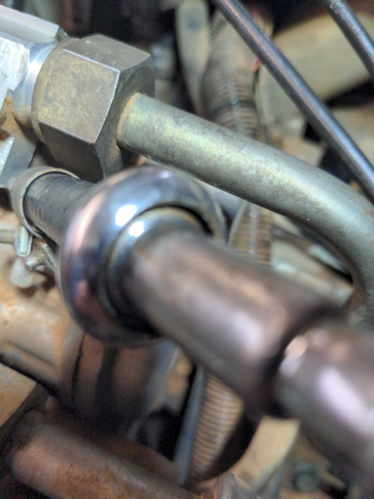

Have you already depressurized the fuel system via the schrader valve? Under pressure the fitting can bind the spring.
It can also help to push the fitting together as you work the tool to spread the spring.
And something I've done in the past for a reluctant spring-lock fitting is to take a strip of shim stock, wrap it around the tube and slide up under the spring, and then let the shim stock wanting to unwind push the spring back enough to get a release.
Some of these are just super tough.

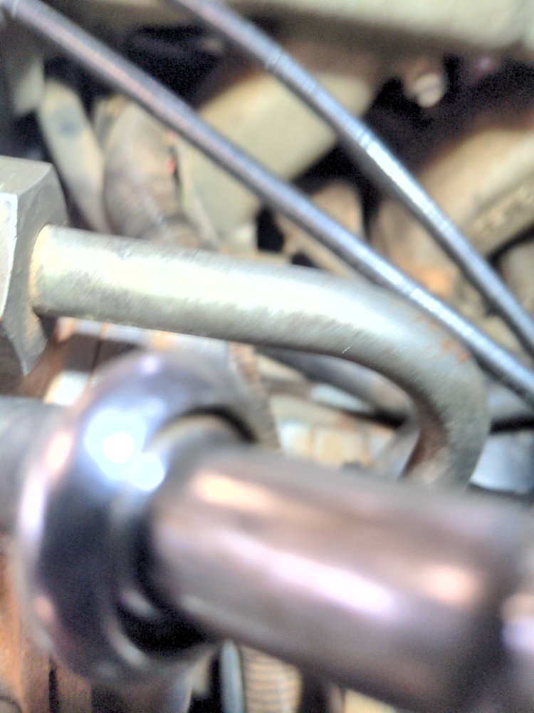

RobbieD - yes, system is depressurized. And I've pushed the fitting together working the tool. It's like the spring is behind the flared lip on the line and I can't get anything under it. I think this might be a better pic. This is why I curious if I was even using the correct tool. I have not tried the shim stock yet.
It can be frustrating, but you'll get it.
On the shim stock, about 1 1/2 to 2 wraps, wiggle it to get under the spring then let it expand. Wear gloves! (don't ask . . . )
