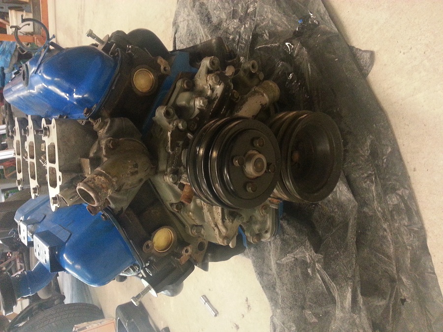

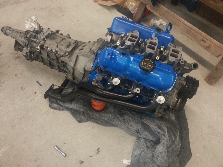

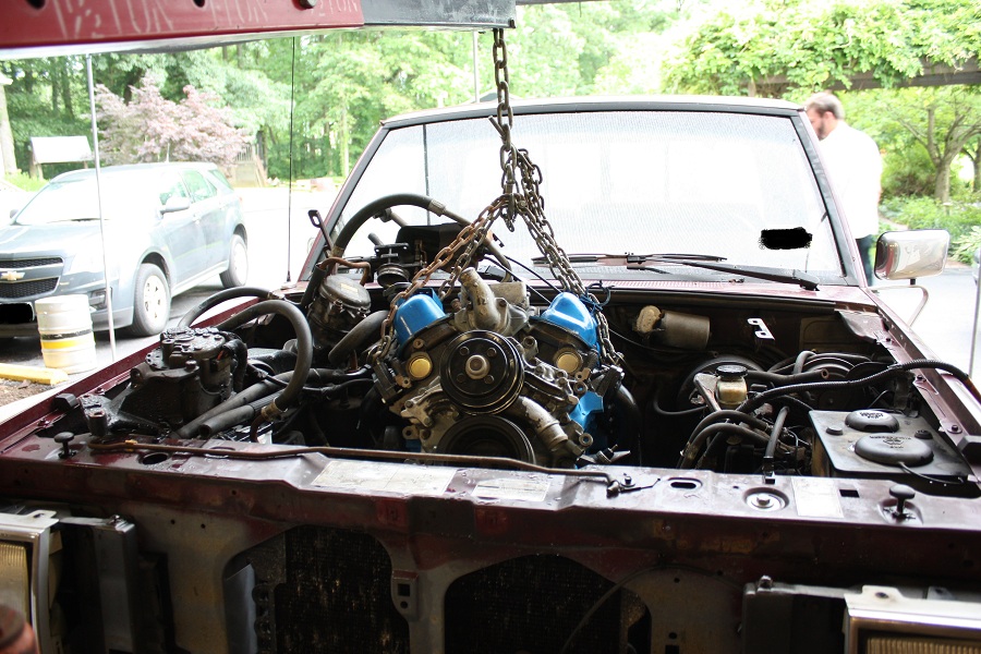

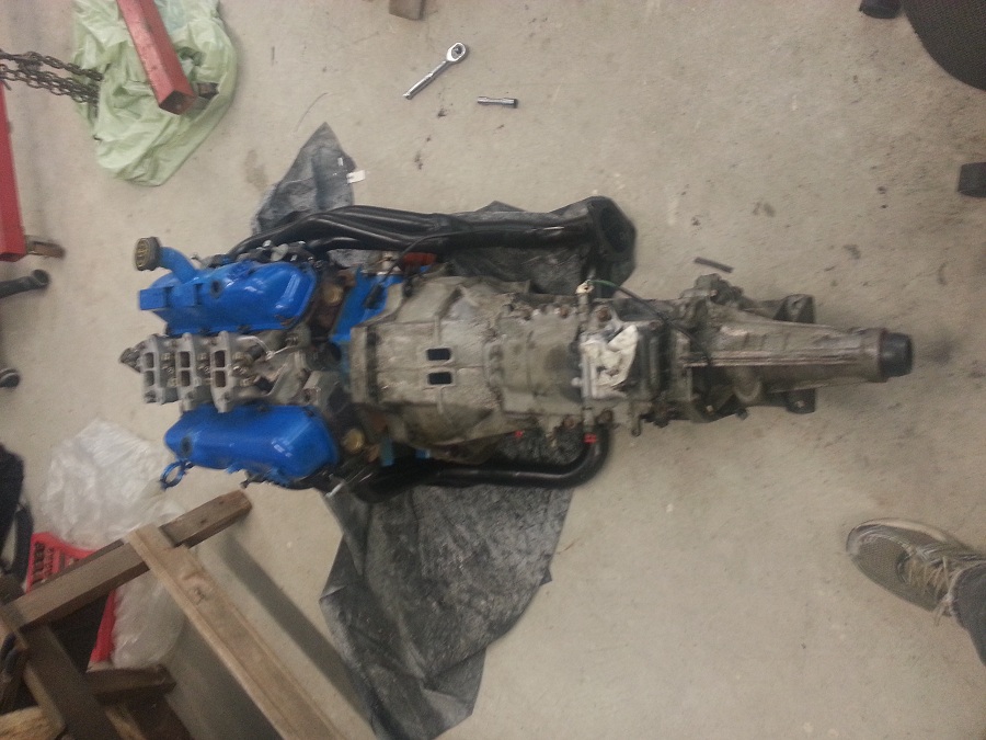

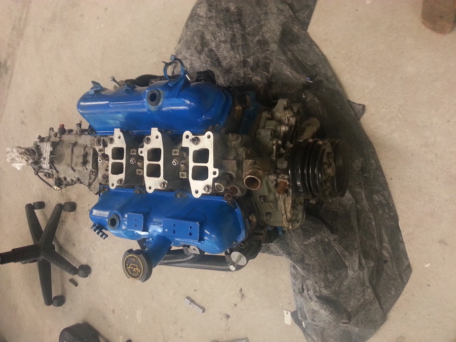

So the engine is in the truck but it took some wrestling to get it together. I originally had the whole header assembly together on the engine before the install, but found that one of the cross members wouldn't allow the flange on the y pipe that bolts up to my brand new cats to pass by it. We removed the y pipe and got the engine in but I had to remove one side of the headers to get the y pipe back on. Then i had to wrestle the cat to get that to line up with the y pipe and found out the gasket i was provided with the cat was way to small...Anyway, by the time i got everything together i had to leave. Dont have pictures of the engine in the truck yet but i will post some of the pictures of the complete assembly when i figure out how to get them off my phone....
Ok, here are the pictures of the engine and trans and all right before install
So just a side note about the Pacesetter Headers. When i was installing the O2 sensor, i realized that it is located before the two pipes merge...essentially only seeing one bank of exhaust. On the original y pipe the sensor was located in the middle right after they pipes merge but on this one it does not. Dont think it will really affect anything, just thought it was funny looking....

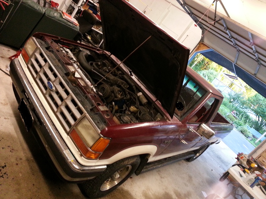

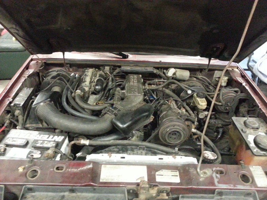

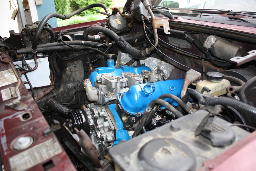

Posted some pictures of the engine drop and completed assembly:
  • 1989 2.9L Ranger Build
just a side note....im very upset with how NOT blue my engine looks with all that crap piled on top of it....even tho its an eye sore and almost looks edited in on those top pictures haha
Anyways, ill get a picture from under the truck when i get it lifted up to finish the clutch assembly. The header y-pipe runs nicely along one of the cross members as you will see when i get those pictures, but i have to trim a few screws so they done ware a hole in the fresh exhaust system....
And finally, the last pre-turbo mod that i have to do is make a heat shield for my starter....the header runs almost right next to it (within 4 inches) so i need some protection for that bad boy...
I will get pictures of all these things this weekend when i get everything together. I will hold off on the video until then also, that way i can get better footage....all i have right now is idle footage and video of the steering wheel when i was trying to record the tach....stupid phone touch screen froze so i thought it wasnt doing anything....first world problems...

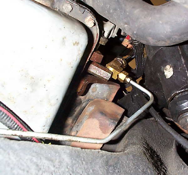

  3. Oil Pump -- Going to “T” off of the oil pressure switch like DCinDC did with his truck here. (Hope you dont mind I used your picture from that thread as an example of what I plan on doing.) I would like to know where you mounted your oil pump though DCinDC.

My return oil pump is mounted to the frame on a welded bracket we made, back by the turbo. Getting a suitable pump was the most difficult and time consuming part of this whole project. The first oil return pump was a Ford frame rail fuel pump. It leaked after about a week. Next was a universal diesel lift pump from the parts store, for 9 dollars. I was REALLLY hoping that one would last. Nope just a few days later it was leaking.
I did ALOT of research during this period. I wasn't going to pay 300 for a racing diff pump.
After a few other fits and starts I bought a ShurFlo pump. I contacted a dealer on the net and told him exactly what I was doing and he told me which one to get. I strongly recommend you do the same. They make about 100 different variations of the 8000 series pump that I have. You will need someone to tell you which one to get.
I haven't had ANY problems with the Shurflo pump.
The rear mount turbo guys (forget their name) have all kinds of oil pressure safety features in their wiring. pffft. I just unscrew my oil fill cap and see if oil is coming out the nipple for return oil that I screwed right down the middle of it. If so, then I'm good. If not, it's too late.

so just a side note from what you said from oil pressure safety....shouldn't the oil pressure be the same as the dash gauge readout if its coming right off the sender? Would I notice a pressure change if i'm not getting flow? I thought about putting a T right at the turbo for a gauge but i figured coming right off the sender already gives me what i'm looking for....no?
Don't worry about it. It's just an added safeguard.
If there is a massive oil loss anywhere it will show on the gauge or idiot light.
