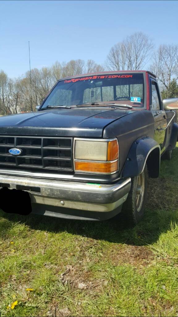

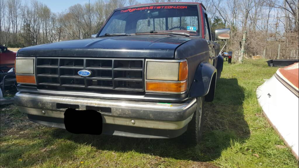

1989 2.9L Ranger Build
So i finally had time to put it all back together. Its not perfect but its good enough.
