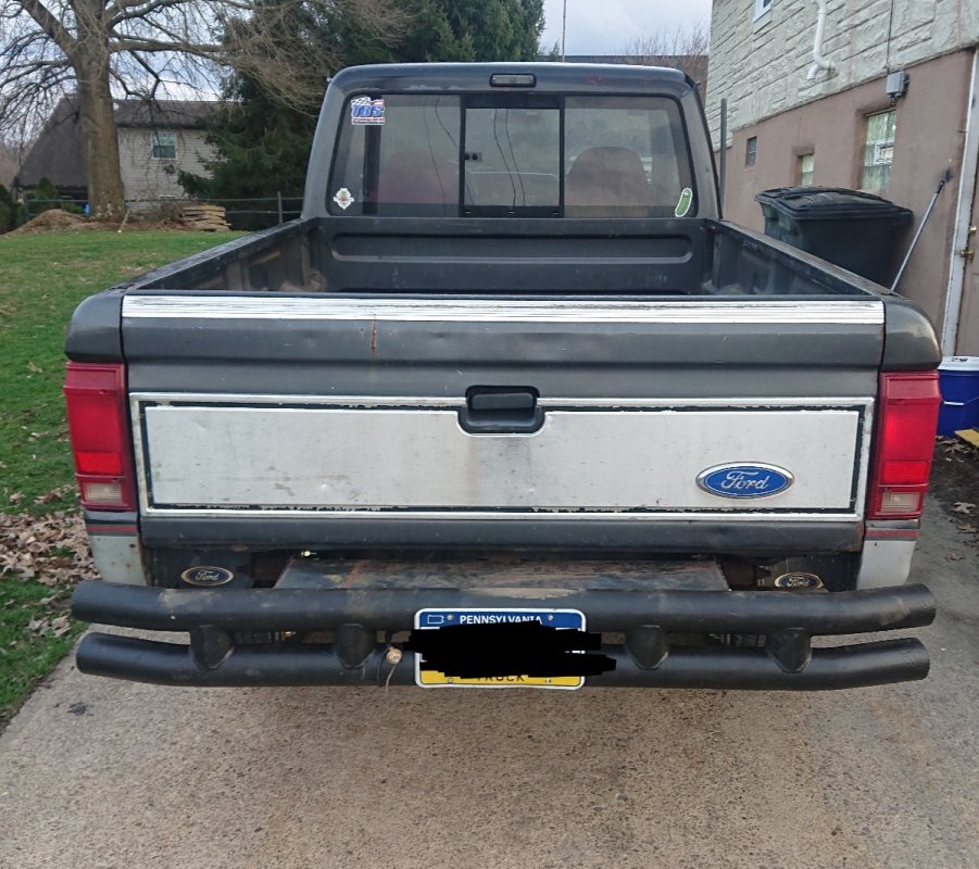

Definitely was talking about the bumper. And I'm about to agree. Not a fan. But, beats the no longer legal ones I had on the front and back.
Rear isn't as bad.
I have never liked those style LED lights, gives it a bad look. Would look better with the projector style in my opinion.

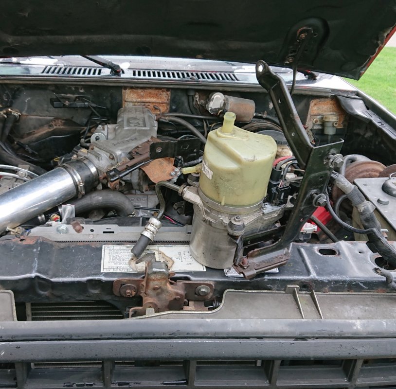

Next job is the steering. Tired of gently nudging myself away from a Richard Hammond-style driving experience while at speed on the highway. Saw a few fox body guys go a slightly different route than the rest with the electric over hydraulic system.
Picked up the EPAS pump out of a Volvo S40. Made me laugh when I saw it marked "FoMoCo." looks fairly straightforward to rig up. Two main power wires, a relay wire, and what looks to be a pair of adjustment wires for level of assistance.
Why? Eh. I like learning new stuff. From what I've heard, if properly set up, it will make an average (in my case, an economy pickup turned rot box) vehicle handle like a much higher line vehicle. The idea of running a lower demand system intrigues me as well. I put the 3g alternator on, may as well make it earn it's keep. Plus, my pump is on its last legs, and ya'lls older posts convinced me manual steering was a bad idea.
I also need room to cram a supercharger in alongside the motor, so one of the accessories has got to go. When you get to hell Mr. Whining Power Steering Pump, you tell them who sent you!

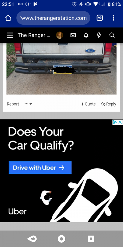

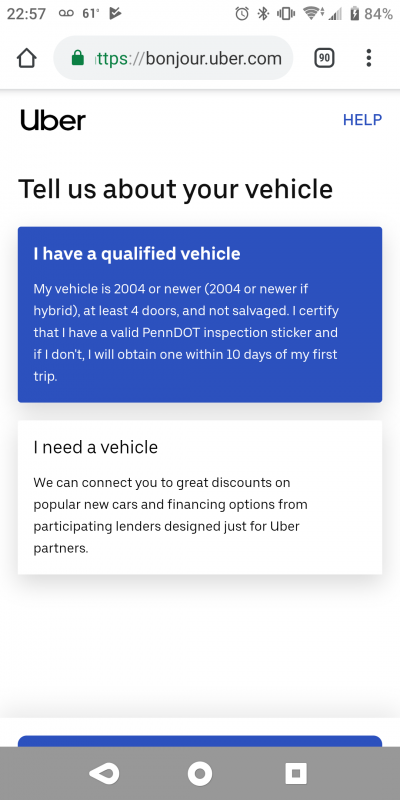

Go for it, but I already know the answer because I looked into it.
Two of Uber's requirements are the vehicle must be a 4-door, and cannot be more than 10 years old. Personally I thought it would have been cool to use a classic land yatch from the 40s or 50s, but they "have to have seatbelts":rolleyes:
Side note, should we find out? :ROFLMAO:
Edit: Nope. Well, their loss.
I'm not totally sure, but I think LYFT allows older cars like "Classic" and/or "Custom" and are less strict about how old the car is. I've seen some cars with the 'lyft' light, and the were less than stellar, to say the least. While my neighbor does "uber" for a living, they told him to get a newer car, he had a decent Pathfinder, traded it for a Camry that was just 2 or 3 yrs old.

So before I start this, has anyone tried the FoMoCo / Volvo EPAS swap? Or am I the first to do it on a Ranger?
Interesting side note, the pump is rated for 120 bar (~1700 psi). So even if I don't get my steering to work with it, now I have hydraulics. Don't know what I'd ever do with hydraulics, but cool nonetheless.
Truly amazing how small it is for so much power. Junkyard is having a half off sale this week. May go grab a few more.
