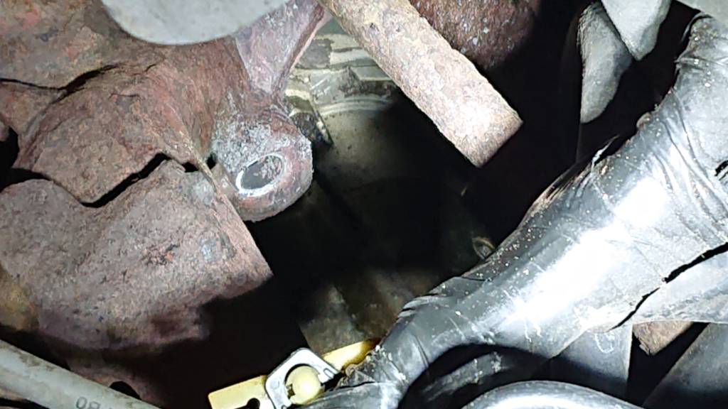

What am I looking at?
Broken off plug in driver's side exhaust manifold. The thing had been leaking since day one, and I finally decided I would fix it. Joke is on me.
I put a minimal amount of torque to it with the impact, and it sheared off. As soon as I tried to use a broken bolt extractor on it, the bottom of the manifold shattered.
