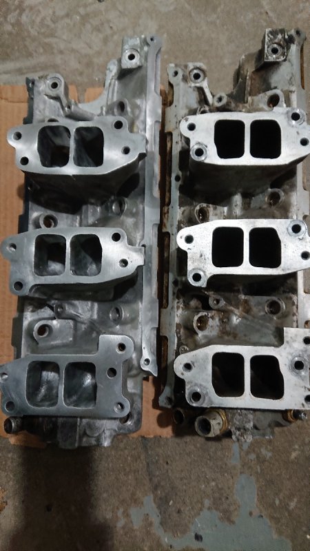

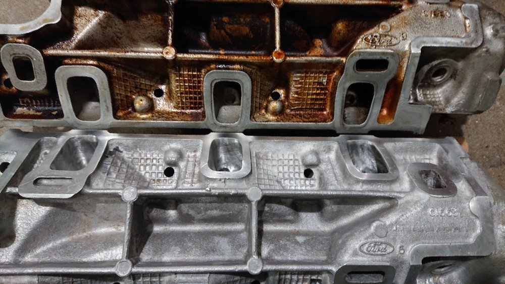

So, got to learn the hard way that there's a difference in rocker arm pedestals between the 86tm and aftermarket heads.
Pics to follow.
EDIT: For now, I'm still not sure if there is damage, or just a MADDENING lifter noise.
From what I can tell, there is a difference in the way the oil flows up the center pedestal in the 86TM vs. 89TM aftermarket heads.
The solution so far was to pull the rocker arm assemblies, and chamfer and bore the center pedestals so that they line up over the oil passages.
At initial startup, I had a definitive typewriter sound of a new upper end of an engine breaking in. It seems after 500-600 miles that all lifters, bar 2-3 of them have fallen silent, and one on cylinder 5 or 6 has a 'clack' that sounds like I'm doing nothing but damage.
I pulled the valve covers back off and checked valve lash, etc. Everything was/is adjusted to 1 3/4 turns, but it looks like the lift on the exhaust valve on number 5 opens about half of the height of the rest.
Short of pulling the heads back off to change out a lifter, I'm stuck as to what to do. I'm assuming that the noise cannot be good, and that I'm really messing up the motor that I just spent so much time and money on. From what I can tell, oil flow to the upper end is more than it has ever been (flashlight down the oil filler neck on the opposite valve cover - looks like a steady river of flow versus the previous trickle).
Next step is to pull the valve covers again, pull the rods, and check them for curve. I did order a set of refurbished 89TM rocker arm assemblies via ebay to see if that is the solution.

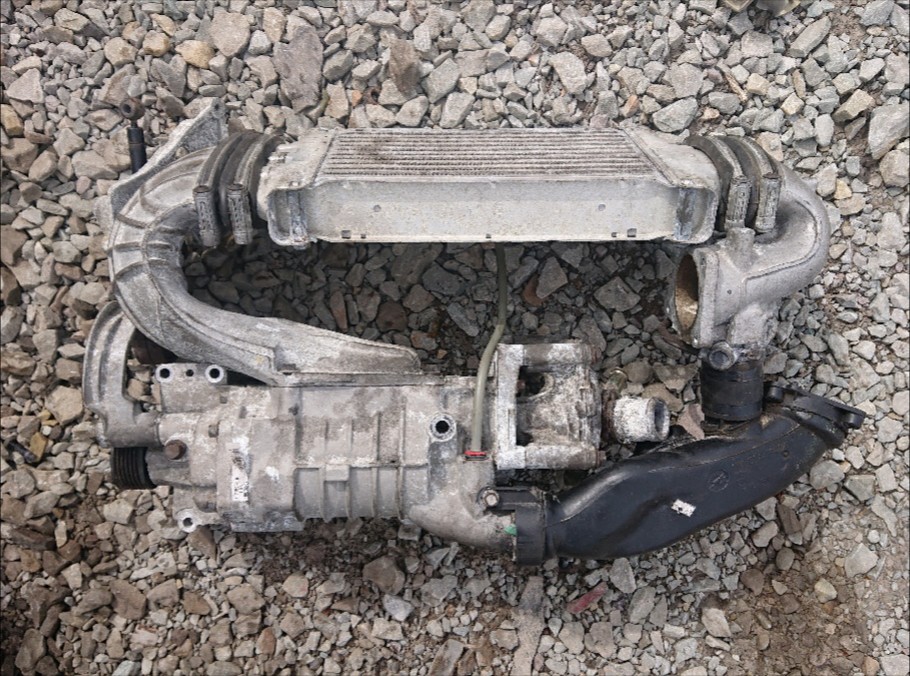

Eaton M45 and intercooler, blow off, etc. Pulled from a Mini Cooper S. Impellers look like new, and seems to be completely serviceable. $60 at the local U-Pull it. Rumor has it that its capable of pushing enough wind for a 2.9.

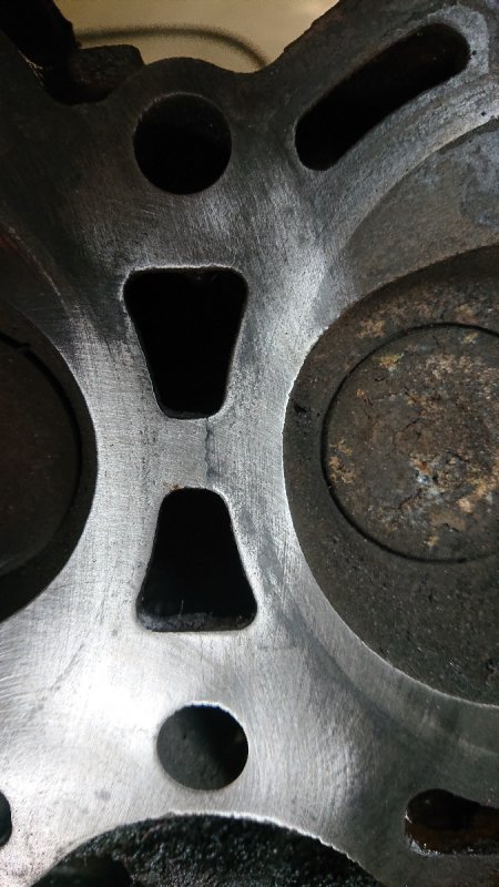

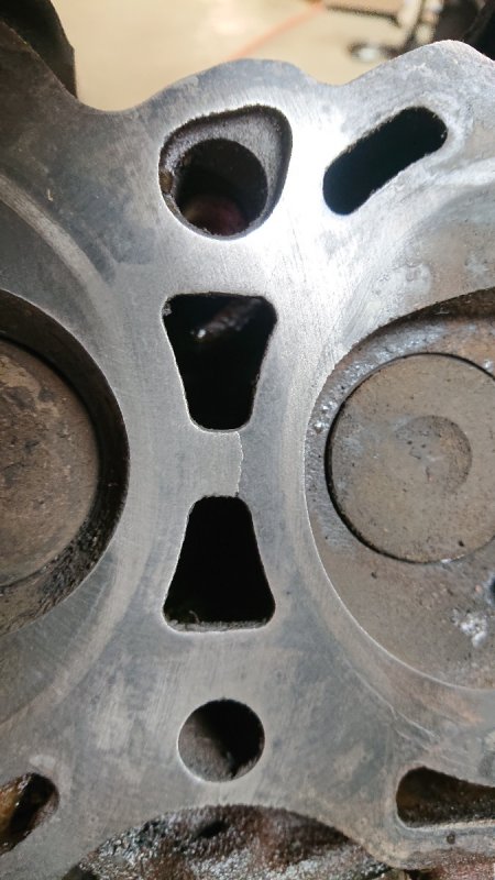

Forgot to post these a while back. Reference photos for what a set of cracked heads on a 2.9 look like.
Despite the citations of head cracking issues everywhere, I found very few photos of 2.9 heads with cracks in them. These are the heads off the 1990 parts truck. 86TM casting numbers. I really think the 2.9 in the 1990 was not the original engine.
I also kept one of the head gaskets off this (spare) engine. It blew in three separate places. Never saw a head gasket blow out so gloriously. It's now a trophy hanging above my workbench.
I've cracked several (at least 5) but they also had cracks running to one of the adjacent cylinders.

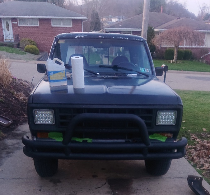

Opinions are definitely wanted in this one. I'm not so sure I like it...
I have never liked those style LED lights, gives it a bad look. Would look better with the projector style in my opinion.
