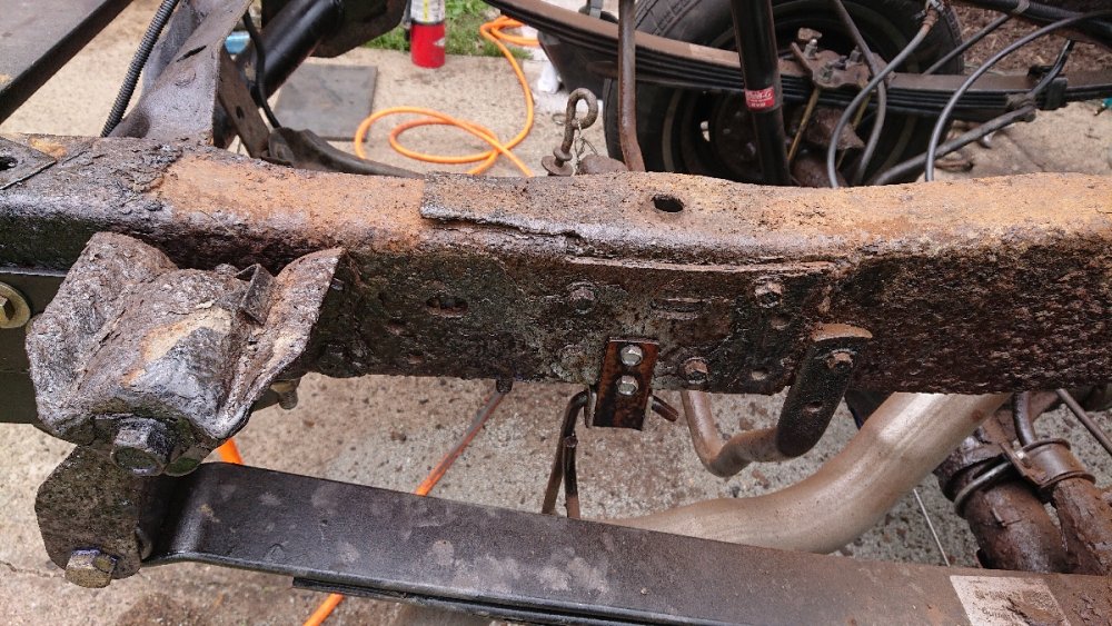

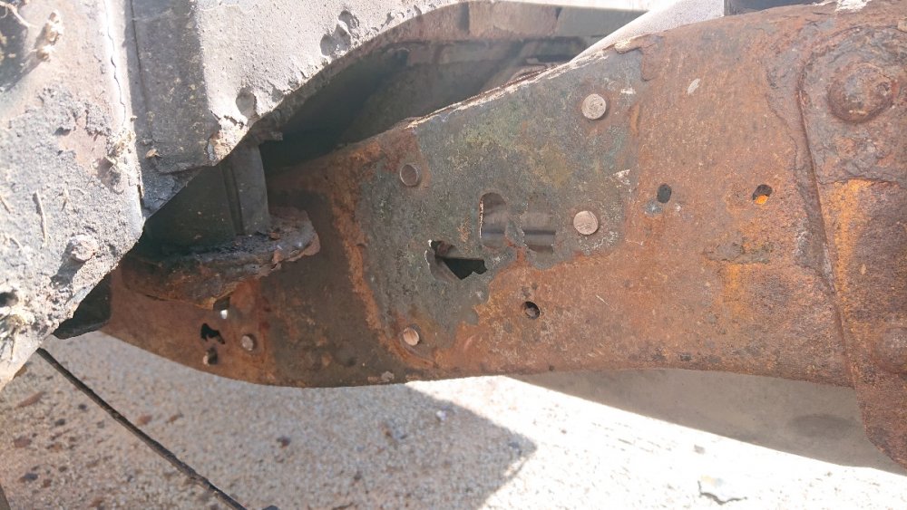

Aw sh*t....

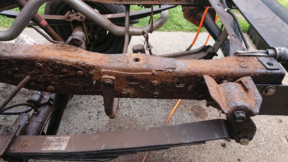

Nice gaping hole in the frame. Rest of the area is paper thin.
Have some 1/2 inch mild plate leftover from a blast plate.
Google-ing "how to fishplate a frame."
No straight sharp corners.
ends of fishplate cut in a diamond [45 degrees].

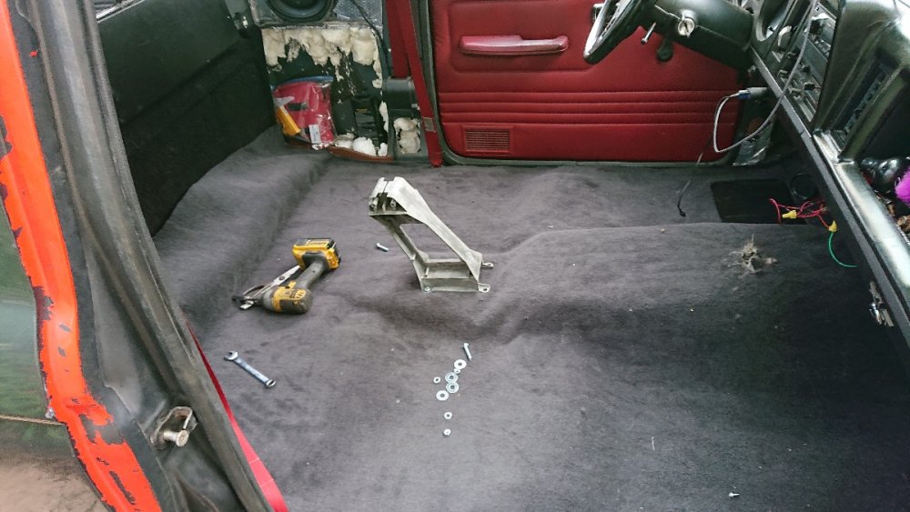

Any suggestions on mods while I have the bed off??

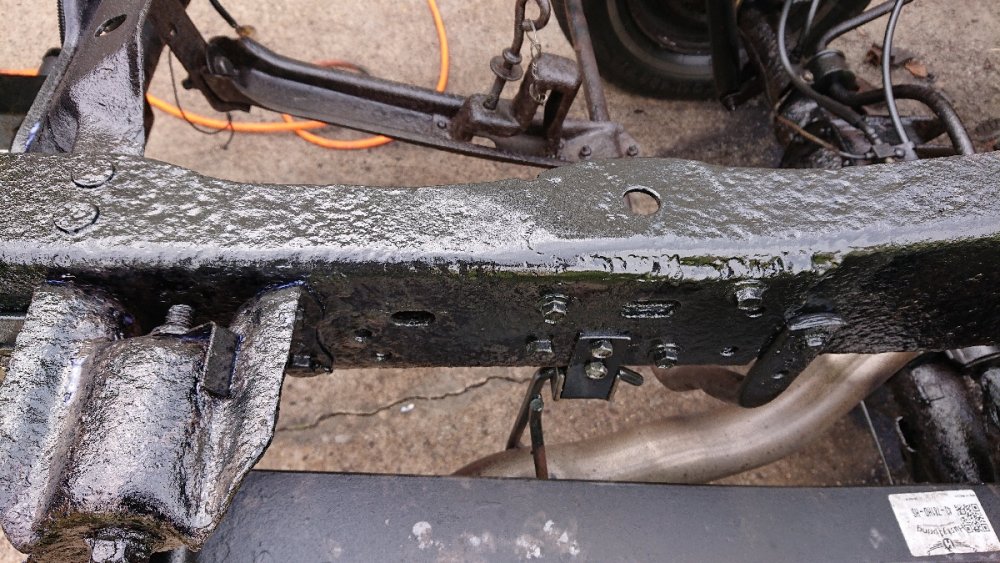

Needle scaler was run to everything from the transfer case to rear bumper. 5 gallon bucket worth of rust removed.
Two holes, one thin spot. Not bad.

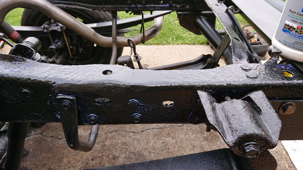

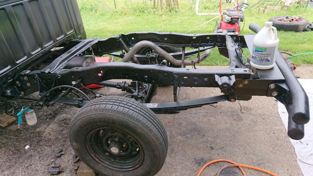

Shot a gallon of corroseal on entire frame and underside of the bed and fenders. Let's see if it works.

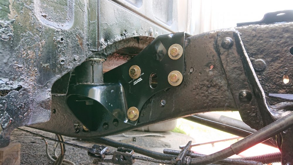

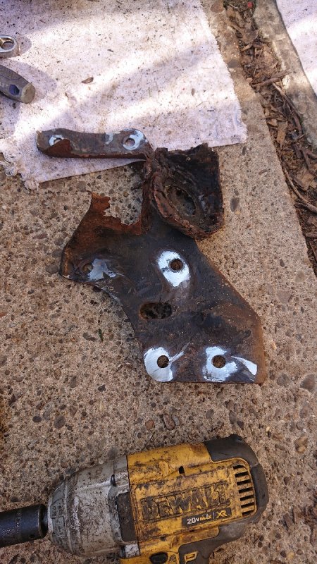

Re-repaired some old frame repairs. New cab mount on. Fishplates are next.
Thought about running some diagonal braces in the frame. Not sure yet.

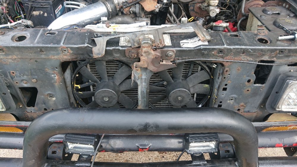

When I got home, I had an hour or two to kill. Since the 2.9 is allergic to heat, figured no time like the present to start correcting a potential issue. Took the initative, and installed the Mercedes C230 Kompresor pusher fans. They are from the same car from which I pulled the M62 supercharger. They fit like they were made for it.
I can't express how brilliant the fit is. All I needed to do was remove the plastic shroud from the fan unit and drill four holes in my core support. Even re-used the 'benz bolts that were on the fans. Oh, hidden bonus, the fan units are aluminum. Gotta love Mercedes. (y)
They easily move 3x the air that the 16" electric puller does. These things are like a freakin' tornado on the front of the radiator. I was planning on installing a bigger radiator (eventually) for towing and truck stuff/driving way too fast on dirt roads. No need now.
Tested them out in the driveway. Let the truck get up to temperature with the hood down and the 'benz fans off. I have the windshield wiper linkage access plate removed on the cowl to encourage airflow through the engine bay. Without the 'benz fans, I had the normal heat tsunami running out of the cowl.
Kicked on the 'benz fans. within 2 minutes, air was leaving the cowl at slightly above ambient temp, as well as pouring out of the gaps in the fender skirts. These things WORK.
Hit the bottom of the radiator with the laser temp. By time coolant is getting back to the engine, it's at ambient temperature. Heh.

Need to figure out how I want to control them. Either temperature activated by the coolant or ambient engine bay temperature, or road speed activated to kick on while in traffic. Probably going to opt for a temperature probe by the fuel rail and allow the intake area temperature control them. Should give me the desired result of them running when at low speed and while stuck in traffic, and turning off when cruising.
Photo of them installed. LIKE A GLOVE. Just need to get rid of the paint marker mess.

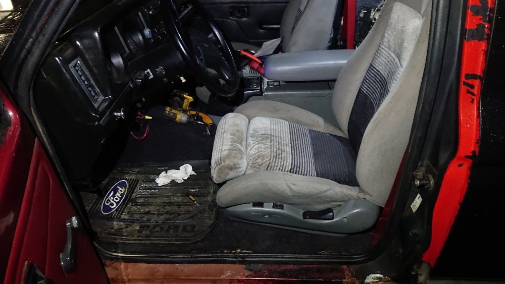

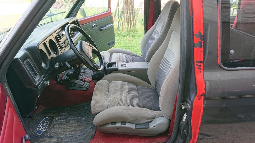

The blackout continues thanks to a lucky find at the junkyard. Just need to locate an armrest.
And yes, they're power seats.  :headbang::headbang::headbang:
Very nice! I had bad frame rust and cab mount issues too. From the rearmost spring hangers back there was only top & bottom frame rails, looked like a shotgun had been took to the middle part of frame. I slid some channel iron over the frame rails after treating what was left with por-15. Also had to plate drivers side of frame from front spring hanger forward to the cab mount attaching point. Your floorpan takes the cake though. I’ve never seen one that bad except on a 51 Plymouth Cambridge that had set in the mud for over 30 years.
I kid you not when I say this, I was told by the previous owners daughter that the truck had not been washed once the entire time her father owned it. He just wiped it down.
Now it gets an undercarriage wash once a week in winter, once a month in summer. I think I may be accelerating problems by doing this, but I don't mind as it let's me find and fix them quickly.
The blackout continues.
Oh. Just a fitment note - the arm rest is from a 98-01 Explorer. It does fit, and gives you two more cup holders. For a back seat, which in my case no longer exists.
In a strange way, my Ranger has now become a two seater with a loud V6. TAKE THAT SPORTS CAR PEOPLE! ?
