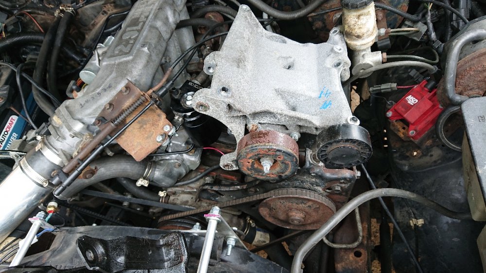

Definitely thought about it after seeing the article in the tech section. Decided to try the Volvo route first to cut down on time.
Posted this to my thread in the forced induction forums. It's the baseplate for a Mercedes Benz M62 supercharger. Blower bolts directly to the flat area. Tensioner and idler are integrated. Way too perfect of a fit.
Only problem that isn't a small matter of fabrication to solve is the pulleys. Options are to use a twin v belt on the blower, a twin v belt to serpentine jackshaft setup, or as @adsm08 suggested, finding a serpentine crank pulley off a '86 Aerostar 2.8.
Have been trying to get a hold of this guy to see what the pulley on his crank is, but no luck to date.

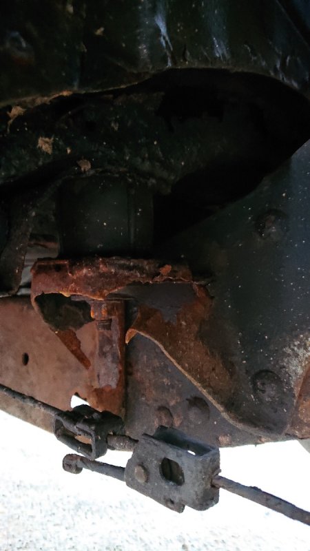

Put the prothane body bushings in a few days ago. Definitely need to dig up a body mount support for the cab side of driver rear. It's toast.
Truck looks more square though. Need to realign the bed when I put the hitch on. Rides a hell of a lot better. Header collector is now rubbing on the cab seam on driver side. Probably the collapsed support. Meh.

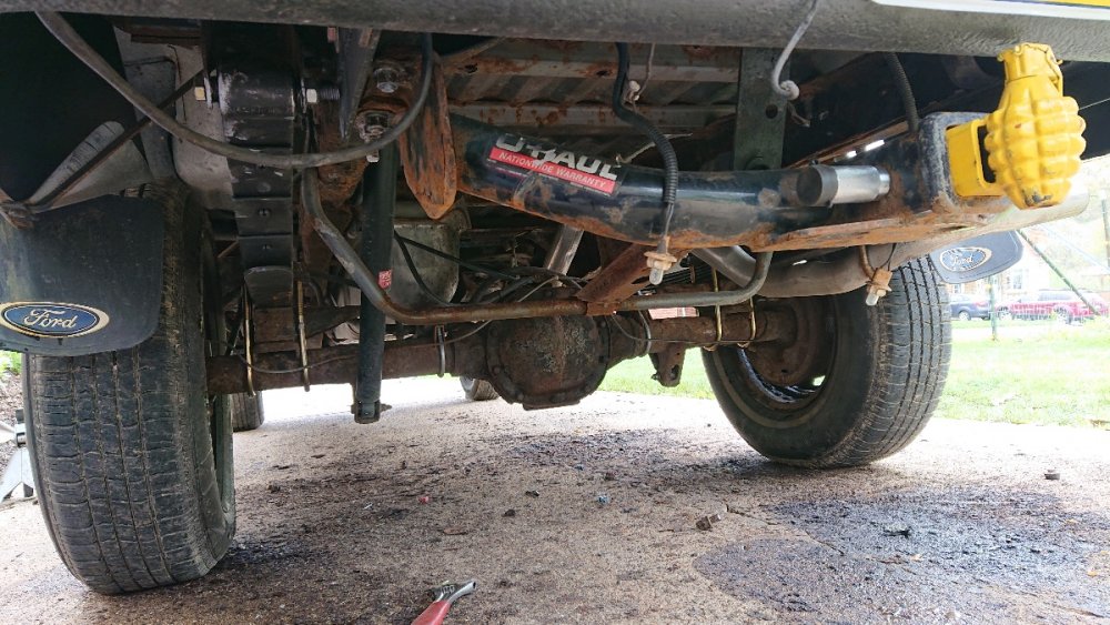

Looks like that old truck is definitely on her last leg as far as frame rust. I watched my old 89 take the same route... It gets them all eventually.
Probably the case with mine. Been hunting for a frame down south on Craigslist, etc.
I could plate and reinforce this one... But, I figure if I look for one now, I can get it prepped with a independent rear suspension 8.8 out of a thunderchicken or muskrat and a Dana 35. Then just wait on this one to give up and move everything over.
Truth be told though, I've seen and driven worse.

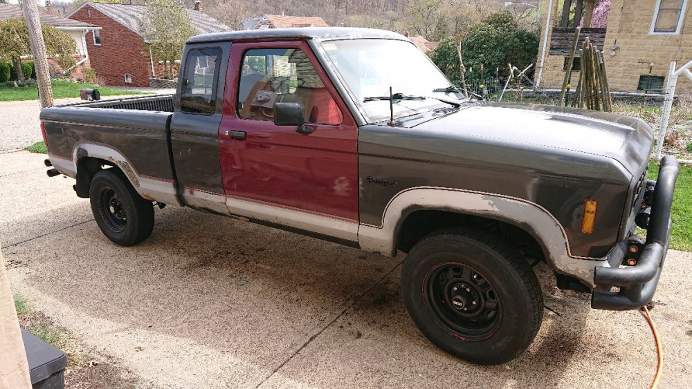

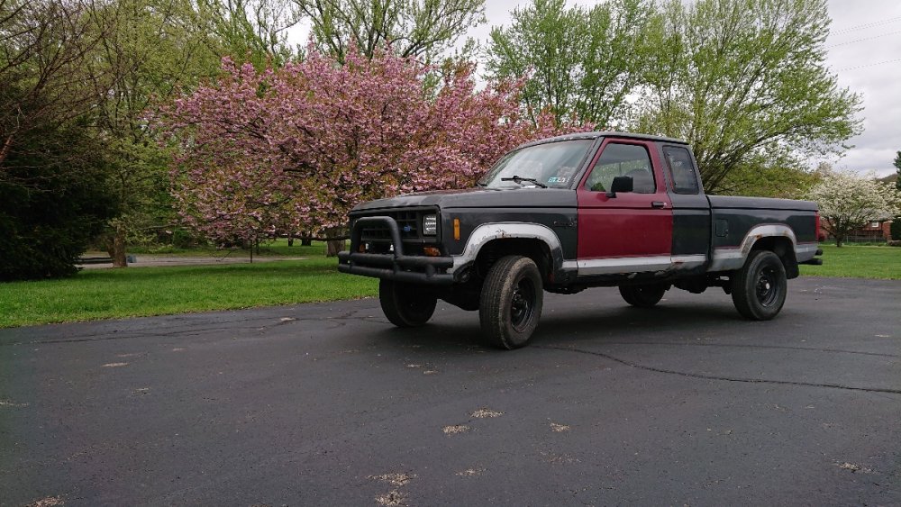

With the exception of an eventual upgrade to monotubes, or an independent rear, I'm going to call the suspension system "done for now."

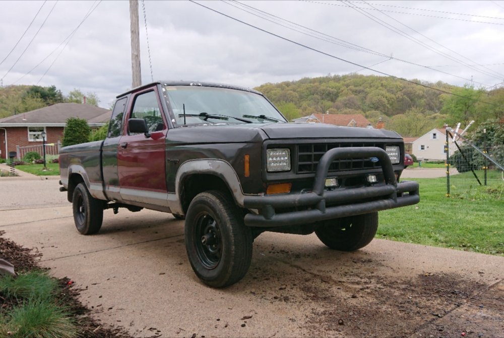

Ya'll were rigjt about the bumpers looking better once the suspension was repaired. I gained 3-4 inches of height out of it.
Moog variable rare heavy duty springs in the front (really wishing I would have gotten the constant rate in retrospect), husky 4+1 1750lb rear leaf springs.
Rides SO MUCH BETTER and looks awesome.
