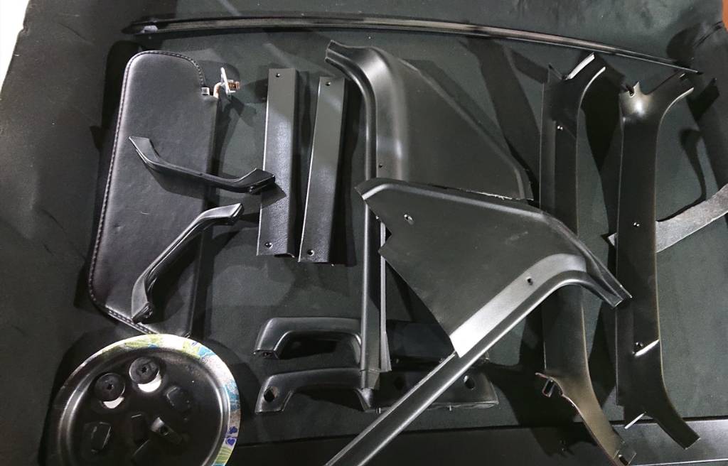

You never realize how much trim is in a cab until you paint
Every. Freaking. Piece. Of. It. _20190209_213007.jpeg_20190209_212922.jpeg_20190209_212903.jpeg

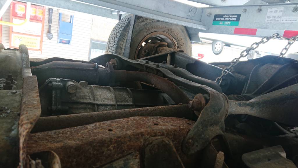

I wanna see a picture of this trans. I still think it's more likely an FM146.
likely.

I was skeptical. I'll get a photo as soon as I can, but the shifter boots were staggered, not in line like my FM146 is. Should have crawled under it, but, rain, and I'm a wimp.

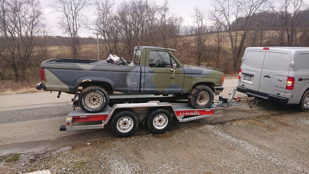

My car dolly won't be free until Thursday. Unless someone wants to drag a truck from Washington pa to Greensburg for a high five and a six pack. [emoji23]

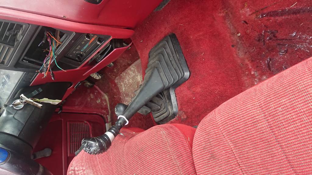

Well. Parts truck is here.
Not familiar with the Mazda M5OD, but looks like one to me!DSC_2269.jpegDSC_2266.jpegDSC_2265.jpeg

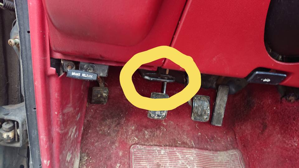

Not entirely sure what this is. Anyone know?
Also. Need some tips on the transmission swap. Read the tech section, and not sure how mine is going to go.
I guessing I'll need to swap floor plates along with the shifters. May have to do some cutting, etc.
Will driveshafts need to be swapped? The trucks have the same 7.5 rears, but the 1990 has the 35 front diff, and mine has the 28.
Also, worth tearing down the M5OD? The shifter feels like it has entirely too much play in it, especially in 5/R.

Hood release latch possibly?
I was thinking hood release too, but now that we know it's not that ...there's a faint niggle of an idea that it's for fuse access.
Parachute release?
Ejection seat handle?
Trap door release for bad passengers?
Manual choke?
Fuel shutoff for engine shutdown?
Or maybe it's just a t-handle Allen wrenches stuck there.
no idea
Floor plates should swap, will need to trip the carpet probably.
Front driveshaft will need swapped (D35 needs a slightly shorter driveshaft) Rear depends on truck configuration and what trans the '88 has.
There is bushing kit for the shifter that is cheap and pretty easy to install

1988 has a FM146, manual transfer case with the two piece rear driveshaft. Donor truck has the m5od and manual transfer case.
