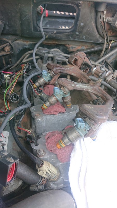

Installed the 24lb injectors.

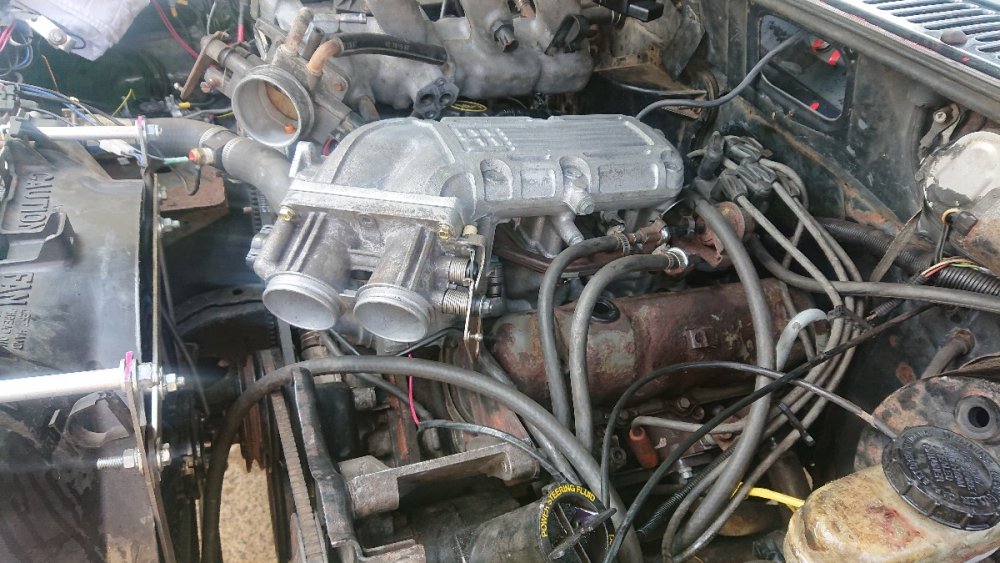

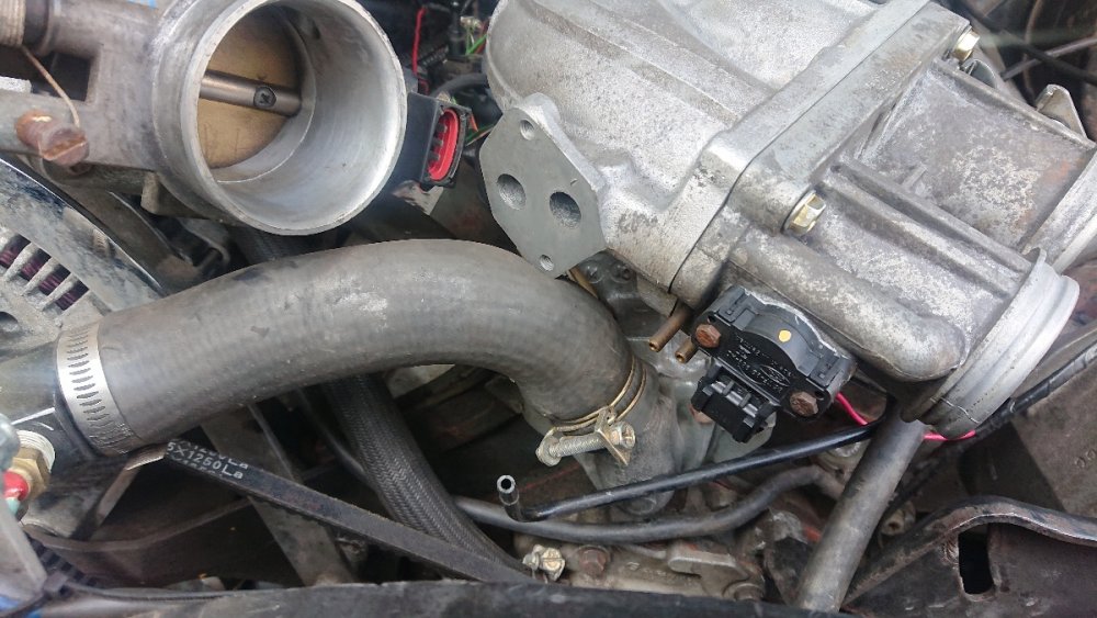

Did the test fit of the Sierra intake. Looks like there is a small IAC fitment issue with the rad hose. Easy enough to fix. Just waiting on the throttle cable bracket to get here so I can finish the install.
Video of initial installation of 24lb four hole Saleen injectors. All I can say is this thing now sounds MEAN.
Officially running megasquirt full-time. One of the cool things with megasquirt is it upgrades the obd1 system to full data logging. I figured out that my stock injectors COULD NOT supply adequate fuel to the engine. Injectors upgrade was absolutely necessary.

I am not a performance expert, but I don't think a second intake gives you more go-fast if it is upside down.
Or does it give you double go-fast?
I'm so confused.
Broh, thats like 50 horsepower, yo
I don't know horse power. What's 50 HP in go-fasts?
Somewhere between body kit and tanning bed sized spoiler, yo.
This is like NAWZ and ground effects lights had a baby and it was raised by an eBay T3 turbo
