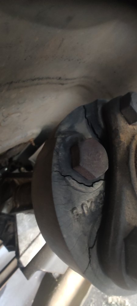

Bro! Please, can you relay the part number? I noticed on my ranger the coupler is cracked on mine and I'd like to replace it before it fails and I'm in the same boat as you previously were lol.

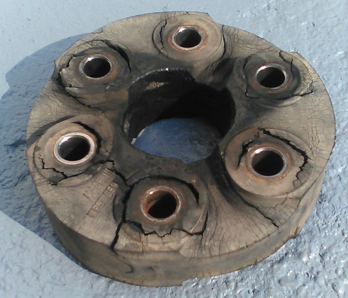

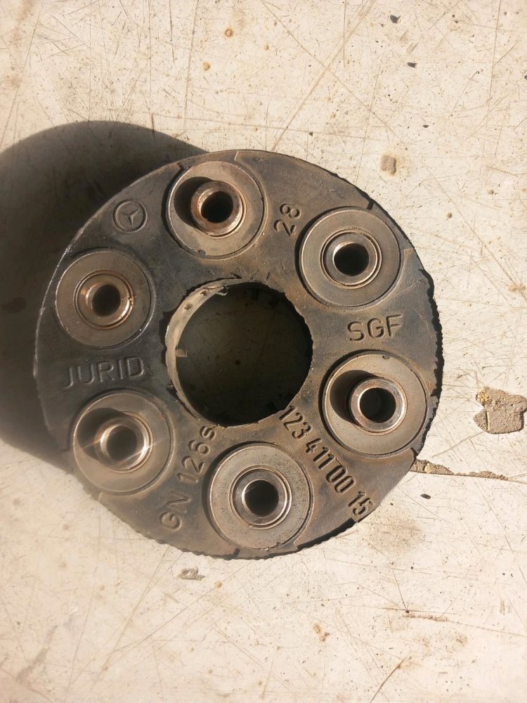

Here are two images I found online when I looked up the part number, I'm assuming it's a Jurid 1234110015 GN126S, but I'm not sure how these mercedes part #'s are supposed to be read.
A few notes, the bolt size that fits in these is 10mm, the stock ones I had were 12 so I had to get new bolts n nuts, not a big deal. It's a bit thinner than what I assume is stock so I got some washers to kinda pad out the space, again pretty easy workaround. Aside from that and machining of the yoke, the bolt pattern is right and so far its been working just fine. Just be aware that it probably won't be a simple plug n play kinda thing, it'll take a little bit of finessing or some redneck engineering but nothing too crazy.
I hope this helps whoever is looking for this unicorn of a part.

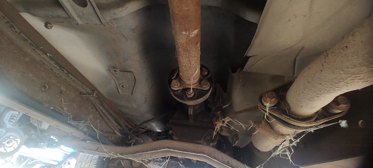

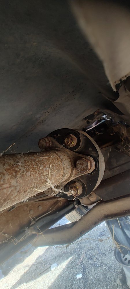

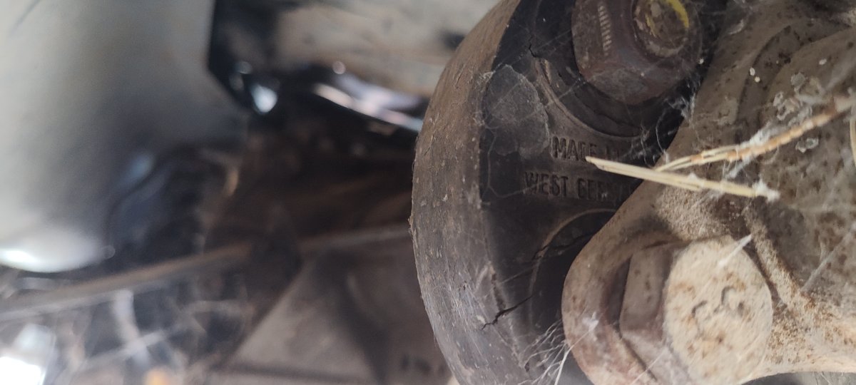

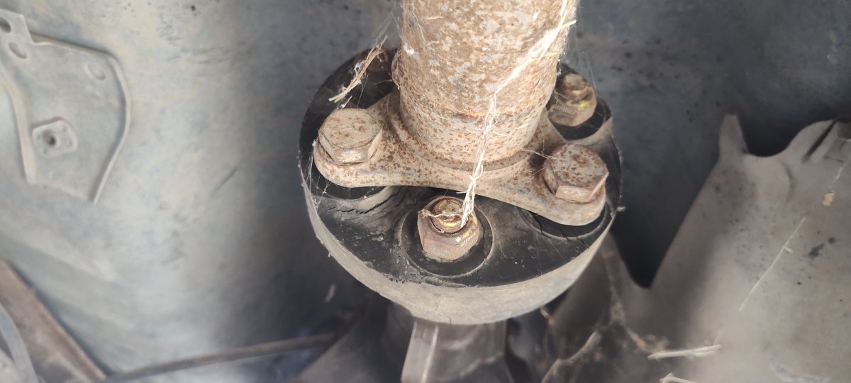

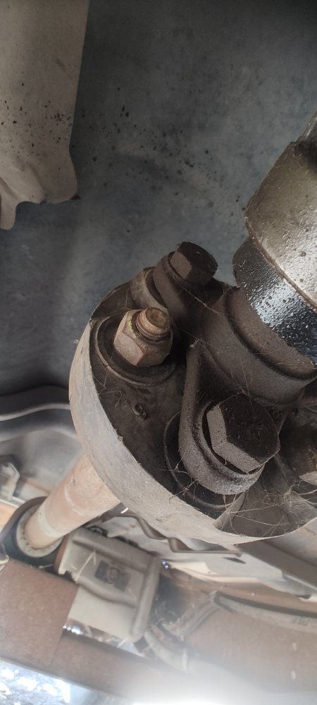

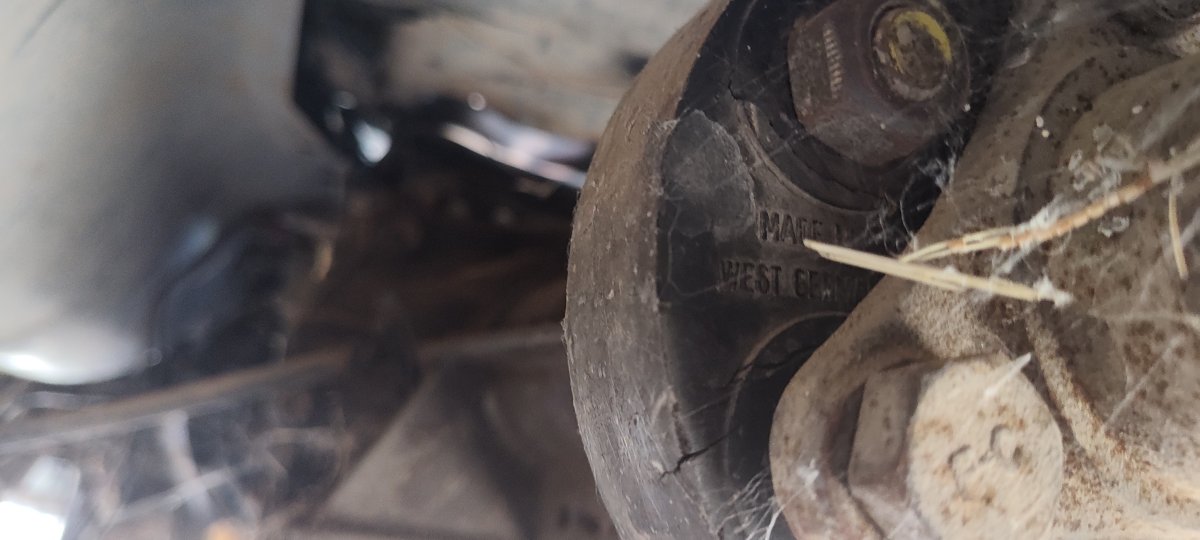

Ok so I went to a junkyard where they got an 89 a couple of days ago. The coupler on it said "made in west Germany". Here's some pictures.

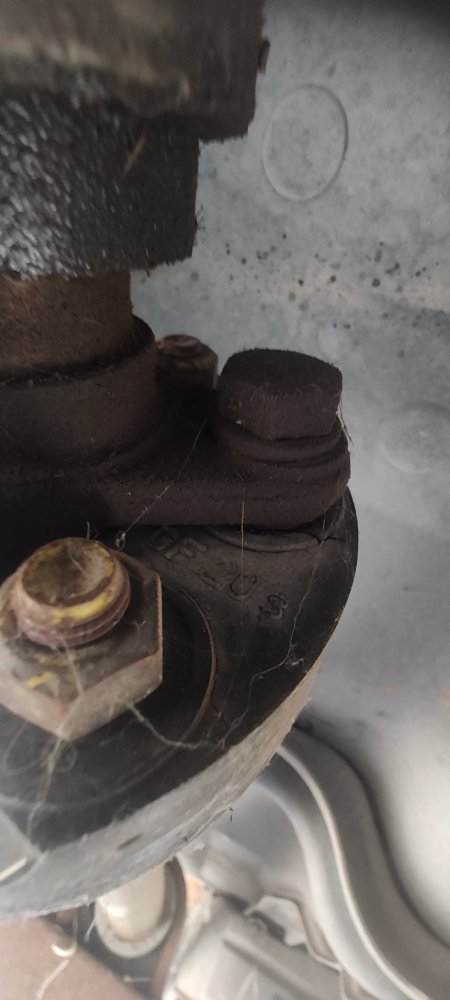

This is mine. Some numbers look similar.

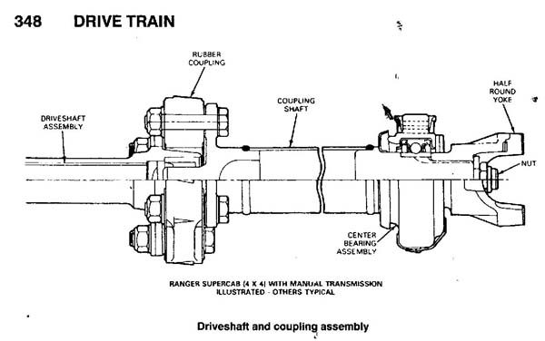

Remove the bolts, slide the tranny output shaft forward and it should drop right out. Maybe Opijmee will chime in on this since he did it. Mine was taken out by the shop which was doing other work and noticed that my giubo (love that word, something new I learned on here!) was not in good shape so I can't be positive.

based on those pictures ("made in west germany") I googled around and the biggest mfg in germany is SGF... then I noticed that you had a partial part number "...GF 20S" I bet that is "SGF 20S"
I didn't spend a ton of time hunting for a part listing (mfg has only cutsie splash screen stuff and contact page, not really consumer direct/friendly), but I bet with the mfg and part number someone should be able to find an interchange.
fwiw, the first 2 pages of results from my searches all pointed to bmw forums like bimmerfest.com
