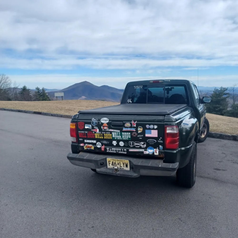

You know, its funny that you mentioned having two rangers because that was actually my situation about a year or so ago. I had a 2001 v6 auto Ranger that was also a supercab. Bought it at around 220k miles and the transmission started to slip like crazy around 255k and at that point I already had the ranger I have now for about a year or 2.
Absolutely loved that truck man.
