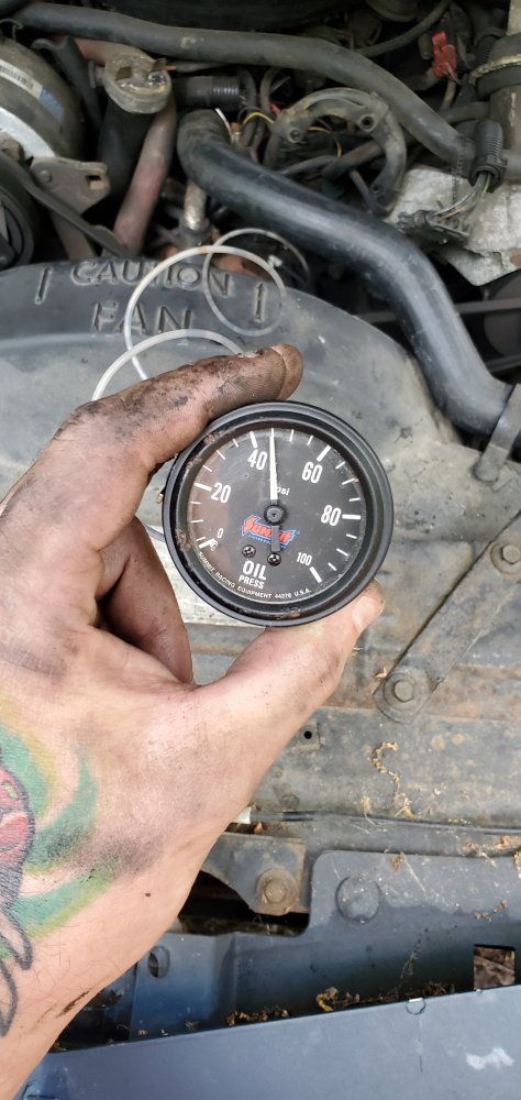

Finally got around to hooking up a real oil pressure guage, and the results were not what I was expecting lol.. they do make me happy though.
Cold idle
& after running long enough to smoke a butt and wash my hands.
Then one of the heater core hoses sprung a leak 😫😂
Big thing is.. now that I know it makes good pressure Im willing to either clean or get a rebuilt carb for it and continue with the tinkering! Hoping at this point that I can just make it a decent low-buck winter beater and save the Bronco from all the abuse winter thrusts upon vehicles.

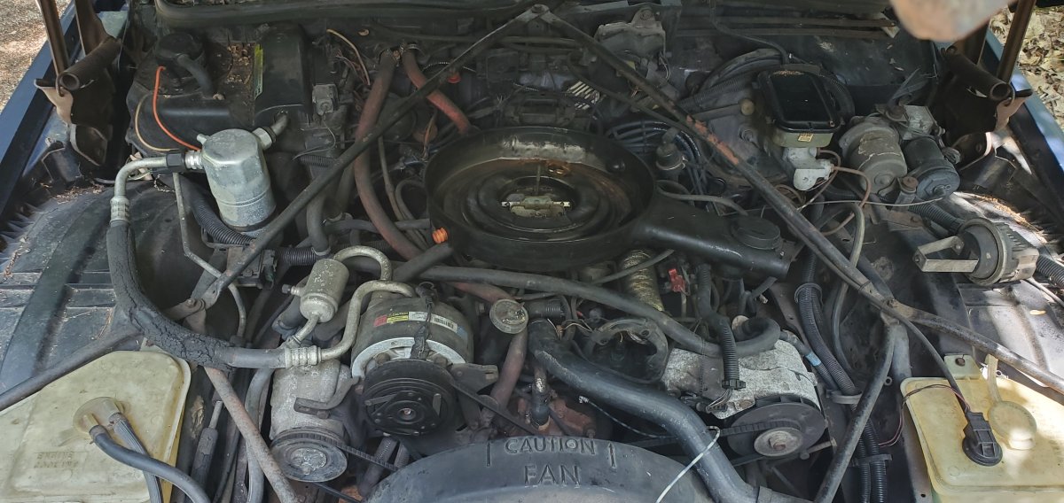

Old cars are EASY to work on, they said..
There's SO MUCH ROOM in the engine bay, they said..
I swear. There's more hoses and wires draped over this damn motor than a 6cyl ecoboost -__- idk how a guy could even change the plugs without removing all sorts of crap lol.
Started the de-spaghettification.. even though it's WAY too hot.. got a good bit done.
A/C compressor and most of the rest of the system is gone.. most of the smog crap is out of there.. not much left of the cruise system.. aahhhh progress.
Hopefully I can find the time & energy to get the rest of the crap ripped out before the new carb comes in. I'll order a vacuum advance distributor on Friday.
Ah.. forgot.. sun drunk..
Things of note: I don't think there's a single rubber line in the engine bay that's not dry rotted and cracked all to hell lol... this is partly why I made the decision to ditch the computer carb setup & emissions nonsense. I still have to replace every single hose of course... buuut this way it'll only be like 10 feet of hose... and not 110 feet of hose in 4 different diameters lol. I really don't think 110 feet is an exaggeration either 😋 I'll pile all the old hose up and measure it when I'm finished.
Also.. I don't believe the accelerator pump functions.. pumping on the gas when its off to prime it doesn't squirt any gas into the motor. That would probably explain the wicked stumble as soon as throttle is applied.

Welcome to the wonderfull world of 1980s emission and vacuum control! Little hoses EVERYWHERE!
