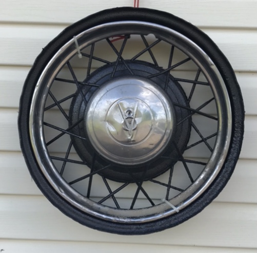

What’s wrong with the wire spoke hub cap wheels?
I always like wire spoke wheels.

Nothings wrong with them in reality, I very much like the look.. they're just not big enough lol. Real 100 spoke wheels with the knockoff hubs would be the way to go.. but I can't ever forsee myself being willing to spend that kinda money on wheels lol. I more or less have 1500$ into acquiring the car.. 17" wires are like 1800 bucks 😳

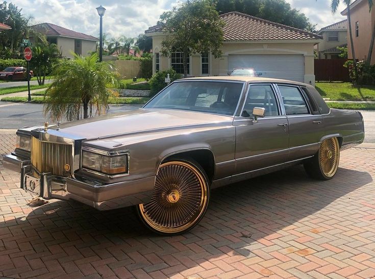

those wheels you are wanting to put on, the smoothie looking ones, are awesome looking.
I would recommend this look.
The donk look is an aquired taste that havnt quite aquired yet lol. The older I get the more I kinda do appreciate it though to be honest.

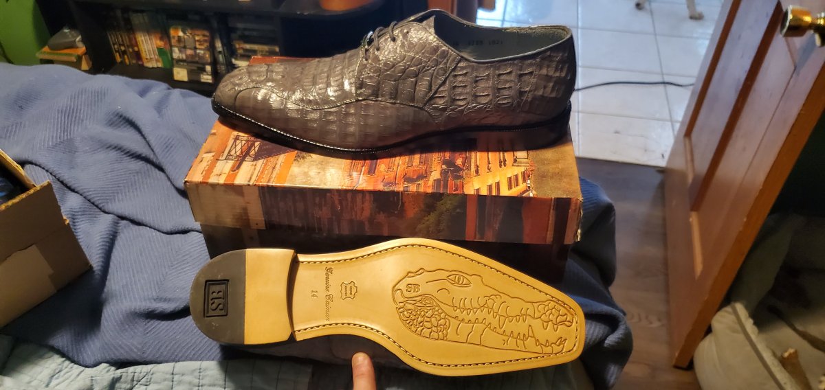

I DO have a pair of genuine gator shoes though so... mabey I'll have to turn them into driving shoes one day with the purchase of some bigass wheels 😋
