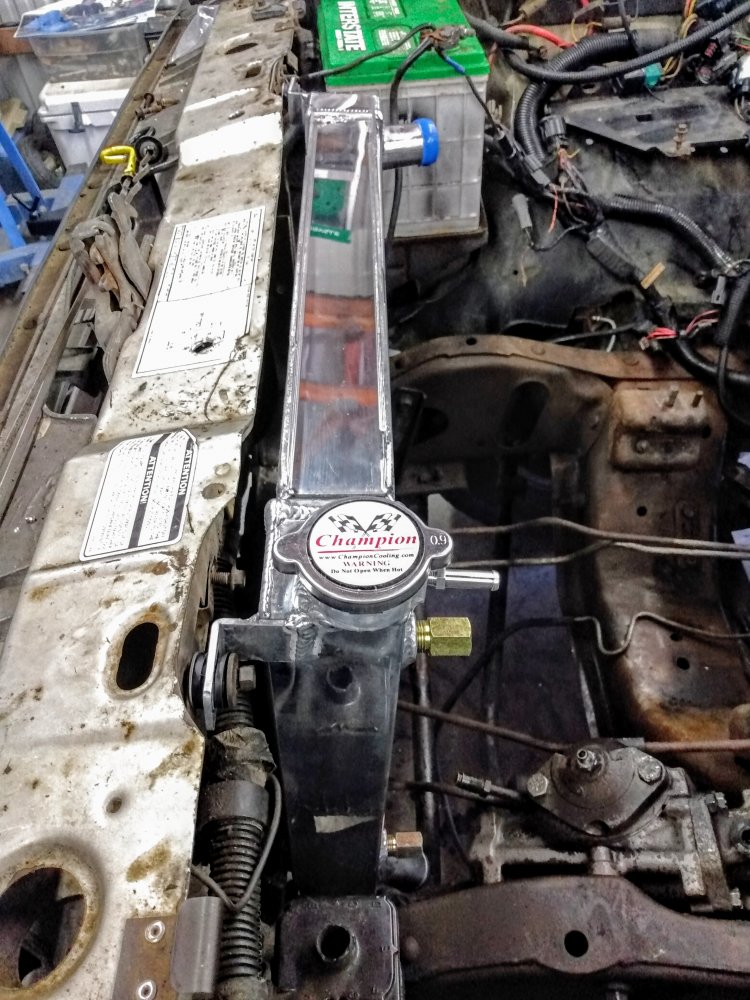

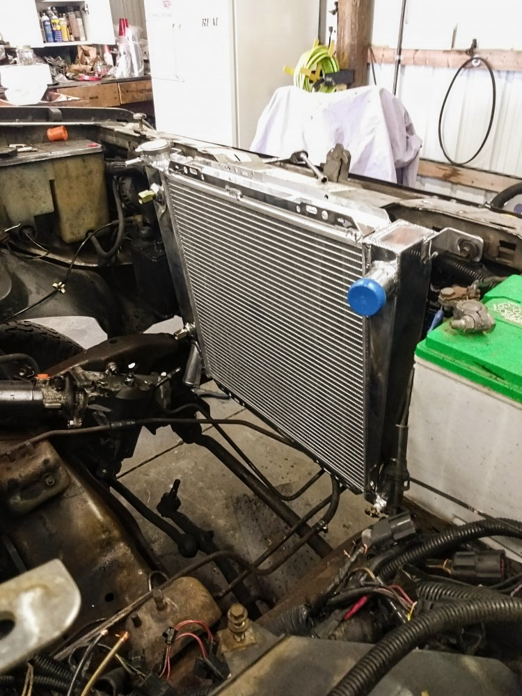

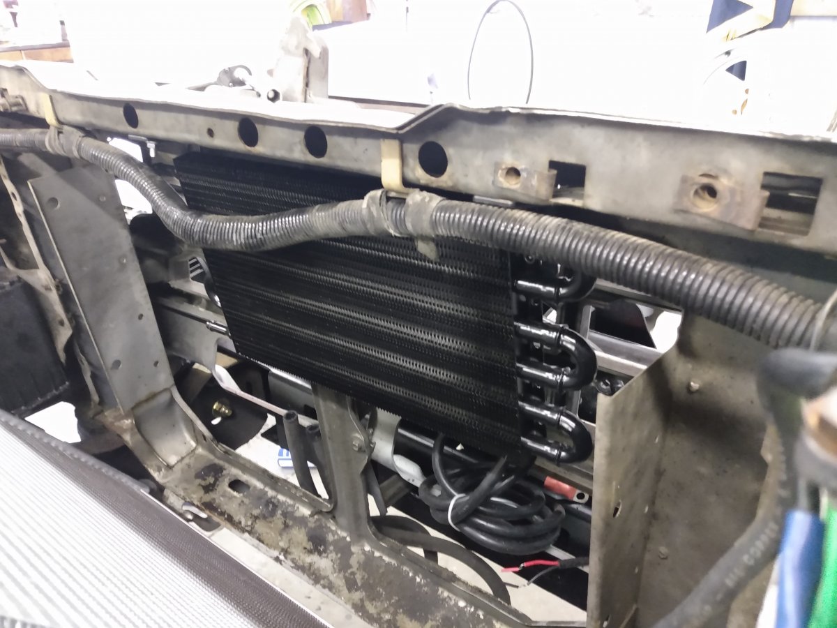

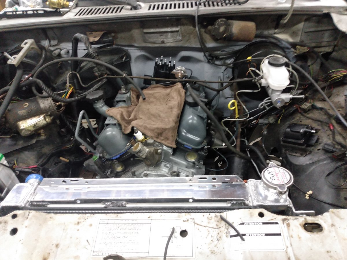

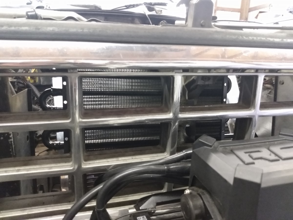

Feels nice to do a little mock up instead of tear down or normal repair/replace. Champion radiator, Evil Energy 6 tube trans cooler and some Classic Industries trans lines hopefully to come tomorrow and be one step to closer to setting the engine and trans back in.

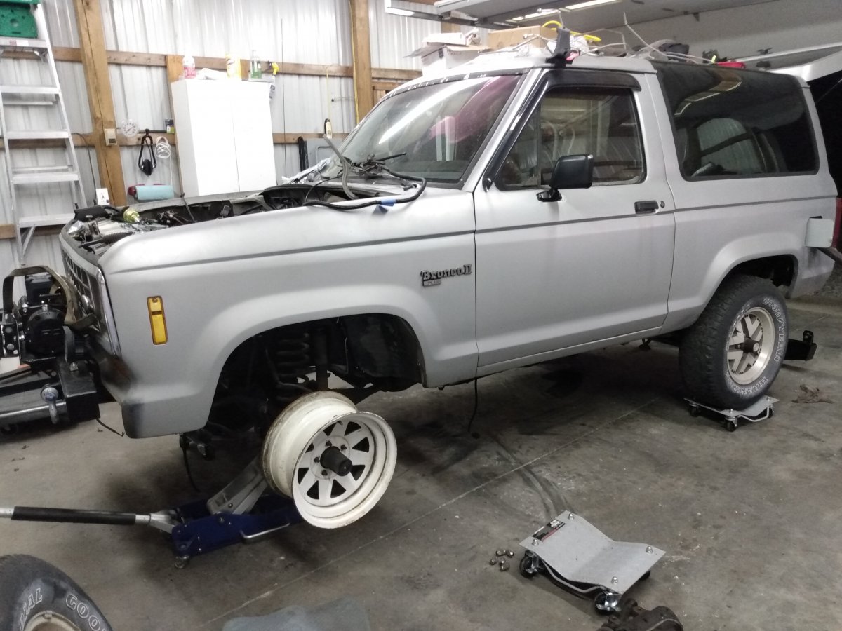

So if you decide to or need to replace engine mounts, start with the passenger. Just less aggravating. You'll need a flex head 3/8 with a shallow 18 and about 10 minutes. Driver side, extension and 18 swivel, 30 seconds and done. Figured I'd try a wheel while I had one off...
old school cool...
Man someone stumble across a 5th and life can't get better...
Those 8 inch? what is the backspace? I might do a bit of junk yard searching here real soon.

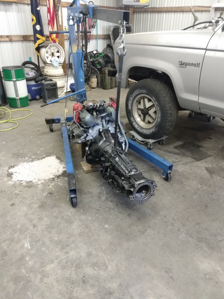

Well it took me taking vacation to get some free time but had some progress yesterday even with a slight hickup. Thankfully advanced auto actually did something right. Finished short block assembly with the wrong rear main tool I bought for no reason. T72 C-6165. Went to bolt the trans up found my flex plate was cracked. Advanced had one by 2 PM so l I lost like 2-3 hours of productivity. Installed. Got the engine and trans in and bolted down. Hoping for more progress today as it's back to the grind on Wednesday.

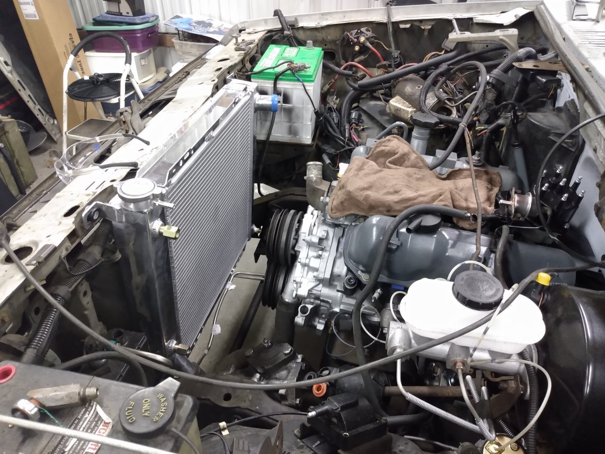

So didn't get the results I wanted out of 2 days of vacation but a decent amount of progress. Engine trans and tcase are in. Everything hooked up fluids filled. Truck won't crank. 7 volts at excitor wire on starter solenoid. Supply 12V to small terminal engine will crank. Harness that is in the truck is JUNK... Any suggestions on full replacement or best action?
I know @BlackBII snagged some NOS harnesses on ebay I believe.
I would probably just make a repair to the existing while searching out a better option.
Man literally at least 1 ear is broken off of every connector most both are. Terminals are melted and corroded or terminal clips are broken and they pull right out. I've repaired and diaged a LOT of harness and wire issues and this one is just gone. I may call a Ford buddy up see if he can get me the part number see what I can find there I would be stoked to find a NOS....
