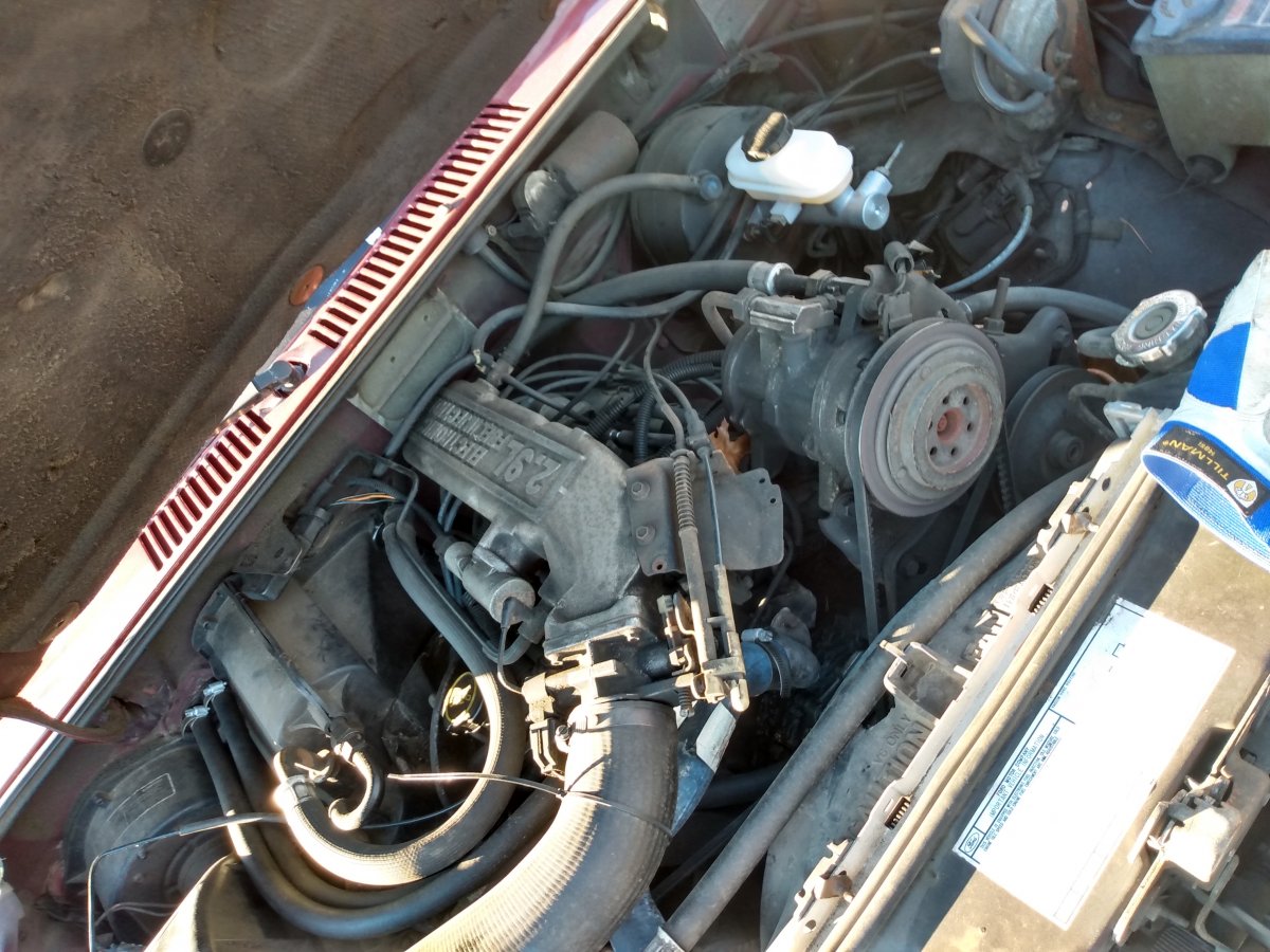

Well today was a good day. Early start off to Chesterfield Auto Parts, in 25 degree weather. As much as I hate tearing down vehicles that appear in good shape, once their that close to the crusher it's just time to get what you can, and I did!!! From the steering column to the headlights back to the trans and ECU(including the controller) for $68........ I was shocked. Picked up a few more odds and ends including a decent dash and cluster bezel, all included in the $68 sticker! Headed home to tear mine down again, but I have high hopes for this upgrade. Thank you little donor truck for your sacrifice 😂
So I have gotten the dash harness and engine harness swapped out from the donor. I did lose power window functions, guessing that was the one connector under the dash on the LH side. While doing the engine harness I noted the headlight harness I got was different as well and that's when I saw the harness from the dash was connected there and ran inside the fenders to the headlights, starter solenoid then to both doors.. I'll just have to get power and ground to those switches, or more preferably swap to manual windows.. shame my donor interior is tan... May have to see if someone will trade! On a good note the truck would then crank on its own with no influence of me jumping the solenoid 🤣. So I then found the next problem, none of the the 3 used batteries I had around had enough ass to crank it more than 15 seconds. So I was hoping to behind the modification stage once this little thing was back on its feet. But that doesn't seem to be the avenue it took. Went ahead got an Optima, group 35. Tuff Stuff 1 wire 140 amp and have ordered length of cable from batterycableusa.com. I will repost with part numbers etc once I get it all on there just wanted to make an appearance again! Also added a kill switch and had to redo my battery tray as it had more missing from rust than what was there.

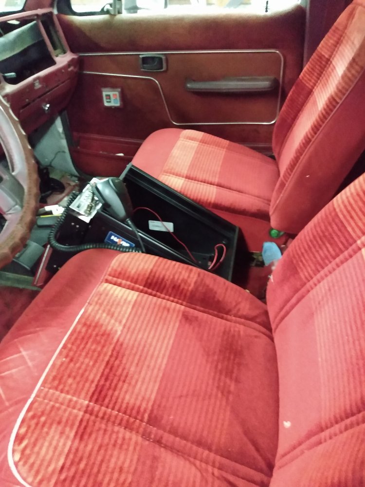

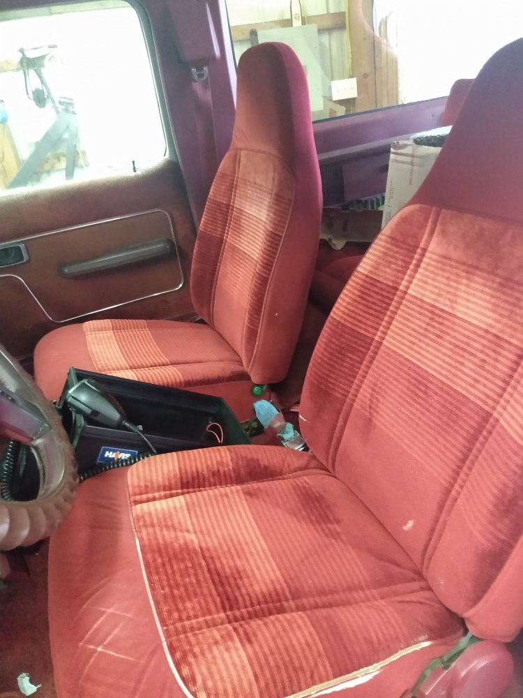

So just progressing the thread along. I posted some questions in help forums and got great information. My current situation is need to get connectors to wire up the fan as well as some ports to accept the factory coolant switch and my new fan control sensor. But we are making progress. In short, the engine will run and build good oil pressure. I have not run it in length due to the fan situation and needing to break the cam in. I hope to accomplish that in the week to come. I swapped interior seats to give room for the center console and as well hopefully a doubler setup. Most of the dash is back together and I need to supply power for the power window circuit as the dash harness I got form the donor had manual windows and the 12 pin ( I think) connector under the DS dash was not there. Should be pretty simple. Then a plethora of small to do's and an appointment to DMV are near I believe... I also got the entire shift plate and shifter setup out of the parts bronco I bought and bolted it in, fit like a glove. So lucky it had auto trans and manual tcase what a rare setup. Thanks for watching and the comments!

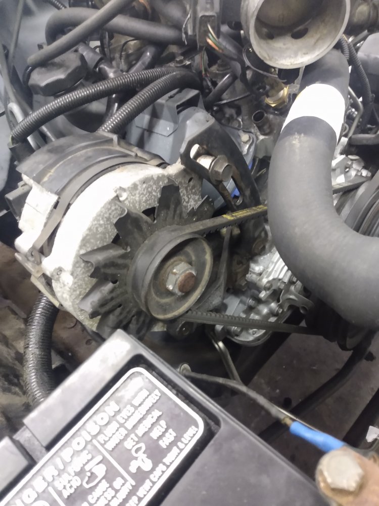

Fan is wired up under the hood, and now to make and run the power supply harness into the cabin. Waiting on a few components but plan to run wire this weekend. Slowly but surely plugging away to get this thing on the road!
Thanks @ecgreen I am trying to get things accomplished. Really pushing for it, when I made smoke the other day it lit a fire to get it on the road. Just trying to tightened up loose ends before I perform cam break in but the fan leads to the wiring in the cab for the key on power, which if I am running 1 wire in I may as well run everything I need, then I needed to pull the carpet up so I put the shifter in... you know how it goes!
