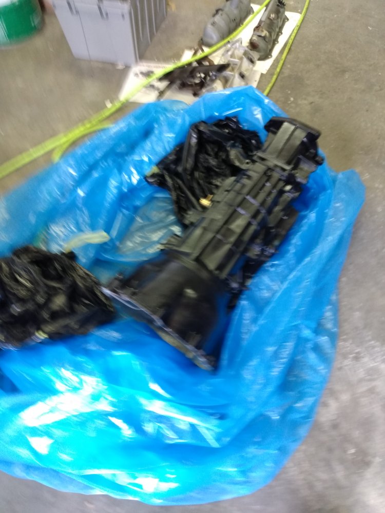

Only update as of the last few weeks, I got my trans back..

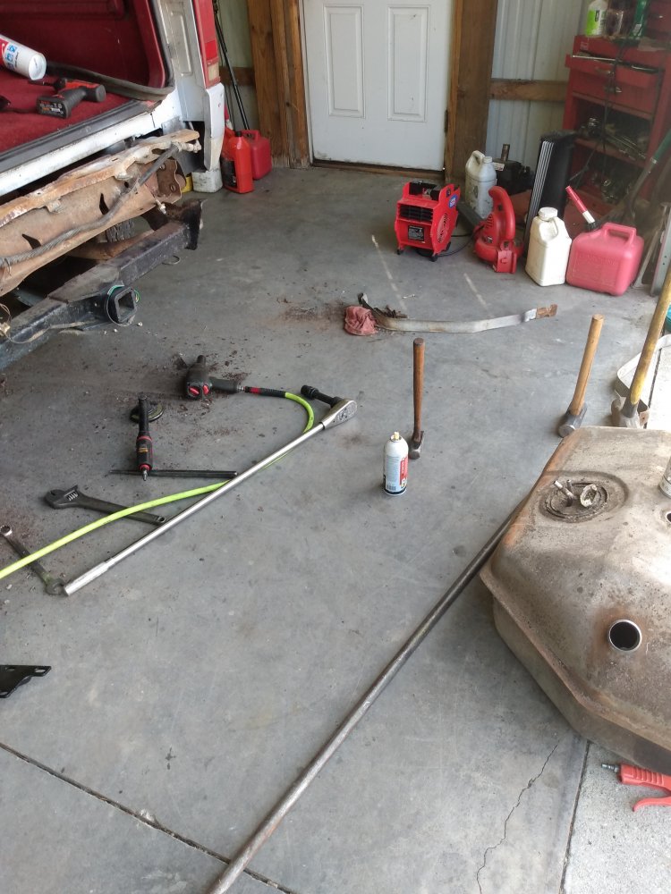

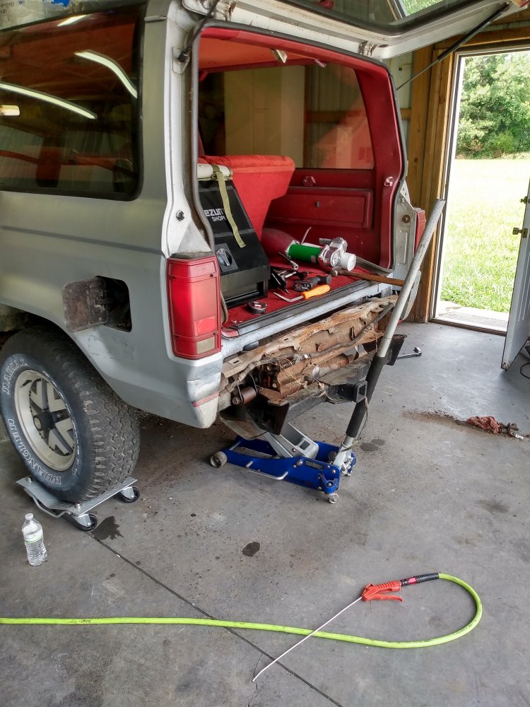

Current situation.. cussing, whoever put this hitch on has got to be one of the most half assed individuals to ever turn a wrench. That being said I feel regret in being to tight to not have gotten a torch yet. Glad I got that 3' 3/4 ratchet. Don't even bother undoing those 1/2" bolts just snap them off.

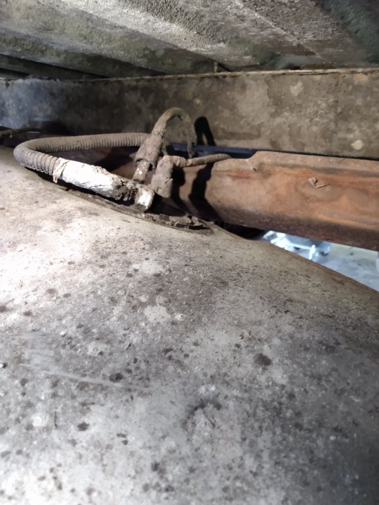

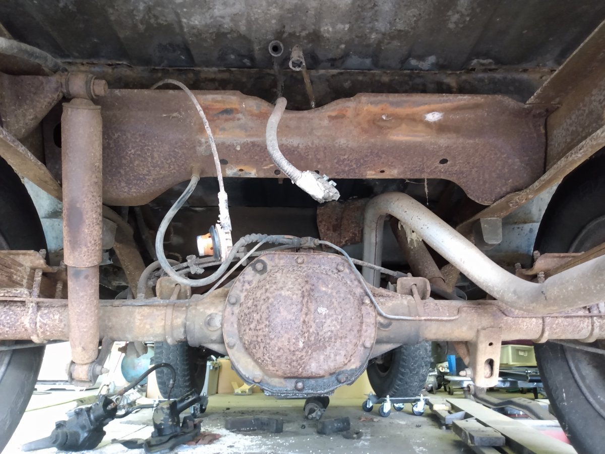

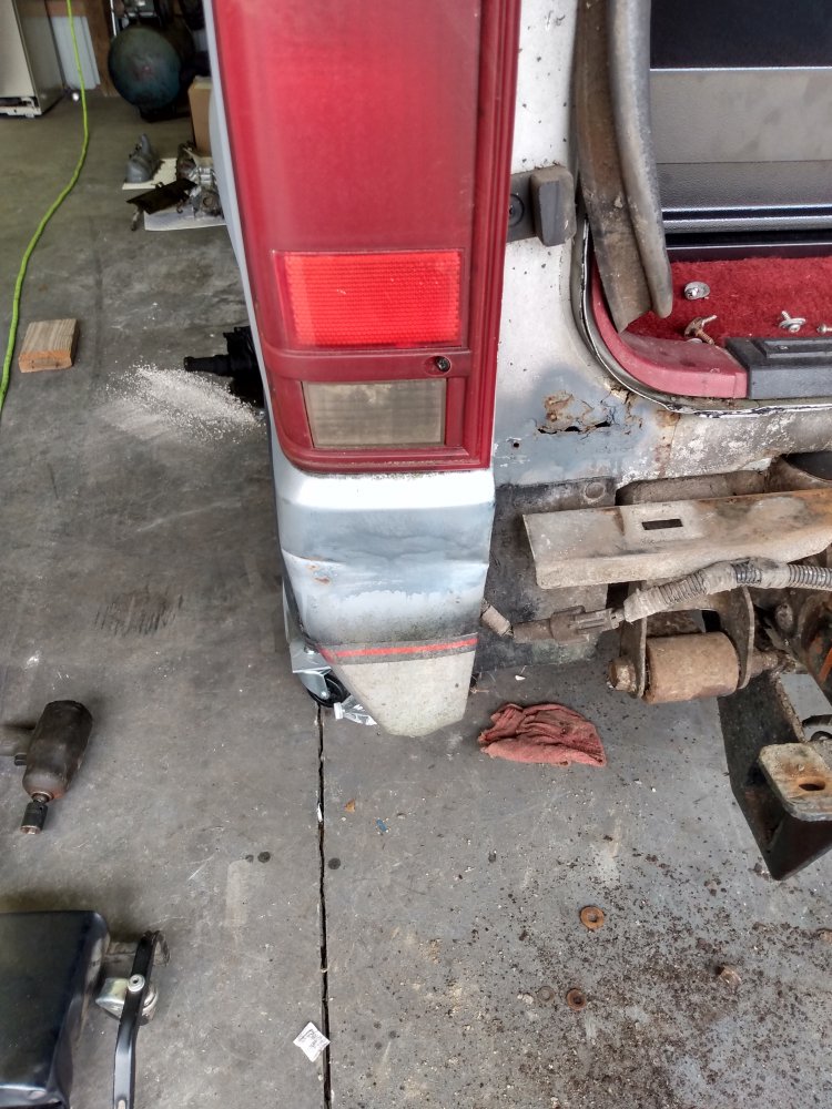

So not the amount of progress I wanted today but any time working on it is good. Got valve covers cleaned up and painted as well as timing cover cleaned and ready to install. Installed timing chain guides. Then was time to beat and bang. Got the old bumper off and dropped the fuel tank. Cleaned the fuel fill hose and clamp, installed new fuel pump/sending unit in new tank, replaced strap hardware and cleaned fuel lines out. Checked fuel reservoir and will replace o ring and reinstall now that I know there isn't a filter that goes in it... Pretty disappointed in my finding with the rear bumper removed. I know the truck had been repainted and one of my MAIN goals in looking for a truck while drivetrain and over all condition were at the top of the list I wanted an original paint with weathering. I thought I couldn't get luckier finding this one on my way home from work but wished it had been 2 tone and original. As I have removed both bumpers I find the truck was in fact originally silver and black 2 tone... What idiots to have sprayed over that.... Shame. Oh well cheers to the progress. On to another week with out of state meetings and no time in the schedule for the Bronco...
@ecgreen body has some rot decent hole in front of the passenger rear wheel but surprisingly everything hardware wise has come off fairly easily. Except that stupid hitch....

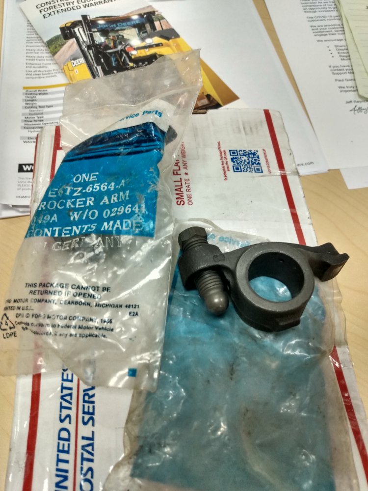

Pretty happy to have found these on Ebay for less than half the price of non OEM brands on Rockauto. I think it was $119 for the set shipped. Just received them and they're legit. Whole set new in the packages.

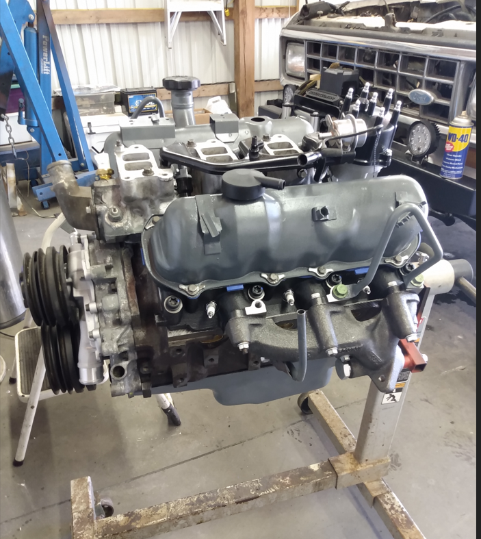

Sorry it has been so long since I have been on here, the truck is still here, the project still on going. I got held up drastically trying to get moved, house sold, closed etc... while all of that is still on going stuck out of town quite a bit with work. That being said I finally stuck some of the other (important life things) on the back burner this weekend and spent time with my neglected Bronco II. Engine is all but ready to go in, most of the brake lines have been replaced frame and engine bay got degreased and power washed. Also my girlfriend had been on the hunt for a project(still needed ac and all working) Bronco or Blazer as a weekend toy, I found a 1 owner 89 full-size fully loaded with 120K miles while going hiking one morning at day break for sale 20 minutes from my house. She lucked out and picked that up too!
Side note I have a few questions regarding timing and valve adjustment will try to find the correct forum to post those to specifically but will also add here in case anyone following the build can chime in! Thanks all!!
Question #1:
Timing, I set #1 to TDC and timed w/ indicator, then installed distributor and pointed button directly to #1 plug should be ok for base correct?
Question #2:
Valve adjustment, used the NOS valves I purchased and installed new pushrods. All adjustment nuts were slightly different from the package. I backed each off w/ the corresponding piston @ TDC compression until I had significant lash, then tightened until no lash was present then preset lifter 1 1/2 turns past no lash. To be redundant I wanted to verify they were all "close" and of course they were not.... Adjustment nut height off the cast rockers was anywhere from .300-480". Is this okay? Am I over thinking this? Not much experience w/ hydraulic lifers..

TDC and point the rotor to the number one spark plug on the cap. Correct... if you were at TDC on the compression stroke. If exhaust stoke... you will be 180 off.
Lifter adjustments... have been discussed at length here before. I have zero experience with it so I will leave the how to stuff to the folks that do. I will ask though... did you replace the push rods? Are they all the exact same length? Did you put your new rockers on a set of nice clean shafts?

On the rockers.. I did not buy new shafts like a tight a$$ I did not think anything of it until I was reassembling.. I did check for gouging and wear and saw minimal. I soaked mine and cleaned residue and build up out of them and oiled and make sure flow through oil passages. New rods, and rockers. Did not compare all rod lengths, hind sight... well you know what the saying is..

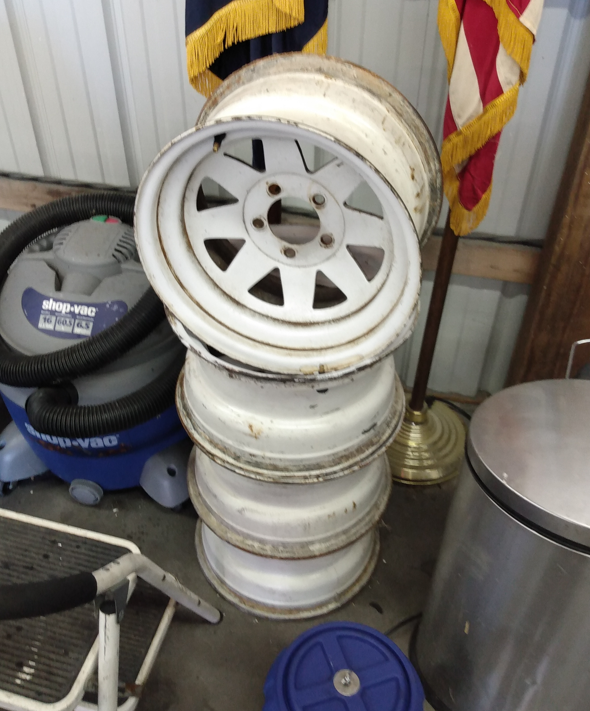

I bought one that was posted here in the classifieds. Lots of work had already been done. Enough that I kinda feel like I cheated myself from a bunch of rust in my eyes. It's on a truck headed here... can't wait.
Wow that is super clean. 6" Skyjacker and 33's? Are those Stone Crushers? Or old Eagle Alloys? Look like Stone Crushers
Congrats though!!!
I would have gone to that palm tree paradise and gotten it for you, although I may have never come back :)
That's exactly why I didn't ask you to go get for me!
Your guess is as good as mine with the wheels/tires... I didn't ask but now I probably will. Can't say I've ever seen them before.
They are one of the two aforementioned. Either are a cool wheel I believe ProComp offered a version as well. Could have been those. But forged wheels like all the cool kids get now a days just a normal size. They are clean though for sure. I would Ceramic coat them if you plan to keep.
They are... he said they were Eagle. They were bought in 2006... never driven down the road.
