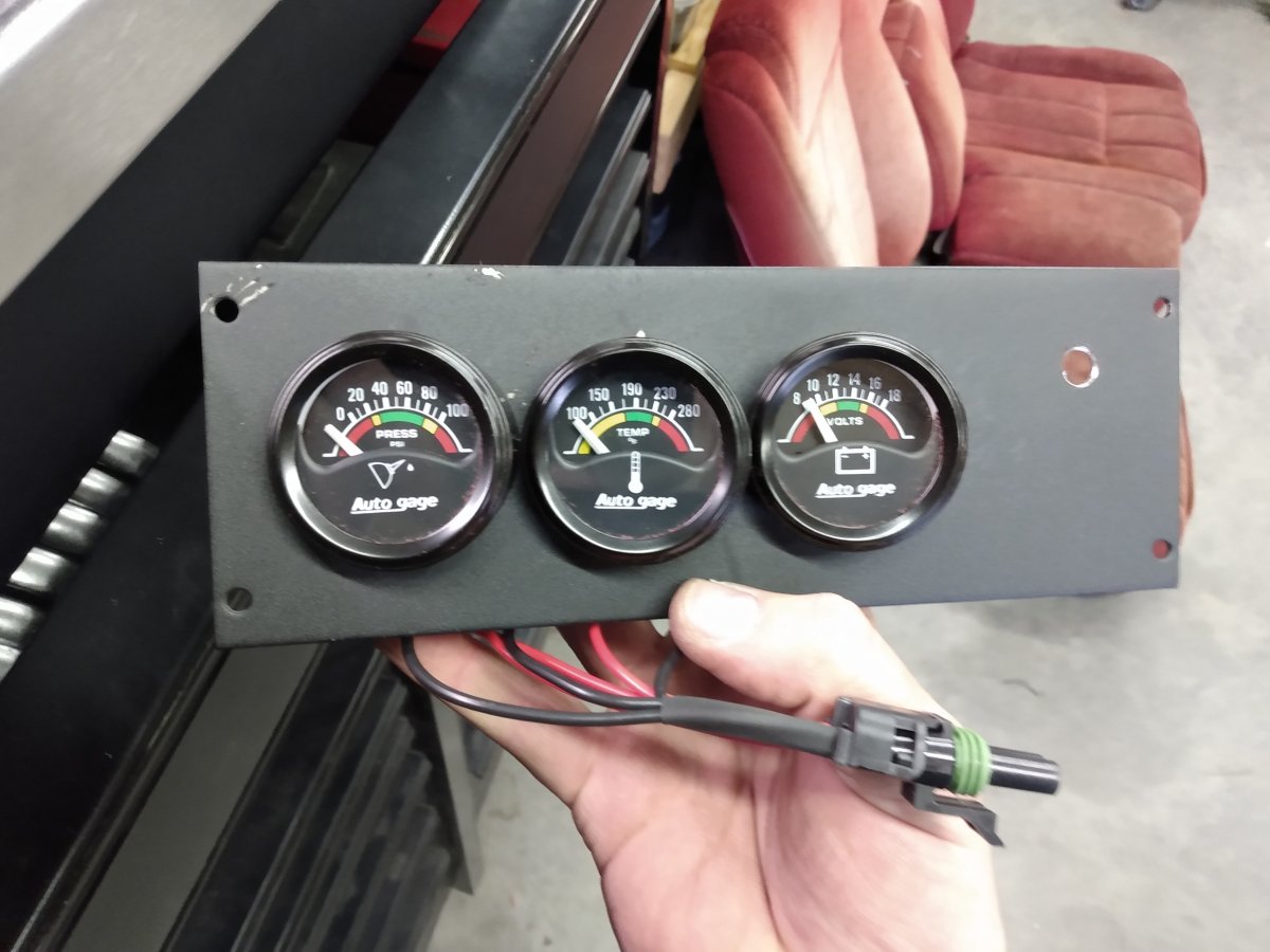

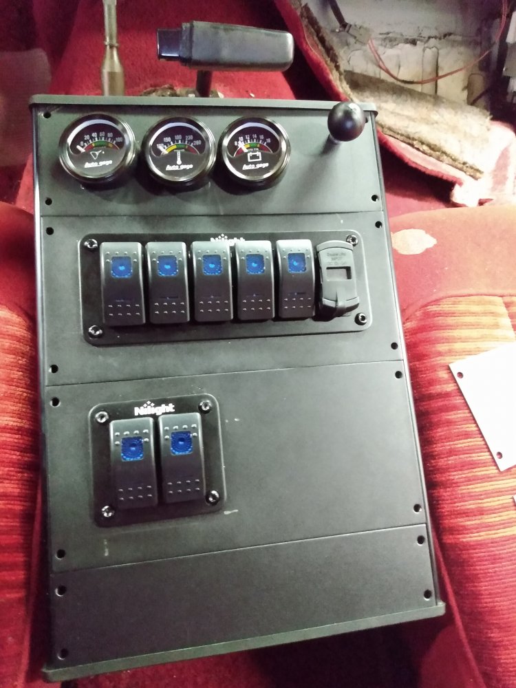

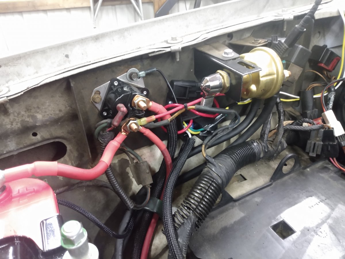

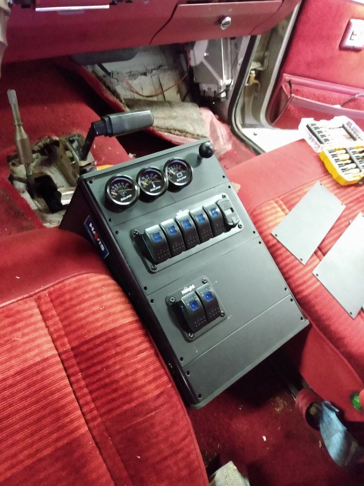

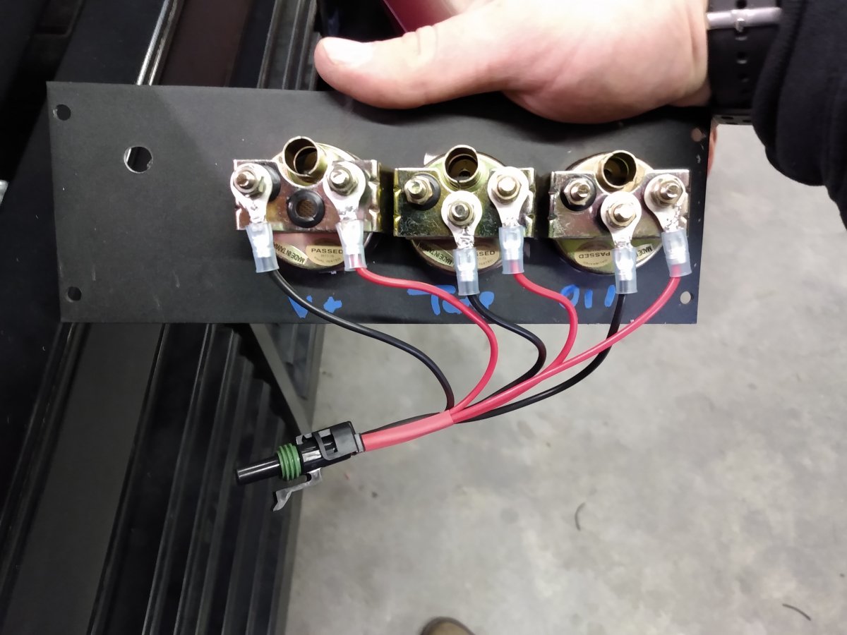

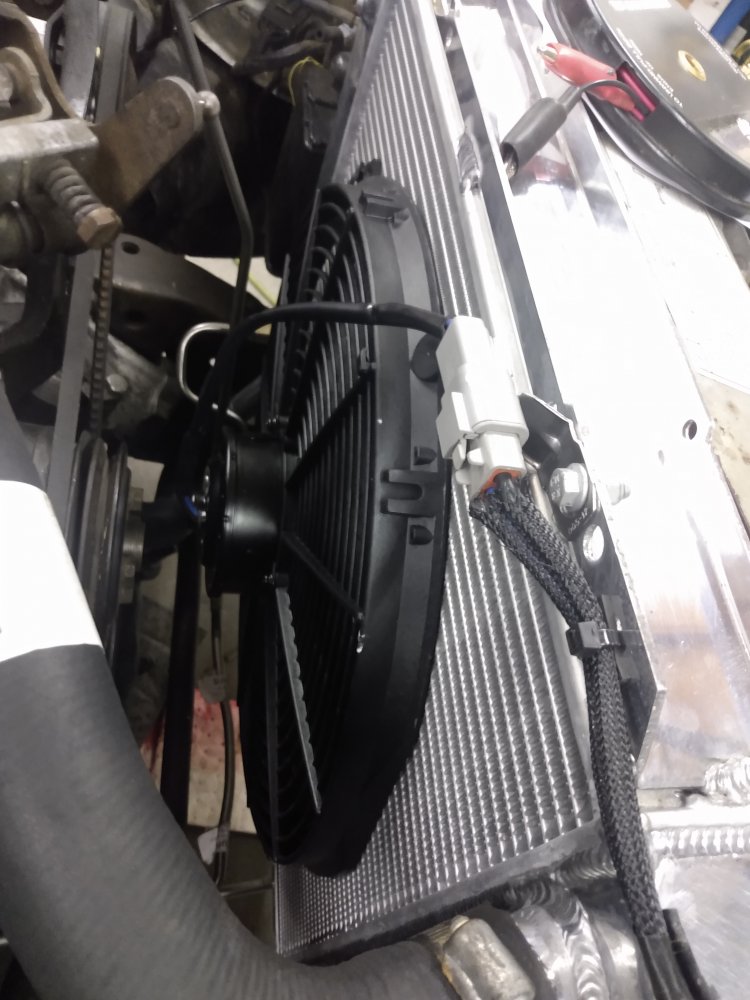

Waiting on a relay panel to get this finished but needed my gauges and power source for the fan so I can start running the engine. Mostly mock up and wiring the gauges yesterday. Need to figure out how to mount the console, will be digging in the scrap bin at work this week. Also ran main power supply (4 ga) and ground into the cabin to divert supply to different needs. This console will be a busy place but it will be nice to have everything accessible.
My Tuffy console directions suggest drilling holes in the floor and using nuts and bolts for installing. I'm opting for rivetnuts. My wife let me pick out my own Christmas presents this year... I was delighted to see Santa had brought me and new heavy duty rivnut gun and a bag or three of inserts.
My electrical will be far less then what you have going into your command console... I'm still wondering exactly how I will bring the my wire bundle into it. I'm thinking I will bring it in from the dash on top of the carpet for now... maybe go underneath when I install new vinyl flooring. I guess it will depend on how thick it is. What are your plans?
2 4 gauge wires brought in through rubber grommets in the firewall just below the heater box. Came in just to the right of the tunnel and ran under the carpet to the right of the shift console( I will get pics tonight). I am connecting the positive to a bus bar and negative to the fuse panel directly. I am adding a cooling fan in the console as well. The positive will get distributed to the fuse panel, relay panel, as well as the rear (10 ga +/-) for a pair of switches for rear lights, air compressor, and 12V supply ports. There will be a 30 Amp circuit breaker in the rear for the compressor the other components will be separately fused/controlled by relays. Up front I am planning, fog lights, fan override, roof lights (front), roof lights (side), interior lights, manual reverse lights, and possible spare. The rear will be interior lights and a spare switch unless I add reverse lights to that as well. Compressor will be on a heavy duty throw switch, with pressure switch in the circuit or possibly just a blow off valve.
The Rivnuts is a good idea. I may use those for fastening the console down, I like that idea. My goal is to be able to disconnect 2-4 wires from the console and remove it for any service need. Did not want the thing permanently forever fastened with 8000 wires going into it.. I will probably add the winch controller into it just to keep it neat.

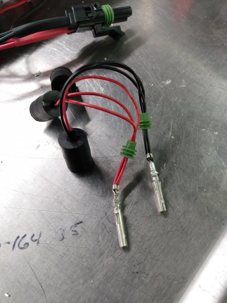

View attachment 70578 View attachment 70576
View attachment 70577 View attachment 70574
Your my hero...that is so freekin cool
Weather pac's... pass through grommet's... braided wire sleeve... heat shrink... etc... All of it says it isn't your first rodeo and it sure looks like you have a good plan.
I had never used the braided sleeve loom... I always used convoluted tubing. But I bought an assortment of sizes to use on my project. A little weird when I first started but didn't take much to get the hang of working with it. I pre built my gauge harness using it...
